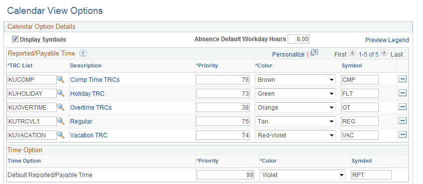

Use the Calendar View Options page (TL_WV_OPTIONS) to define viewing options for calendars.
Navigation:
This example illustrates the fields and controls on the Calendar View Options page (1 of 2). You can find definitions for the fields and controls later on this page.
This example illustrates the fields and controls on the Calendar View Options page (2 of 2). You can find definitions for the fields and controls later on this page.

Maximum Time Reporters Shown |
Define the maximum number of time reporters to display on screen. Note: The maximum number of time reporters shown cannot exceed fifteen. |
Absence Default Workday Hours |
Define the number of hours to display for a requested or approved absence when:
The system displays this number if one or more of the reasons above are valid. The system displays half the number of the defined hours if the requested/approved absence is for a half day. |
Reported/Payable Time
Field or Control |
Description |
TRC List |
Designate which TRCs will be displayed on the time calendar pages. TRC value lists are set up in Time and Labor and designated a unique ID. Click View List to see a list of the TRCs in the selected list. Note: A TRC can be included in more than one TRC List. If a TRC appears in two or more TRC lists, the list with the higher priority will display on the calendar. View the TRC lists before setting priority codes to avoid possible duplication of TRCs and minimize potential confusion while viewing calendar pages. TRC values are defined in the Time and Labor setup tables. Important! A maximum of five TRC lists can be specified. The system will not allow you to save the page with more than five TRC lists designated. |
Priority |
Enter a number from 1 to 99 in this field. Priority definitions enable the system to decide which information is the most important to show. The priorities assigned to the TRCs and time event options determine which color to display when more than one type of time related data is in effect for the same period. The color with the highest priority will be used to represent all of the time for the particular period. All assigned priorities need to be unique. |
Color |
The Calendar View Options page enables you to associate colors with TRCs and time events, such as holidays. Use the drop-down menu to view the list of sixteen color choices. This design provides easier viewing of the calendar pages. The colors and associated elements will appear on the legend at the bottom of each calendar page. |
Symbol |
Define symbols to designate different TRCs and time events. Use up to three characters for each symbol. If Display Symbols is selected, these symbols appear on the calendar along with the hours to show different types of reported time and are explained through the legend on the calendar viewing pages. |
View List |
Click to view the TRCs contained in the selected TRC list. |
Default Reported/Payable Time |
Designate the priority, color and symbol (if used) to either the payable time reported by a time reporter or the time that is defaulted from the schedule. |

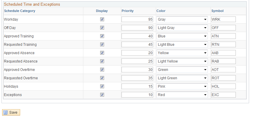

Scheduled Time and Exceptions
In addition to TRCs and default reported time, select other time-related items for calendar viewing. For example, if requested overtime and exceptions are important, you can prioritize them so that they display on the calendar pages, when present.
Select the priority, color, and symbol that the system is to apply to the following types of calendar display options.
Field or Control |
Description |
Workday |
A workday is any regularly scheduled day for which time events should be reported. When Show Schedules is selected on the Time Calendar pages, Workday and Off Day will be displayed. |
Off Day |
Days designated as non-workdays. Off days do not include requested/approved absences or holidays. |
Approved Training and Requested Training |
Time or days which have been either requested or approved for training. One option is to set the requested hours at a slightly lower priority than the approved hours. This option would allow the color associated to Requested Training to appear in the grid on the Calendar pages for that specific time. If approved, the color would change to what is associated with Approved Training. Note: This option requires implementation of the Human Resources Administer Training business process or PeopleSoft Learning Management. |
Approved Absence and Requested Absence |
Time or days which have been requested or approved for absence. One option is to set the requested hours at a slightly lower priority than the approved hours. This option would allow the color associated to Requested Absence to appear in the grid on the Calendar pages for that specific time. If approved, the color would change to what is associated with Approved Absence. Note: This option requires implementation of Global Payroll or Absence Management. |
Approved Overtime and Requested Overtime |
Time or days which have been requested or approved for overtime. One option is to set the requested hours at a slightly lower priority than the approved hours. This option would allow the color associated to Requested Overtime to appear in the grid on the Calendar pages for that specific time. If approved, the color would change to what is associated with Approved Overtime. |
Holiday |
Days defined as holidays by the company or organization. |
Exceptions |
If employee time produces exceptions during the Time Administration process, this option will create a link on the calendar page to the Exceptions Information page for more detailed information about the exception. |

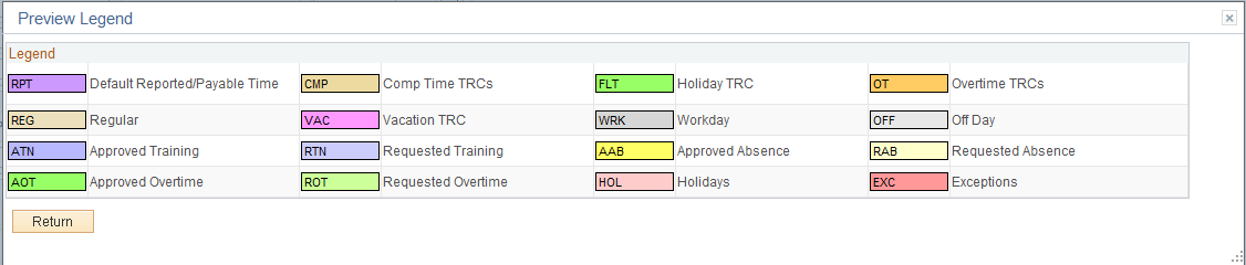

Use the Preview Legend page (TL_WV_LEGEND_SEC) to view a sample of the legend that will appear at the bottom of the calendar viewing pages as defined by the current selected colors and symbols.
Navigation:
Click Preview Legend on the Calendar View Options page.
This example illustrates the fields and controls on the Preview Legend page. You can find definitions for the fields and controls later on this page.
This page enables you to monitor the viewing option building process to assure the final design provides the necessary information in a readable format. You can see what symbols and colors have been designated for the various time events to be shown on the calendar. As you build your customized calendar views, check the legend periodically to review the symbols currently designated.
