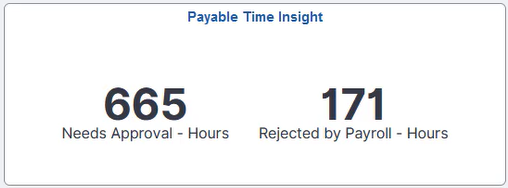

The administrators or managers can use the Payable Time Insight tile to access the Payable Time Insight dashboard using PeopleSoft Insights for Time and Labor.
The Payable Time Insight tile displays the amount of payable time requiring approval and rejected by payroll in hours.
Users can view other statuses inside the dashboard. The reason for only showing theses two statuses upfront is because these are the ones that most urgently need an administrator's attention.
Customers can modify the visualization to change or add other statuses to this tile.
This example illustrates the Payable Time Insight tile.

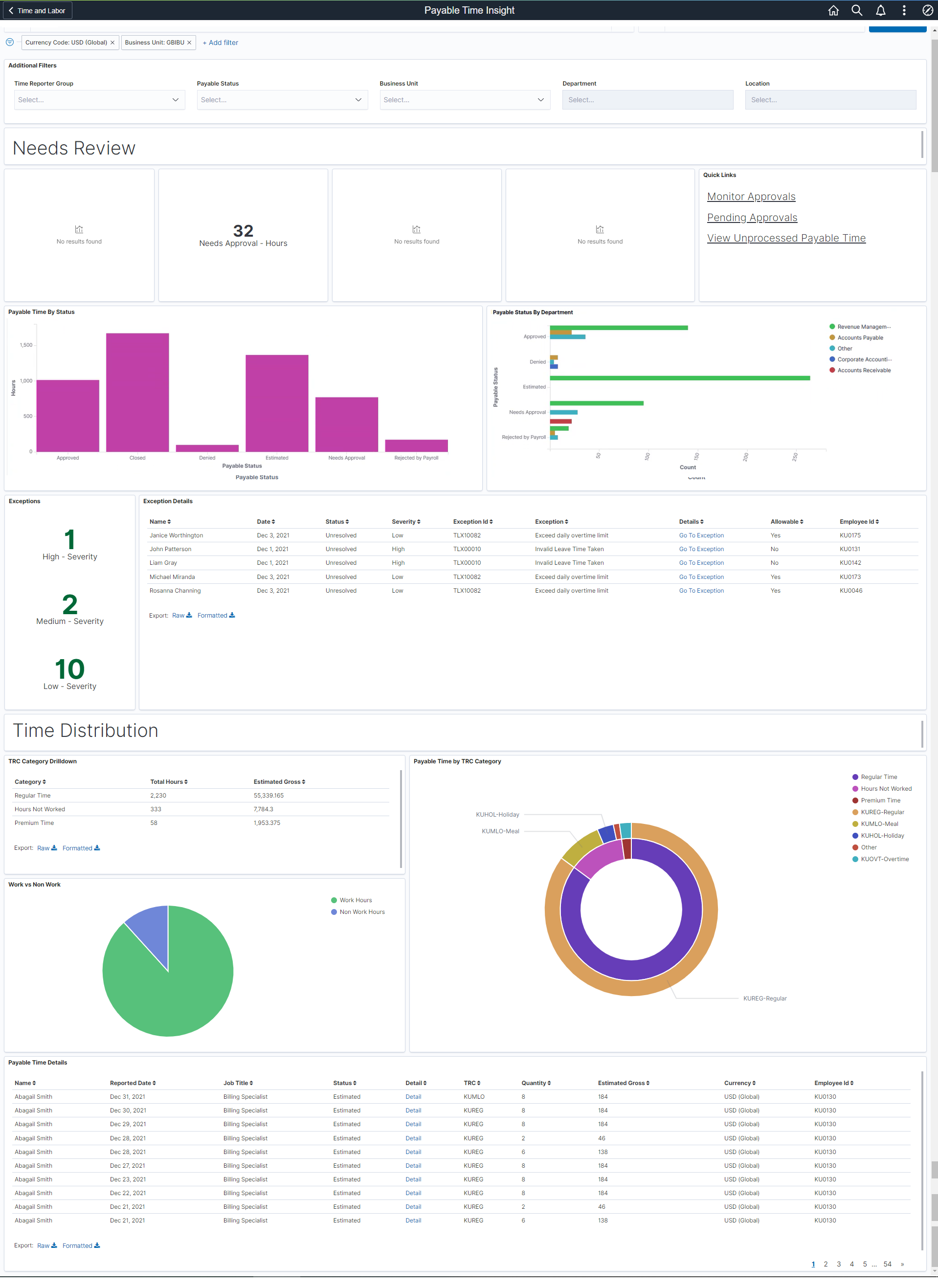

The Time administrators and managers can use the Payable Time Insight dashboard to view several interactive visualizations based on the time reporting time data specified for a date range for the group of employees specified by the filters.
The visualizations are used in the following ways:
Identify the departments that generate the most overtime on average per person.
Identify Payable Time statuses which may indicate a problem.
Calculate the number of hours to be paid by TRC Category.
Identify any exceptions that is block the processing of approvals.
View the overtime trend.
Calculate the payable shift hours.
Identify the total of all overtime worked.
This example illustrates the fields and controls on the Payable Time Insight dashboard. You can find definitions for the fields and controls later on this page.
The visualizations are presented in different visual representations to best present data. There are different types of analytics which include:

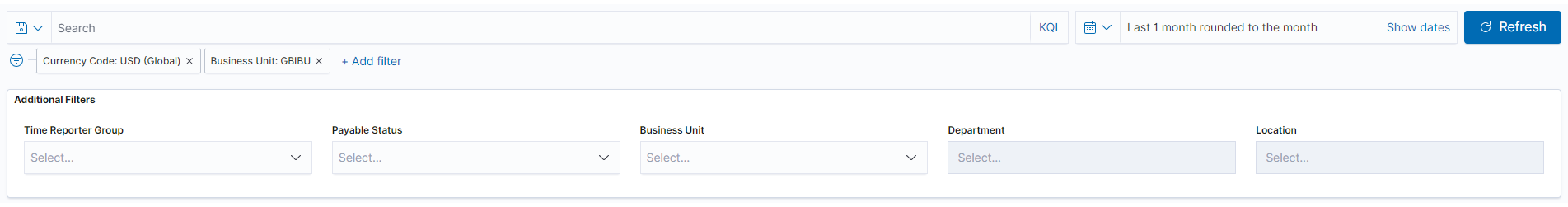

Additional Filters
With any visualization, you can pause over an item to view the percentage or number counts, as desired.
Filtering options apply to all visualizations, which allows administrators to drill down on all the charts at once.
This example illustrates the fields and controls on the Additional Filters. You can find definitions for the fields and controls later on this page.
Additional Filters allows you select filters in the areas:
Time Reporter Group
Payable Status
Business Unit
Department
Location

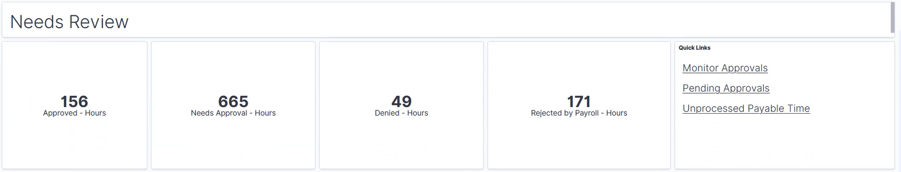

Needs Review
Use the Needs Review visualization to view the Payable Time statuses which may require review.
This example illustrates the fields and controls on the Needs Review visualizations.
The Quick Links visualizations show approvals status and unprocessed payable time contains links to other pages which might be useful when reviewing the various Payable Time statuses.
Note: Quick Links show top 10 statuses in this visualization in alphabetical order. You can edit visualization and filter to include only specific statuses.

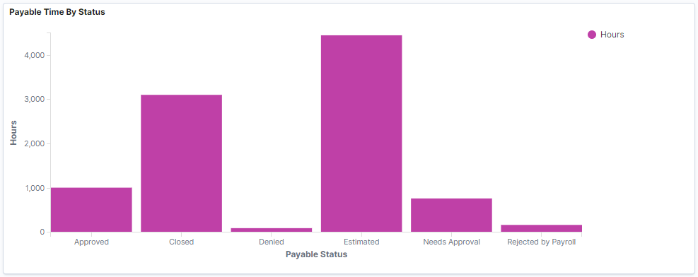

Payable Time By Status Visualization
Use the Payable Time By Status visualization to view all of the payable time statuses.
This example illustrates the fields and controls on the Payable Time By Status.
This bar chart displays the status such as approved, closed, denied, estimated, needs approval and rejected by payroll. This include all statuses that have time associated with them.

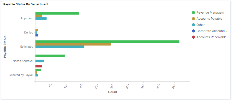

Payable Status By Department
Use the Payable Statuses By Department visualization to view status by department.
This example illustrates the fields and controls on the Payable Status By Department visualization
The legends represent the different departments in different colour.The corresponding counts are displayed for respective payable Time status.

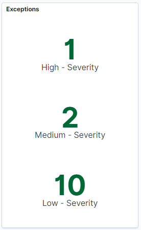

Exceptions
Use the Exceptions visualization to view the analytics for severity of high, medium and low.
This example illustrates the fields and controls on the Exceptions.
Select to see the Exception details.

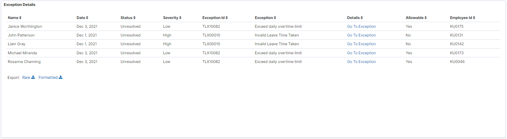

Exception Details
Use Exception Details to view details of the exceptions or to export the data in the format which is needed.
The exception index HC_TL_GBL_PAYABLETIME_EXCPTN is used for getting exceptions data.
This example illustrates the fields and controls on the Exception Details.
Note: The exception details show only the unresolved exceptions for which the source is Time Administration.
Select the Go to Exception hyperlink to access the Manage Exceptions page.

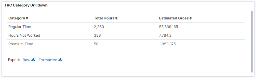

TRC Category Drilldown
Use the TRC Category Drilldown to view time distribution where multiple TRCs are grouped by TRC category. The categories are based on the TRC Categories that your organization has set up.
This example illustrates the fields and controls on the TRC Category Drilldown.
Note: The TRC Categories are pulled in from the TRC Category set-up.
The inner ring contains the TRC Category while the outer ring contains the Time Reporting Codes (TRCs).

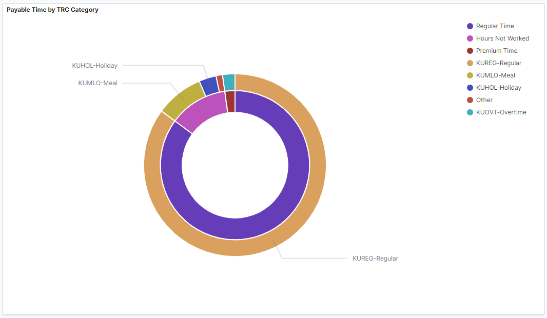

Payable Time by TRC Category
Use Payable Time by TRC Category double doughnut visualizations to view the payable time distributed over TRC category.
This example illustrates the fields and controls on the Payable Time by TRC Category.

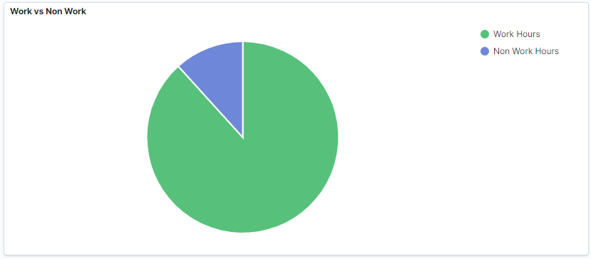

Work vs Non Work
Use the Work vs Non Work visualization to view the distribution of work and non-work hours.
This example illustrates the fields and controls on the Work vs Non Work visualization. You can find definitions for the fields and controls later on this page.
Note: You can configure the items to be displayed in the visualizations for Work vs Non Work. Use the WRKTRC and NONWRKTRC Value lists to categorize TRCs. For more details, refer to Creating Value Lists.

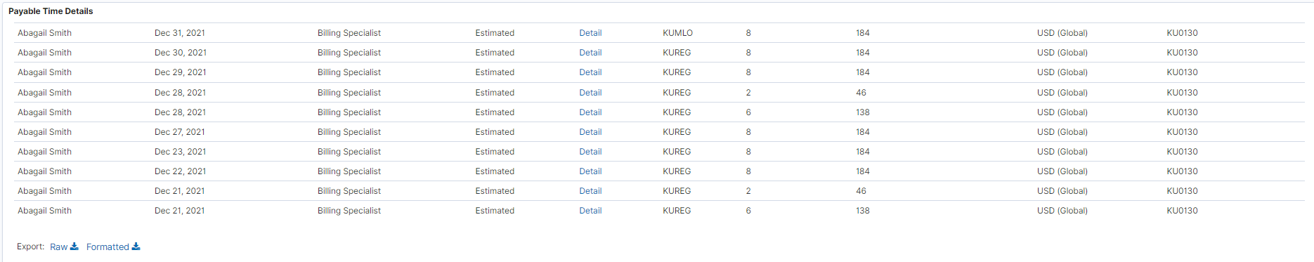

Payable Time Details
Use Payable Time Details to view the details and the data on the visualizations.
This example illustrates the fields and controls on the Payable Time Details.
Selecting the Detail link takes you to Payable Time page from where you can manage the view settings.

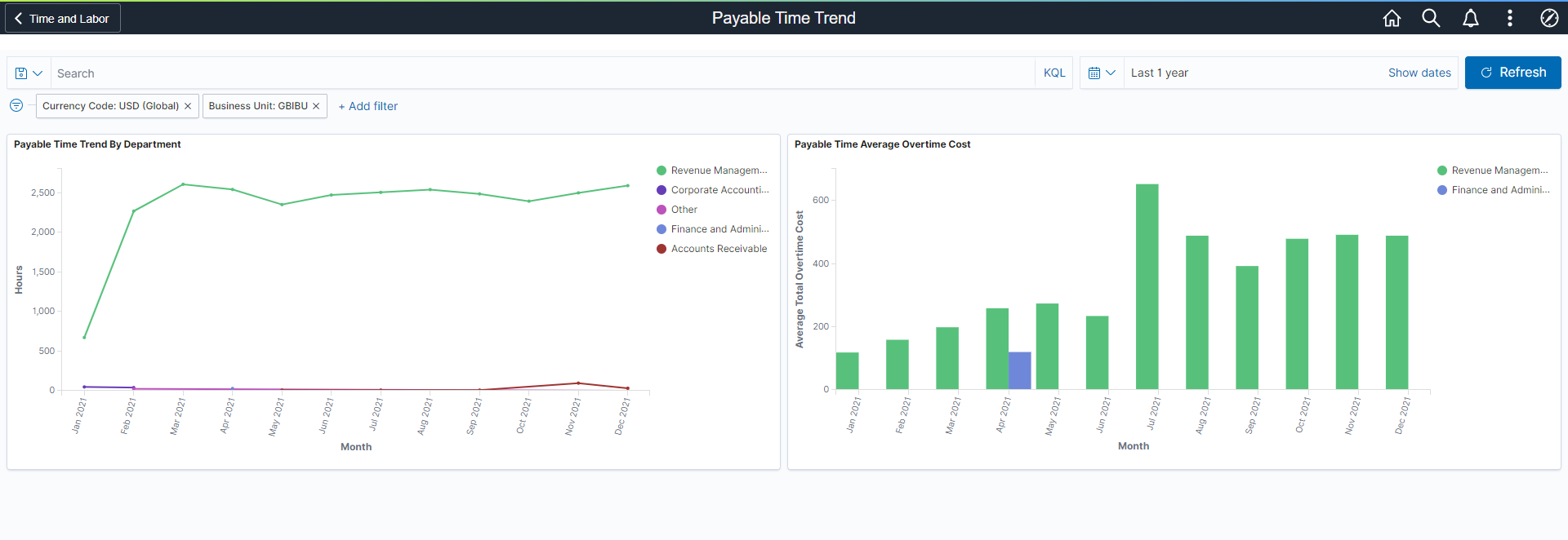

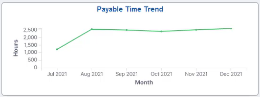

Use the Payable Time Trend tile to access Payable Time Trend Dashboard.
The tile displays the hours per month trend of payable time.
This example illustrates the Payable Time Trend Tile.
The Payable Time trend visualization displays a rolling period. It shows the past six months trend from the current months context.
Use the Payable Time Trend and to view the payable time and overtime trends Dashboard and overtime trends by department.
Identify the departments that generate the most payable time average overtime cost.
This example illustrates the fields and controls on the Payable Time Trend Dashboard.

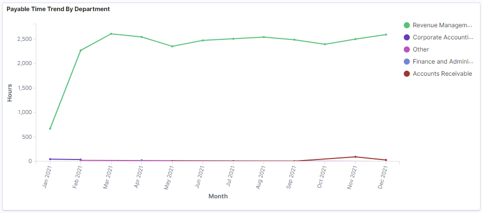

Payable Time Trend By Department
Use Payable Time Trend By Department visualization to view the payable time trend in hours with the respective departments.
This example illustrates the fields and controls on the Payable Time Trend By department.
Payable Time Average Overtime Cost
Use Payable Time Average Overtime Cost visualization to view the payable time trend of overtime cost.
This example illustrates the fields and controls on the Payable Time Average Overtime Cost.
The Payable Time Average Overtime Cost visualization is for a rolling period. It shows the past twelve months average overtime cost from the current months' context by department.
