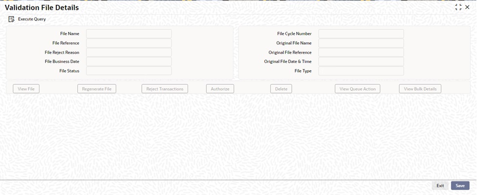

7.2.1 View Validation File
This action will open Validation File Details screen, which provides the CVF/DVF file details received for the dispatch file. The File level network rejects are displayed in this screen.
You can invoke this screen by clicking the ‘View Validation File’ action button in the Dispatch File Browser screen (PMSDSPBR)
For the selected record, you can view the following details, that are displayed:
l File Name
l File Reference
l File Reject Reason
l File Business Date
l File Status
l File Cycle Number
l Original File Name
l Original File Reference
l Original File Date & Time
Following actions can be performed from this screen:
Actions
Functions
View File
User can view the entire XML CVF/DVF file received.
Regenerate File
1.This is applicable if the Network status is rejected or partially accepted.
2.For a partially accepted file only transactions which are rejected only will be re-generated.
3. A new file reference is generated for the new file which will be populated as re-generated file reference, for the original file record.
4.The original file record will be marked as re-generated and no fur­ther actions is possible on this record.
5.The re-generated file will create a new record and the CVF/DVF file received against the new file will be linked to this record.
6. System throws an Override message on re-generating the file.Once the user accepts the override, action is saved.
7. Regeneration action requires, authorization and Queue access rights.
