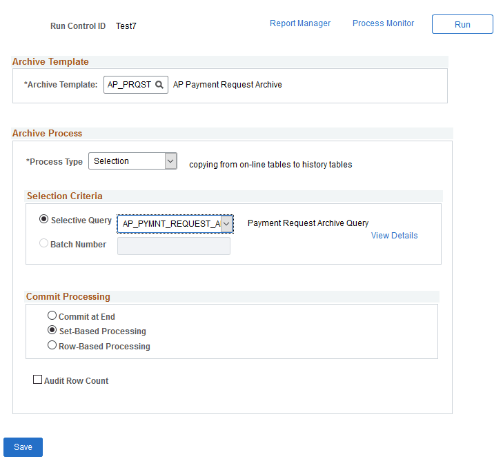

Access the Archive Data To History page (select PeopleTools > Data Archive Manager > Archive Data to History).
This example illustrates the fields and controls on the Archive Data To History page
Field or Control
Description
Archive Template
Select the archive template to use for this batch job. Choosing a restore or an archive template is the way you choose the type of job to run.
Run
Click to run this batch job after defining the archive process and commit processing.
Report Manager
Click this to view reports.
For more information about viewing reports, see Viewing Reports
Process Monitor
Click this to review the status of scheduled or running processes.
For more information about viewing the status of processes, see Viewing the Status of Processes
Archive Process
Use this section to manage the processes that are associated with the selected archive template. As the archiving process runs, counters are inserted into work tables to indicate which records have been processed (for both set-based and row-based operations) and the number of rows processed (for row-based operations only).
For commits by table, the database server commits only after each record is processed. If the process fails in the middle of processing a record (say, the database logs were full), it will perform a rollback of everything that has not committed.
For commits by row, if the process fails for any reason, the counters keep track of only those rows that have been committed to the database. When the Application Engine job is restarted, it skips all the rows that have been committed, and begins with the first uncommitted row.

Process Type
Select an option:
  • Select Delete to delete data from transaction tables. Data rows will be deleted from the transaction tables only if they've already been archived in the history tables.
  • Select Rollback to copy data from history tables back to transaction tables.
    Important! History rows have the same keys as their corresponding transaction rows, so attempting to copy them to the transaction tables will fail with a duplicate key error if the transaction rows still exist. Before running a rollback process for a given archive job, you must first run a delete process to delete the transaction rows for the same job, so that the history rows can be successfully copied into the transaction tables.
  • Select Remove from History to delete data from the history tables.
Selective Query
Specify the archive or restore query defined within the archive template to use at run time. If there are bind variables, you will be prompted to enter the bind variables when you select the Define Binds link.
View Details
Select this link to access the Archive Run Control Details page to view the SQL and row counts of this batch job.
You see this link when you pick a relevant Selective Query.
Note: If you're using bind variables, you must save the run control data before selecting the View Details link.
See Viewing Details.
Define Binds
Select this link to access the Define Query Bind Variables page.
You see this link when the query contains binds.
See Defining Archive Query Binds.
Batch Number
For archiving processes that are based on data in the history tables (such as delete data from transactional tables, copy data from history tables to transactional tables, and delete data from history tables), you will be prompted to enter or search for an Archive Batch Number.
Audit Row Count
Select to audit the number of rows in the record that meet the criteria. This number is displayed in the Number of Rows field on the Audit Archiving page.
Commit Processing
By default, batch processing is performed by the Data Archive Manager using set-based processing. Unless specified using the check boxes below, a commit is issued to the database after each table is processed within the Archive Template.
Field or Control
Description
Commit at End
Data Archive Manager processes data using set-based processing, but doesn't issue any commits to the database server until the entire process has completed.
For example, if your Archive Template is defined with Pre- and Post-AE programs, the Data Archive Manager will first run the Pre-AE program, then it will process all of the tables in the Archive Template, then it will run the Post-AE program. Upon successful completion of all these steps, a commit will be issued to the database.
When you select this option, the set-based processing option is automatically selected as well.
Commit by Table
Data is processed by passing a single SQL statement per record to be archived to the database server. A commit is issued to the database server after successful completion of each SQL statement.
Commit by Row
Data Archive Manager processes data one row at a time using PeopleCode fetches. This method of archiving is more memory intensive and takes longer than set-based processing. However, for archiving processes that contain significant amounts of data, row-based processing could be used to reduce adverse affects on the database server.
Row-based processing is appropriate when you're archiving large amounts of data from transactional tables and wish to issue commits more frequently. If you select this option, you must enter a commit frequency.
Commit Frequency
Specify the number of rows to process before issuing a commit to the database.
