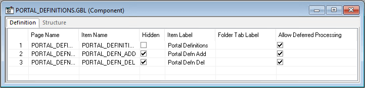

The component definition window has two tabs, Definition and Structure, that provide different views of a component.
Definition Tab
The default component definition view displays the page items and corresponding attributes of a component definition. You double-click the page name to open the page definition:
This example illustrates the fields and controls on the Component definition view. You can find definitions for the fields and controls later on this page.

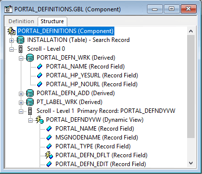

Structure Tab
The structure view shows records and scrolls in a tree representation. It provides information about page levels and component records and their roles. You double-click the objects in this view to open their definitions:
This example illustrates the fields and controls on the Component structure view. You can find definitions for the fields and controls later on this page.
To view the PeopleCode that is attached to any of the components, right-click and select the View PeopleCode option from the pop-up menu. The PeopleCode Editor opens directly in the workspace, displaying the related PeopleCode.
Note: The Structure tab only displays the runtime state of the PeopleCode. That is, it only displays record field PeopleCode. For example, PeopleCode programs that are orphaned as a result of a page definition change do not appear in the Structure tab. On the other hand, these orphaned PeopleCode programs do appear in the PeopleCode Editor, which displays the design-time view of PeopleCode.

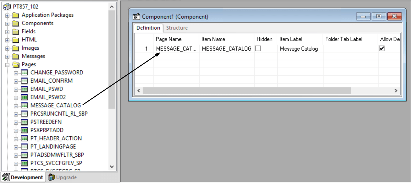

Dragging a Page Into a Component
To drag a page into a component:
  1. Open the project and component.
  2. Drag pages from the project workspace to the component.
This is an example of dragging a page into a component definition:
This example illustrates the fields and controls on the Dragging from the project workspace to a component. You can find definitions for the fields and controls later on this page.

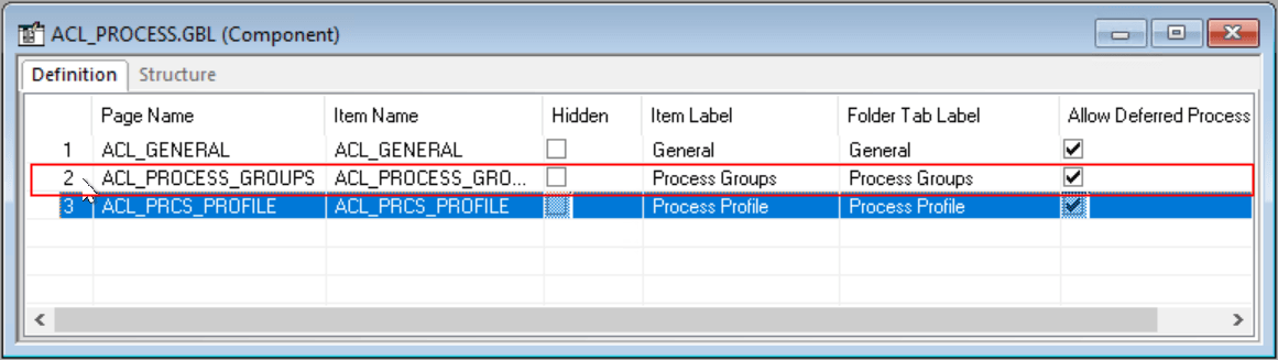

After you add pages to a component, you can change the order in which they appear in the component.
This example illustrates the fields and controls on the Moving a page in a component. You can find definitions for the fields and controls later on this page.
To reorder a page in a component:
  1. Select a row number on the left-hand side of the component definition.
  2. Drag the row to the correct position.
    The page is inserted immediately below the highlighted line.

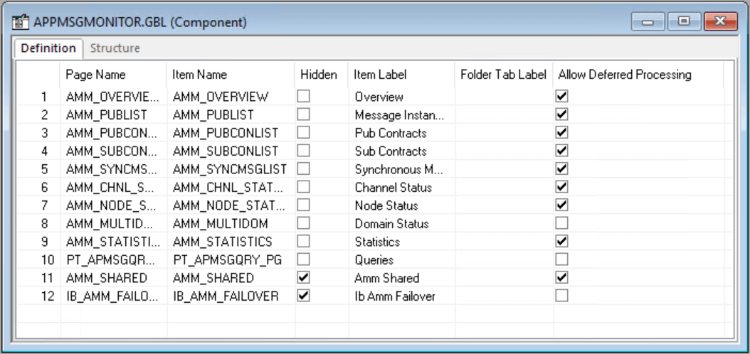

Each page in a component has attributes. Each attribute is represented by a column in the component definition:
This example illustrates the fields and controls on the Component item label and tab label. You can find definitions for the fields and controls later on this page.

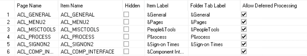

Setting Access Keys
You can set access keys by placing an ampersand (&) in the text of each item label. Put the ampersand in front of the letter that you want to be underlined on the folder tab at runtime:
This example illustrates the fields and controls on the Item labels with ampersands. You can find definitions for the fields and controls later on this page.
At runtime, a user can navigate between pages by pressing the Alt key plus the letter that is underlined, followed by the Enter key.
This example illustrates the fields and controls on the Underlined access keys on tabs. You can find definitions for the fields and controls later on this page.
