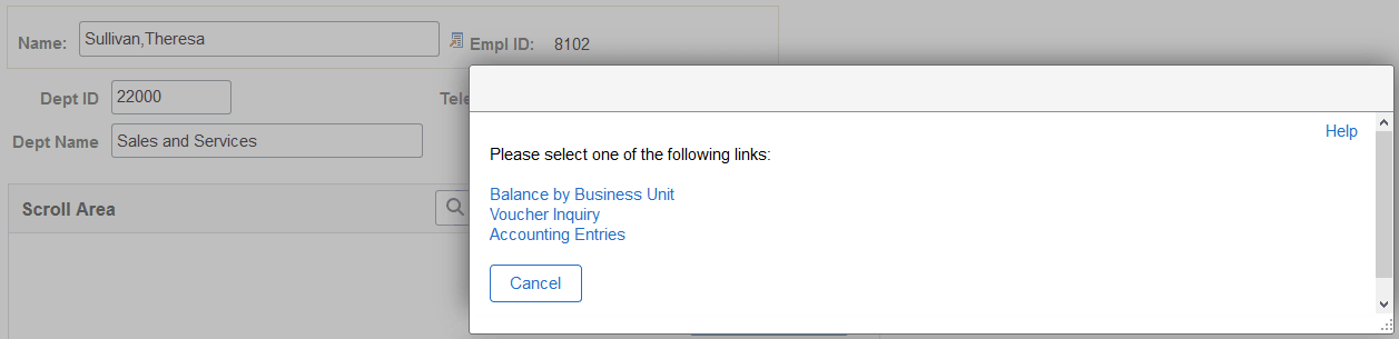

Pop-up Links at Runtime
This example illustrates pop-up links next to the View Other Links button.
These standard icons appear on the page at runtime when a pop-up menu is associated with a page field:
Term |
Definition |
Click the View Other Links button to open a modal window where you can select from among the links listed. Note: This icon appears if the pop-up links consist of more than one item. |
Click this button, labeled with the name of the single link, to execute the action of the link directly. Note: This icon appears if the pop-up links consist of only one item. |
