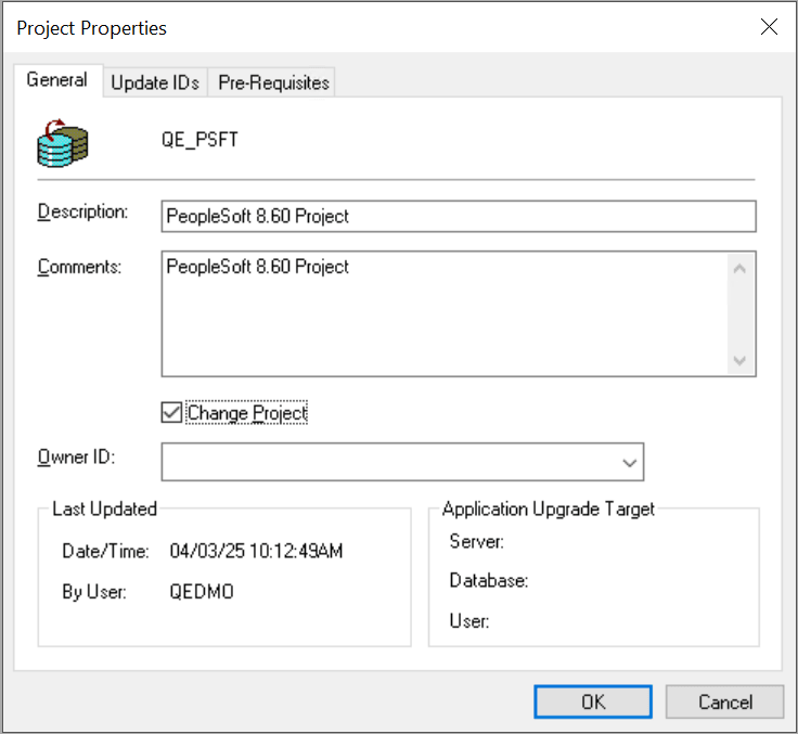

Use the Project Properties dialog box to enter information about a project. Access Project Properties from the File menu.
This example illustrates the fields and controls on the Project Properties dialog box. You can find definitions for the fields and controls later on this page.
On the General tab, enter a description of the project and any additional comments you might want others to be aware of when using the project. Select the Change Project check box only if you are creating a change project to be used with the Change Packager. Selecting this option enables the Update IDs and the Pre-Requisites tabs, which also are used only with the Change Packager.
See Understanding Change Packages.
Select the appropriate Owner ID for the project. The Owner ID allows for a way to identify which definitions are owned by which PeopleSoft applications, such as PeopleSoft General Ledger, Accounts Receivables, and so on. The values in the drop-down list box are translate table values associated with the OBJECTOWNERID field.
