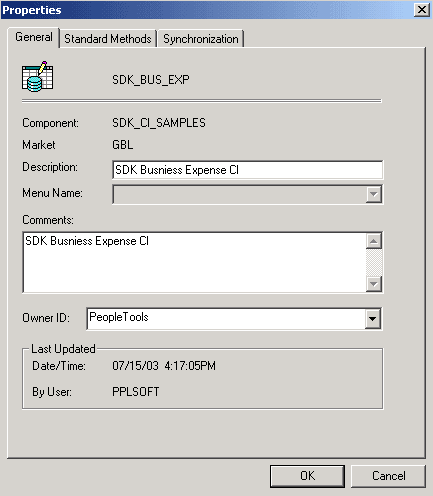

Use the Properties – General tab to associate a component interface with a menu.
Properties - General tab
To associate a component interface with a menu:
  1. Select File > Open from the PeopleSoft Application Designer menu to open an existing component interface.
  2. Select File > Definition Properties from the PeopleSoft Application Designer menu.
    The Definition Properties dialog box appears.
  3. Select the appropriate menu name on the General tab for this component interface.
    Note: Associate a menu with a component interface only when PeopleCode is in the component that uses the %Menu system variable.

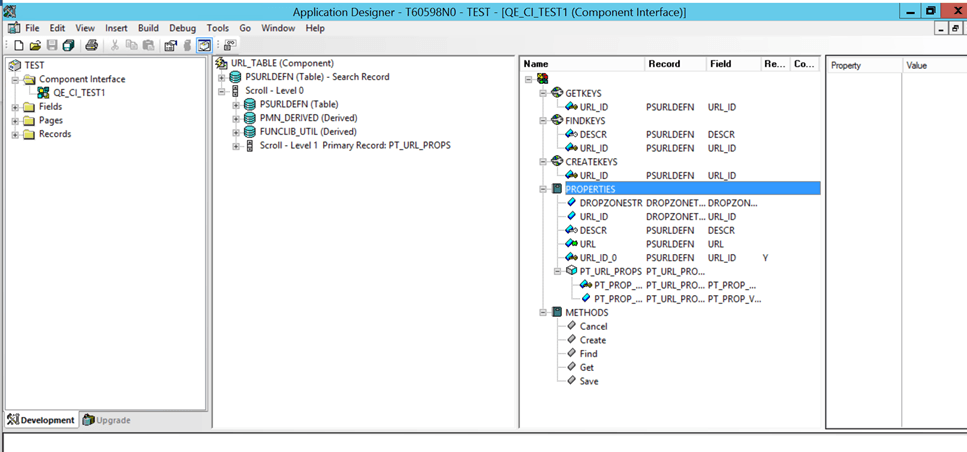

Component Interfaces support configurable drop zones.
Configurable drop zones allow you to add custom fields that are displayed and processed on delivered pages without customizing the component or page definition.
At design time, while creating a Component Interface, the availability of drop zone will be evaluated for the component. If drop zone configuration is detected, then the records and fields from the custom subpages gets added to the component interface properties list. These records and fields will be inserted at exact scroll level as the other existing properties.
This example illustrates a component interface with properties from drop zone custom subpages.
Similar to other component interface properties, the records and fields from the custom subpages can be retrieved to be modified or deleted directly, or through component interface collections.
Note that subpages within a drop zone subpage are not supported. Similarly, secondary pages within a drop zone subpage are not supported.
All the limitations of Component Interfaces are applicable for Drop Zones support.
