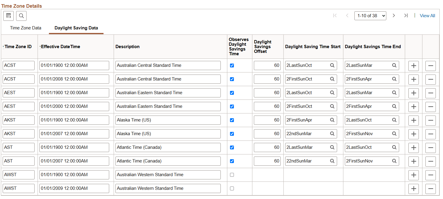

Daylight Saving Data Tab
Select the Daylight Saving Data tab to view daylight saving offset information and the IDs specified for daylight saving time start and daylight saving time end.
Note: When a timezone discontinues observing DST, special handling is required. This statement will audit for issues related to this type of change.
select count(*),timezone from (select distinct timezone,observedst from pstimezonedefn) group by timezone having count(*) > 1;
Any rows that are returned have both Y and N defined, which can cause issues when generating query offsets.
In this case, all rows OBSERVEDST should be Y, and timezones which have discontinued DST should have a DSTOFFSET of 0, and should have TIMEZONEDST label matching TIMEZONESTD label.
This example illustrates the fields and controls on the Time Zone IDs page: Daylight Saving Data tab. You can find definitions for the fields and controls later on this page.

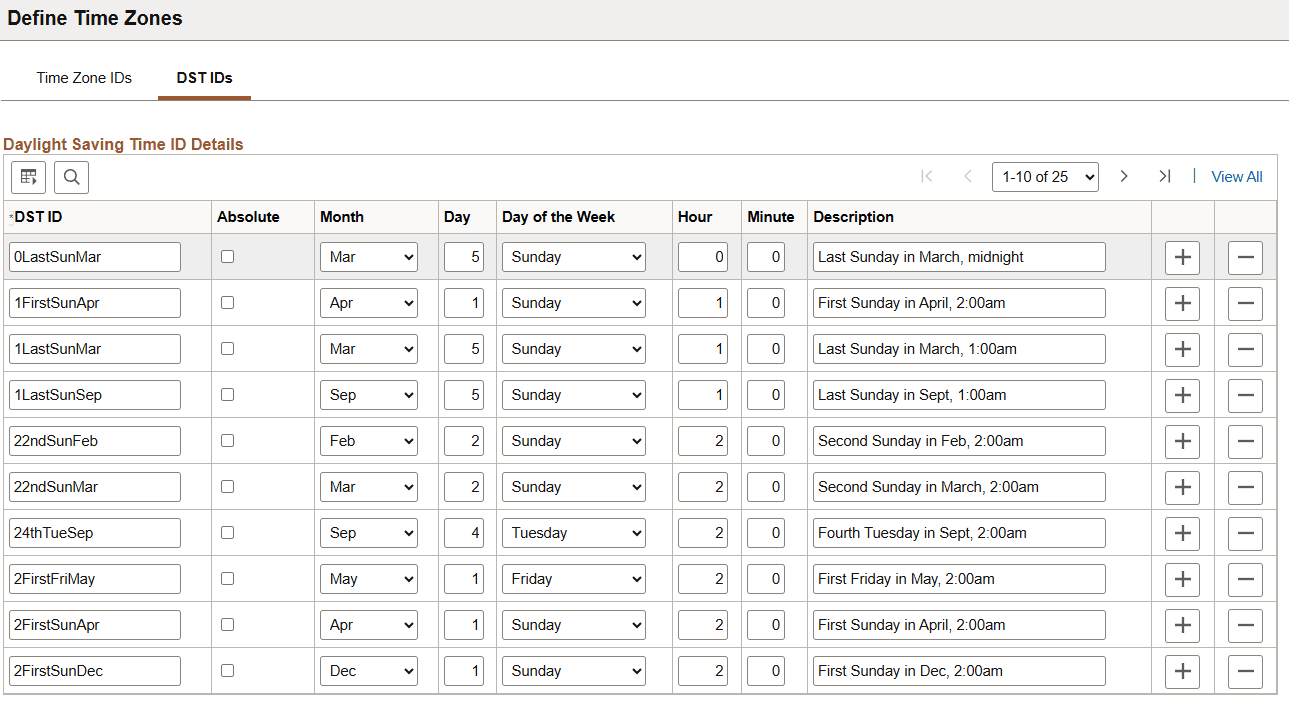

Access the DST IDs page (PeopleTools > Utilities > International > Define Time Zones > DST IDs).
This example illustrates the fields and controls on the DST IDs page. You can find definitions for the fields and controls later on this page.
DST IDs page
Field or Control
Description
DST ID
Displays a unique identifier for the combination of date and daylight saving start time. For example, 22ndSunFeb represents the second Sunday in February at 2:00 am.
Absolute
Clear this check box to indicate a relative date, such as the last Sunday in October.
Month
Displays the month.
Day
For absolute dates, displays the day of the month.
For relative dates, the numbers 1, 2, 3, and 4 represent the first, second, third, and fourth occurrence of the day of the week—for example, to describe the second Sunday in February, enter 2.
Use the number 5 for a relative date to indicate the last occurrence of the specified day of the week, even if that day of the week occurs only four times in the month.
Hour
Displays the hour at which the time switch occurs.
Minute
Displays the minute at which the time switch occurs.
Description
Provides a description of the DST ID.

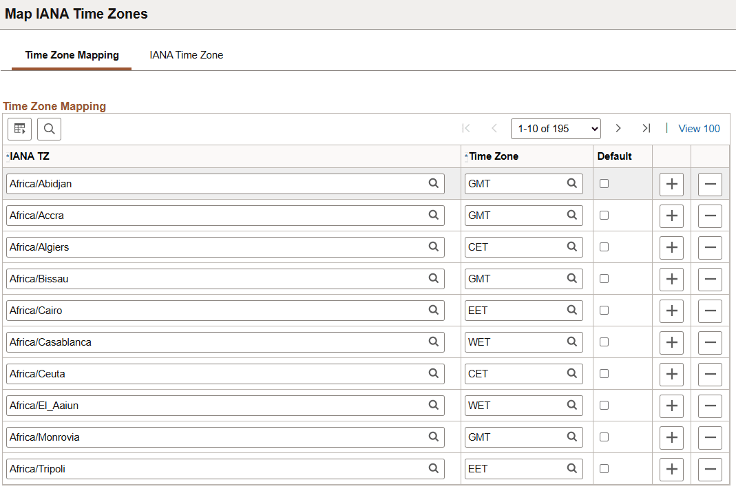

Access the Time Zone Mapping page (PeopleTools > Utilities > International > Map IANA Time Zones).
PeopleSoft has a mapping table to the industry standard IANA time zone IDs that is managed from the Time Zone Mapping page.
This example illustrates the fields and controls on the Time Zone Mapping Tab in the Time Zone Mapping Page. You can find definitions for the fields and controls later on this page.
Term
Definition
IANA TZ
IANA TZ: Specify the IANA time zone in the format from the tzdata file. This value should match the IANA time zone detected by the JVM running on the application server or process scheduler server.
Note: The IANA time zone is listed in the server logs as Detected IANA timezone.
Time Zone
Specify the PeopleSoft time zone ID this IANA time zone maps to.
Default
Set this to indicate that this is the default for reverse mapping from PeopleSoft time zone ID to IANA time zone ID. This reverse mapping is used in XMLP. See Using Time Zones in BI Publisher Reports
This example illustrates the fields and controls on the IANA Time Zone Tab in the Time Zone Mapping Page. You can find definitions for the fields and controls later on this page.
Term
Definition
IANA Time Zone
The time zone listed in tzdata. When the application server or process scheduler starts, it will be running in one of these time zones. These are the lookup values for the Time Zone Mapping page.
