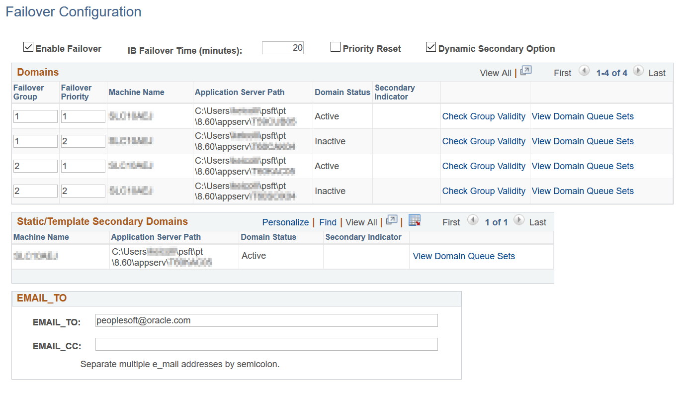

The example of the Failover Configuration page in the Setting Up Dynamic Primary-Secondary Dispatchers section of the documentation shows four domains attached to the application server. The first two domains have been assigned to failover group one, as indicated by the value 1 in the Failover Group field for each domain. The last two domains have been assigned to failover group two, as indicated by the value 2 in the Failover Group field for each domain.
The failover priority within group one is as follows: the first domain in the list is the main and primary back-up domain as indicated by the failover priority value 1; the second domain in the list is the second back-up domain as indicated by the failover priority value 2.
The failover priority within group two is as follows: the third domain in the list is the first back-up domain for group two as indicated by the failover priority value 1; the last domain in the list is the second back-up domain as indicated by the failover priority value 2.

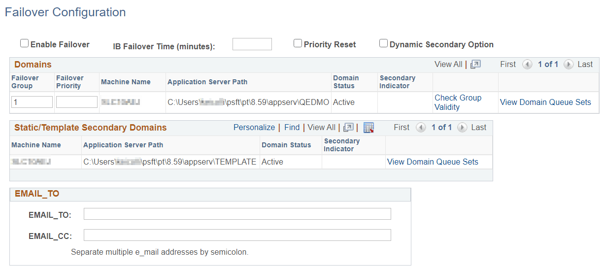

Use the Failover Configuration page (IB_AMM_FAILOVER) to enable failover on domains.
This example illustrates the Failover Configuration page.
To set up domain failover:
Access the Failover Configure page ( and click the Set Up Failover link).
Select the Enable Failover box.
In the IB Failover Time (minutes) field, specify the number of minutes that can pass without the domain registering itself before the failover should commence

When dynamic secondaries have been set the Secondary Indicator column on the Failover Configuration page displays the status Dynamic to indicate the domains that are serving as dynamic secondaries.
This example illustrates the Failover Configuration page. In the example, a dynamic secondary is configured, as indicated by the term Dynamic appearing in the Secondary Indicator column.

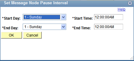

Use the Node Status page (AMM_NODE_STATUS) in the Service Operations Monitor to schedule pause times for failover. To access the page select
This example illustrates the Node Status page. Use this page to schedule pause times for failover.
When you click the Add Pause button the Set Message Node Pause Interval page (AMM_ADD_SPTIMES) appears where you can set the system pause start and stop day and time.
This example illustrates the Set Message Pause Time Interval page. Use this page to set pause start and stop times for a node.
To schedule a pause time for failover:
Access the Node Status page ().
Click the Add Pause button.
The Set Message Node Pause Interval page appears.
Schedule the pause time to start:
From the Start Day drop-down list, select the day of the week for the pause time to start.
In the Start Time field, enter the time of day for the pause time to start.
Schedule the pause time to end:
From the End Day drop-down list, select the day of the week for the pause time to end.
In the End Time field, enter the time of day for the pause time to end.
Click the OK button.
The Node Status page appears and the details of the scheduled pause time appear in the Asynchronous Pause Time grid.
