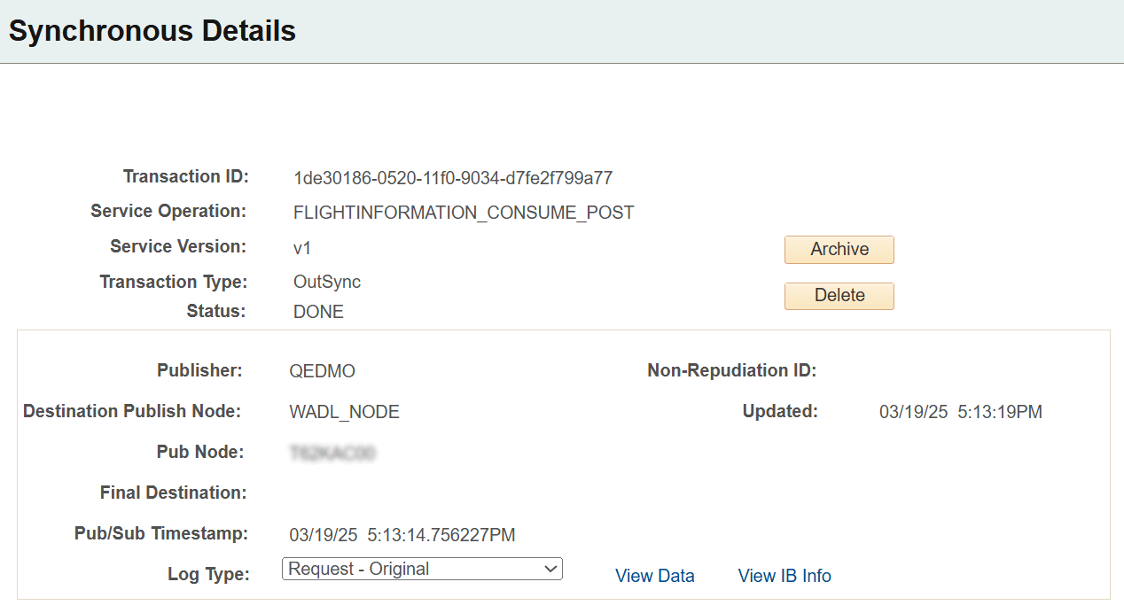

Viewing Synchronous Service Operation Details
The Synchronous Detail page provides read-only information about synchronous service operations in the system. It also enables you to view signature information for a service operation if it was processed with nonrepudiation logic.
To access the page, select
This example illustrates the fields and controls on the Synchronous Details page. You can find definitions for the fields and controls later on this page.
The page displays data in the following page elements:

Signature |
If a service operation is sent with a signature, a Signature link appears next to the Non-Repudiation ID field. When you click the Signature link, the service operation signature appears in XML format. |

View IB Info |
Click the link to view IB info in XML format for the service operation, such as transaction ID. |
View Data |
Click to view the service operation content. |
