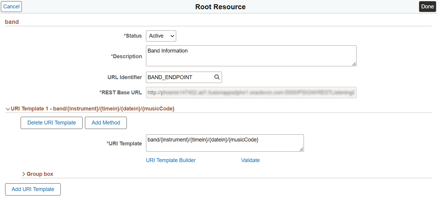

Once the URI Template is defined, it is added to the Root Resource page. Select the root resource from the Application Service page.
This example illustrates the fields and controls on the Root Resource page with URI Template. You can find definitions for the fields and controls later on this page.
Field or Control
Description
Delete URI Template
Select to delete the URI template.
Add Method
Select to add the method.
URI Template Builder
Select to modify the existing URI template.
Add URI Template
Select to add another URI template.

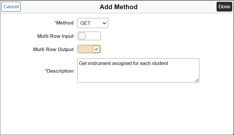

Adding Method
Select the Add Method button.
This example illustrates the fields and controls on the Add Method page for Consumer Application Service. You can find definitions for the fields and controls later on this page.
Field or Control
Description
REST Method
Select type of HTTP method.
Multi Row Input
If you have multiple rows of input, select Yes, otherwise select No.
Multi Row Output
If you have multiple rows of output, select Yes, otherwise select No.
Description
Description of the method implementation.
REST Methods
REST methods determine the HTTP method for manipulating the resources defined in the Application Service.

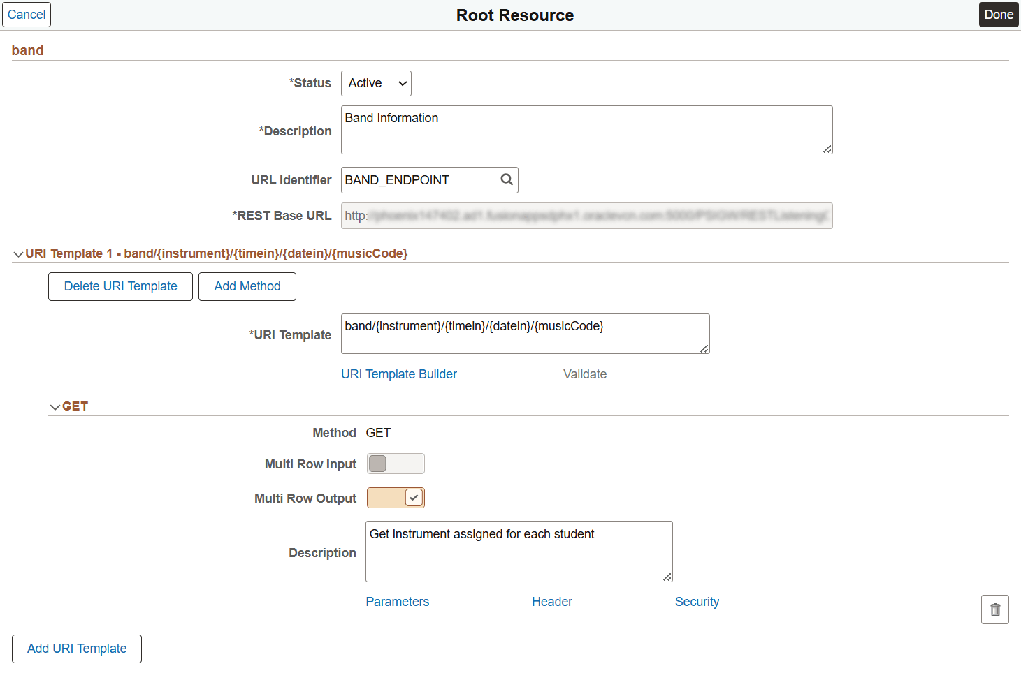

Root Resource with URI Template Defined
After you add a method to the URI template, you can expand the URI Template.
This example illustrates the fields and controls on the Root Resource with URI Template Method for Consumer Application Service. You can find definitions for the fields and controls later on this page.
For the expanded method the following links are available.
Field or Control
Description
Parameters
Select this link to maintain the available input and output parameters.
See Adding Input and Output Parameters.
Header
Optionally headers can be assigned for the Request or Response. Selection of the Headers link will bring up the Headers page. These headers will be part of the Open API documentation for the 3rd party to set (Request) or read (Response).
See Defining Headers.
Security
Select this link to set the security for this method. See Setting Security Details
