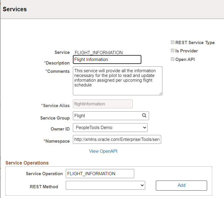

  4. Use the Service Operations section to add REST Method.
    This example illustrates the Services page for a REST Service.
    REST Service page
  5. Select the REST method from the drop-down list. The valid values are:

  6. Click Add.
    The Service Operations page appears.
The system automatically appends the service operation name with the name of the selected REST method. This functionality allows you to reuse the service operation name using other method types.
For example, if you enter the REST method GET for the Service FLIGHT_INFORMATION, the Service operation will be FLIGHT_INFORMATION_GET.
