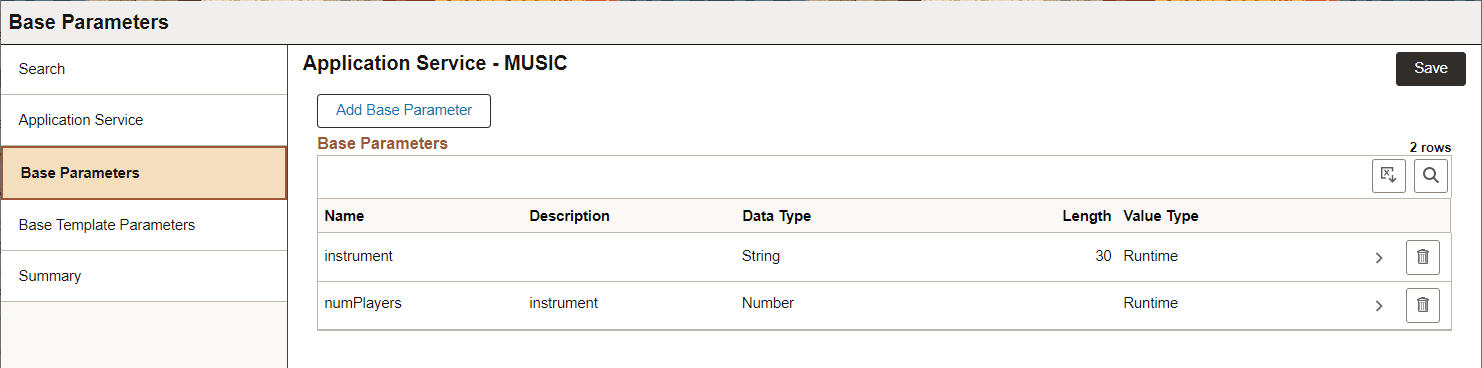

When you select Base Parameters, the existing base parameters are listed. Click Add Base Parameter to add new base parameters.

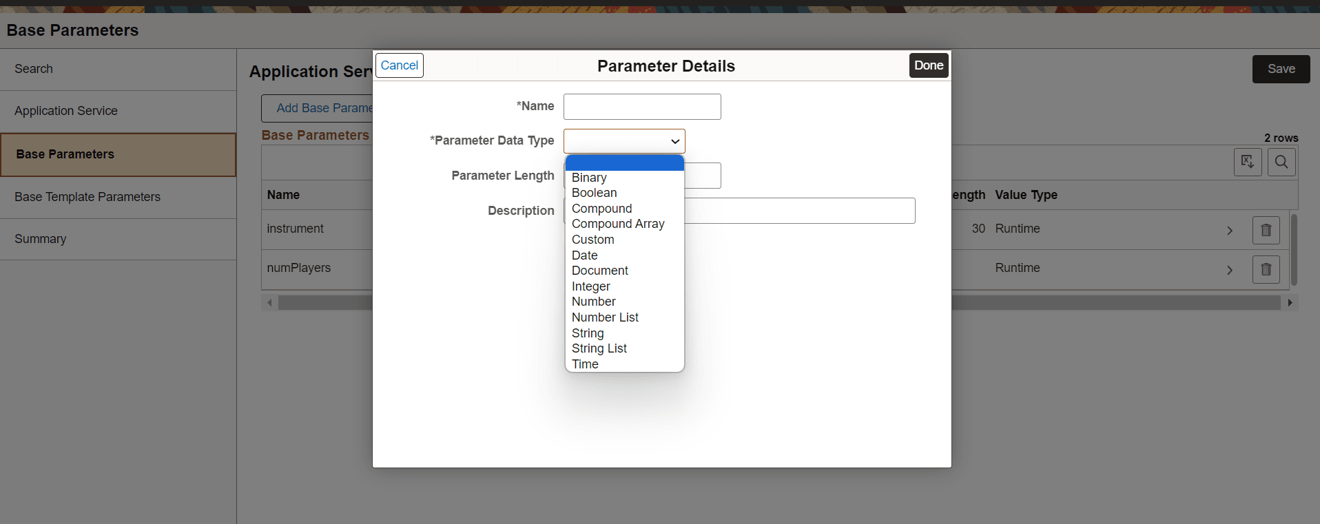

This example illustrates the fields and controls on the Base Parameters Details page. You can find definitions for the fields and controls later on this page.
Field or Control |
Description |
Name |
Enter a name for the parameter. The name entered must adhere to Oracle's naming standard. |
Parameter Data Type |
Data type for the parameter: Binary, Boolean, Compound, Compound Array, Custom, Date, Document, Integer, Number, Number List, String, String List, or Time. Note: Boolean and Document parameter types are not supported for Chatbot specific integrations. |

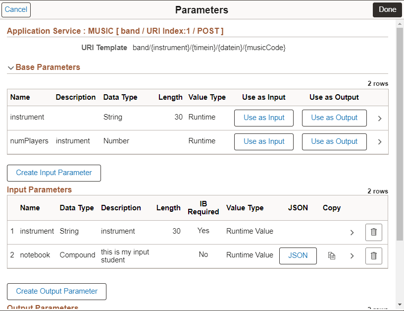

When you select Parameters for the Application Service, the base parameters will be available to use as input or output.
This example illustrates the fields and controls on the Parameters page. You can find definitions for the fields and controls later on this page.

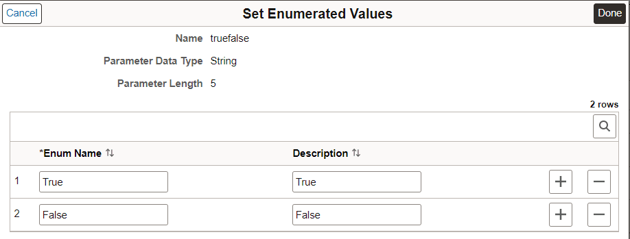

Enumerated Values can be added to parameter type String or String List. To add enumerated values:
Create the String or String List and select Done.
Open the parameter, it will contain a link to Add Enumerated Values.
Select the Add Enumerated Values link.
This example illustrates the fields and controls on the Set Enumerated Values page.
Enter the values and click Done.
