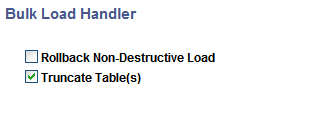

The Bulk Load Handler page (IB_SERVICEHDL5_SEC) features a Rollback Non-Destructive Load option that you can set to enable transaction rollback.
This example illustrates the Bulk Load Handler page. The example shows the page when the service operation contains a nonrowset-based message.
The previous example shows the Bulk Load Handler page that displays when the service operation contains a nonrowset-based message.
If the service operation contains a rowset-based message, the page does not display the XML attribute fields or the data tree structure controls.
This example illustrates the Bulk Load Handler page. The example shows the page when the service operation contains a rowset-based message.
Note: Transactional rollback is not supported if message segments are used. Transactional rollback will automatically be disabled if the message being processed contains more then one message segment.
To enable rollback processing:
On the Service Operations – Handlers tab, in the Handlers section, click the Details link.
The Bulk Load Handler page appears.
Select the Rollback Non-Destructive Load check box.
The Rollback Size field appears.
In the Rollback Size field, enter a rollback size value, in kilobytes.
The amount of data that you can rollback is depends on your database.
The default is 32.
Warning! Before you specify a rollback size value, verify the rollback size configured for your database. If the rollback size value specified in the PeopleSoft Pure Internet Architecture is greater then the transactional rollback size configured on the database, then transactional rollback will be disabled for that particular transaction, thereby causing destructive load processing to take place. To avoid destructive load processing, modify the rollback size configured for your database so that it is greater than the value you specify on the Bulk Load Handler page.
Click the Save button.

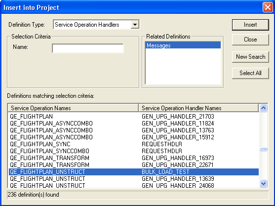

You must assign nonrowset-based messages you create using the Bulk Load Handler page to a bulk load handler. To accomplish this task, in PeopleSoft Application Designer when you insert a service operation handler definition into a project, you must include the message(s) as a related definition.
This example illustrates the Insert into Project page.
To insert a service operation handler definition and related message definitions into a project:
In PeopleSoft Application Designer, from the Insert menu, select Definitions info Project.
The Insert into Project page appears.
From the Definition Type drop-down list box, select Service Operation Handlers.
Click Insert to view all service operation definitions and handlers in the system.
Click the name of the service operation and handler to insert into the project.
In the Related Definition section, click Messages.
Click the Insert button to insert the service operation, handler, and related messages into the project.
