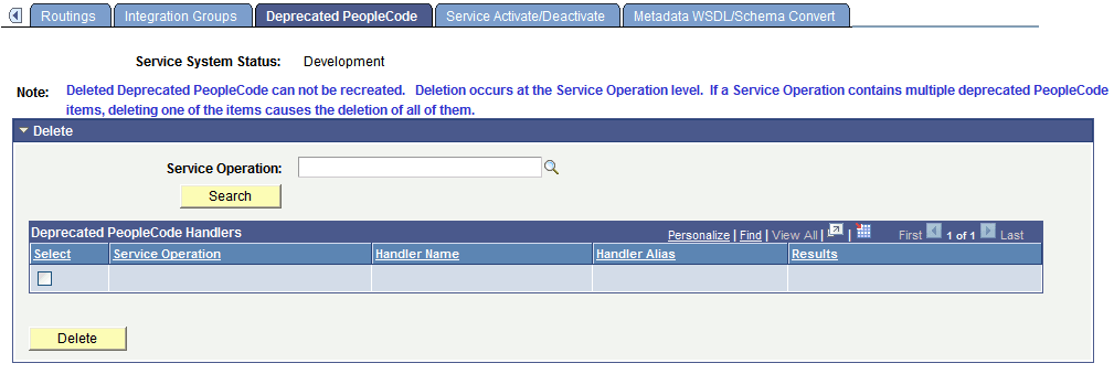

Use the Service Administration – Deprecated PeopleCode page (IB_HOME_PAGE8) to delete deprecated PeopleCode and its associated handler(s).
To access the page select and click the Deprecated PeopleCode tab.
This example illustrates the Service Administration – Deprecated PeopleCode page.
The page enables you to delete the PeopleCode that was assigned to the Pre-PeopleTools 8.48 subscription, along with the (deprecated) handler that was created to invoke the PeopleCode.
Warning! Deleted deprecated PeopleCode cannot be recreated.

Access the Service Administration – Deprecated PeopleCode page ( and click the Deprecated PeopleCode tab).
In the Service Operation field, enter the name of the service operation that contains the deprecated PeopleCode handler, or click the Lookup button to search for one.
Click the Search button.
The search results appear in the Deprecated PeopleCode Handler grid.
Select the Select check box next to the handler to delete.
Click the Delete button.
