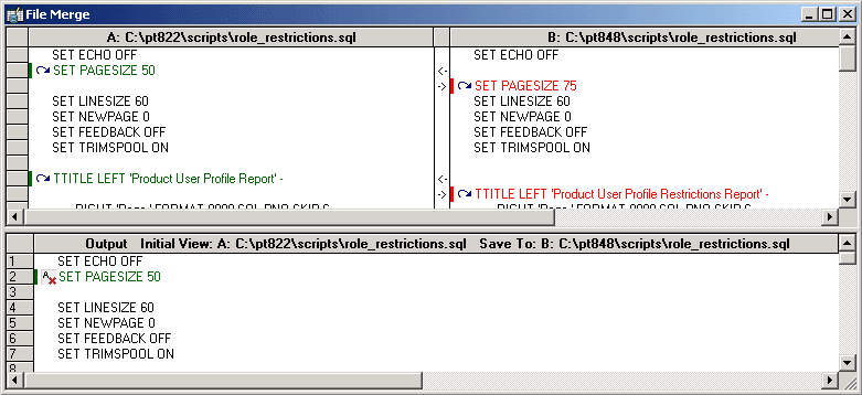

The following is a screenshot of Merge interface for a text definition.
The merge interface displays three windows: the A: window, the B: window, and the Output window.

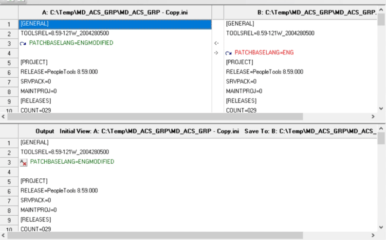

The following is a screenshot of Merge interface for an external text file.
The merge interface displays three windows for an external text file: the A: window, the B: window, and the Output window.

Working with the Output Window
The output window displays what will be the finished result of the merge after clicking Save.
Initially either the A: or B: definition view will appear, depending on what you selected as the Initial Output View in the Merge Properties dialog. The Initial View window label displays the value you selected.
The output window label also displays the Save To value, which represents the location in which the merged results will be saved.
