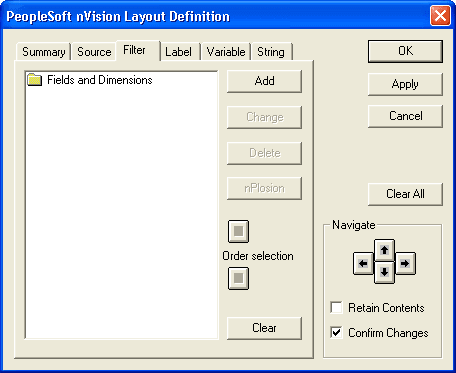

The PeopleSoft nVision Layout Definition dialog box appears.
Select the Filter tab, and click the Add button.

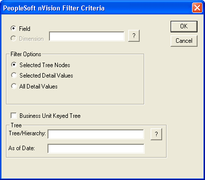

The PeopleSoft nVision Filter Criteria dialog box appears.

This example illustrates the fields and controls on the PeopleSoft nVision Layout Definition - Filter dialog box.
This example illustrates the fields and controls on the PeopleSoft nVision Filter Criteria dialog box, which enables you to select the fields and field values to use as filter criteria.
Field or Control |
Description |
Field |
The text box to the right of the Field option displays the field that will be used as criteria. It displays value for only one field at a time—whichever field is selected in the upper text box. You add fields to this list by clicking the Search (?) button and selecting field names. To select from a list of fields, type in a partial name before clicking the Search button. |
Filter Options |
Use the Filter Options section to specify the source of the field values that you want to add to the filter criteria: Selected Tree Nodes, Selected Detail Values, or All Detail Values. If your database contains ledgers, the Selected Summary ChartField Nodes option appears. If the Selected Summary ChartField Nodes option is selected, the Tree fields appear prompting you to select a tree from which you select node values to use as criteria. You can select any tree that uses the specified field for its node values and is defined for the setID and effective date associated with the layout. |
Business Unit Keyed Tree |
Select this option if your criteria is based on a business unit keyed tree. |
Tree/Hierarchy |
Displays the name of the tree. Note: In a dynamic detail tree structure, the field name of the detail values should match the field name of the tree nodes. If these two field names do not match, then an error message appears indicating that the tree is invalid. |
As of Date |
Optionally, enter the As of Date values for the tree. If the As of Date value is earlier than the effective date of the tree or is invalid, an error message appears when you save the criteria. |

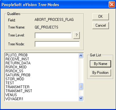

The PeopleSoft nVision Tree Nodes dialog box appears.
This example illustrates the fields and controls on the PeopleSoft nVision Tree Nodes dialog box.

The Tree Nodes dialog box appears.
If you know the exact node you want to add, enter it in the Tree Node field and click the OK button.
The Tree Nodes dialog box closes and you are returned to the PeopleSoft nVision Layout Definition – Filter Criteria dialog box, which has an added node in the list box.
Optionally, apply a node list filter.
To limit node choices to a particular level, select a valid tree level.
To limit node choices to a particular tree branch, enter the tree node at the top of the branch.
Display the node list.
To see an alphabetical list of the tree nodes, click the By Name button. Use this button if you have specified a tree level. If you have also specified a tree node, it must be a valid node in the level or no nodes will appear in the list.
To see the hierarchical node structure of the tree—similar to what you would see in Tree Manager—click the By Position button. Use this button if you have specified a tree node. If you also specified a tree level, it is ignored.
Note: You can use the two list filtering buttons together to help you find the nodes you want. For example, you might first want to see nodes at a particular tree level, in alphabetical order, using the By Name button to find the higher-level node that you want. Then, you can specify that tree node and click the By Position button to see the portion of the tree headed by that node.
Highlight the nodes you want to add.
Click the OK button to add the highlighted nodes.
The Tree Nodes dialog box closes. You can now see the new node values listed in the tree control list box of the PeopleSoft nVision Layout Definition – Filter dialog box.

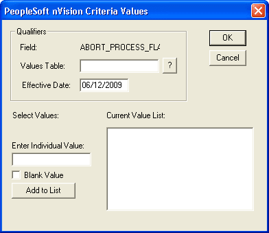

This example illustrates the fields and controls on the PeopleSoft nVision Criteria Values dialog box.

If you select the Selected Detail Values option, the PeopleSoft nVision Criteria Values dialog box appears. You use this dialog box to specify the tree detail values you want to add to your filter criteria.
In the Qualifiers group box of the PeopleSoft nVision Criteria Values dialog box, specify a values table.
Optionally, enter a new effective date.
The default effective date is the value you specified when creating the layout definition.
Select the values to add.
If you know the value you want, enter it in the Enter Individual Value field and click the OK button. Otherwise, use the prompt button to display a list of detail values from the Values Table that you specified. You can select multiple values before clicking the Add to List button.
Select the Blank Value option—with the Enter Individual Value field empty—to include a null value.
Click the Add to List button.
Clicking the Add to List button adds a null value to the list, represented graphically by (None) in the Current Value List text box. The null value appears at the top of the list in the list box, but the actual null value is inserted at the bottom of the list on the PeopleSoft nVision Layout Definition – Filter dialog box.
You can change the order of a value by using the order selection controls on the PeopleSoft nVision Layout Definition – Filter dialog box.
Click the OK button to save your changes and to close the PeopleSoft nVision Criteria Values dialog box.
