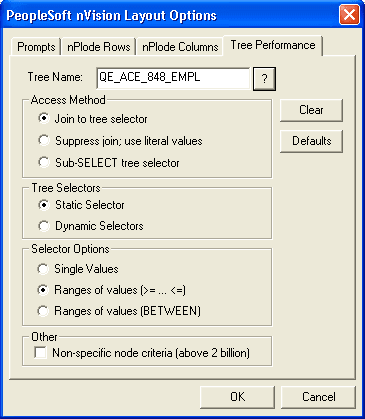

Access the Tree Performance tab from Excel, select ; and then select the Tree Performance tab.
This example illustrates the fields and controls on the PeopleSoft nVision Layout Options dialog box: Tree Performance tab.
