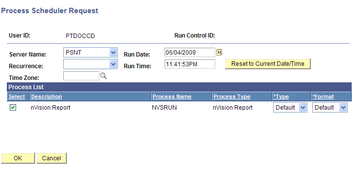

Use the Process Scheduler Request (PRCSRQSTDLG) page to run nVision reports.
Note: Changes to the nVision report request are not saved when the user clicks the Run button, thus enabling the user to run ad hoc reports as they would from the nVision windows client. If changes have been made to the report request and the user attempts to navigate to a different page, such as using the Process Monitor link, then the user is prompted to either save or discard the changes made to the report request.
Navigation:
Select in PIA.
Select a report ID or add a new one.
Click the Run Report button.
This example illustrates the fields and controls on the Process Scheduler Request page. Definitions for the fields and controls appear following the example.
Select the Default option in the Type and Format fields to use the options specified in the report request, or override the request by selecting other options.
The Type menu includes these options:

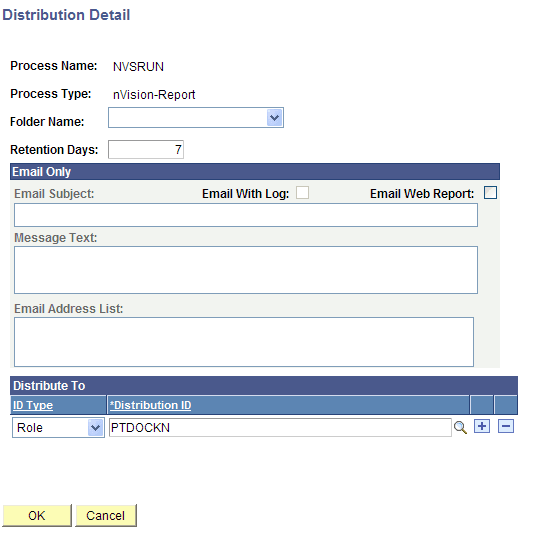

Use the Distribution Detail page to select the recipients of your report instances separate from what you have specified in your report request. If the output type is email, you can enter email addresses, email subject, and message. If you are entering a list of email addresses, make sure to use a semicolon (;) to separate each address from the others.
Navigation:
Select in PIA.
The Process Scheduler Request page appears.
Select a report type, and click the Distribution link.
The Distribution Detail page appears if the output type is web, window, or email.
This example illustrates the fields and controls on the Distribution Detail page.
Note: To distribute reports to a role ID or a user ID using email, all recipients must have an email address entered in their Security user profile.
