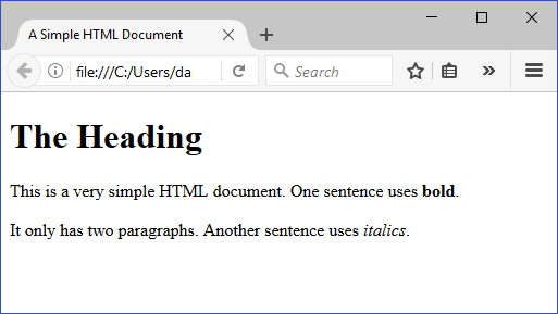

Sample HTML File
The following code presents the contents of a simple HTML file. The line numbers are included for reference only and are not part of the file:
[01] <!DOCTYPE html>
[02] <html>
[03] <head>
[04] <title>
[05] A Simple HTML Document
[06] </title>
[07] </head>
[08] <body>
[09] <h1>The Heading</h1>
[10] <p>This is a very simple HTML document. One sentence uses <b>bold</b>.</p>
[11] <p>It only has two paragraphs. Another sentence uses <i>italics</i>.</p>
[12] </body>
[13] </html>
The browser displays this example HTML file as follows:

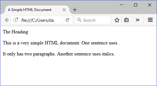

Example of Sanitized HTML Output
The following code presents the sanitized HTML output of the simple HTML file. Similarly, the line numbers are included for reference only and are not part of the file:
[01]
[02] <html>
[03] <head>
[04] <title>
[06] </title>
[07] </head>
[08] <body>The Heading<p>This is a very simple HTML document. One sentence uses <b></b>.</p><p>It only has two paragraphs. Another sentence uses italics.</p></body>
[09] </html>
The browser displays this sanitized HTML output file as follows:
