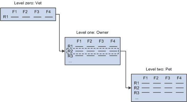

The following diagram shows the scroll path of this statement, assuming that the value of &L1ROW is 2:

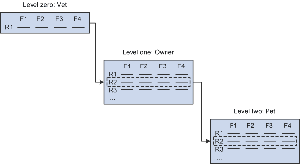

The following diagram indicates the scroll path of this statement, assuming that the value of &L1_ROW is 2 and that &ROW_NUM is equal to 2:

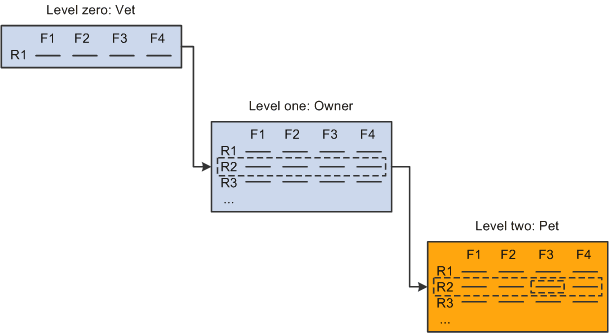

The following diagram indicates the scroll path to the target field, assuming that &L1_ROW equals 2, &L2_ROW equals 2, and field F3 is PET.PET_BREED.
