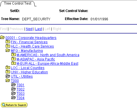

The following example shows an HTML tree. This is used to display data in tree format using GenerateTree function.
The positional links at the top of the page (First, Previous, Next, Last, Left, Right) enable the user to navigate around the tree. These links are automatically generated as part of the execution of GenerateTree.
When a node is collapsed, a plus sign appears on the node icon, and the node's children are hidden. When a node is expanded, all child nodes appear, and the icon displays a minus sign. Icons without a plus or minus sign are terminal nodes, which have no children and cannot be expanded or collapsed.

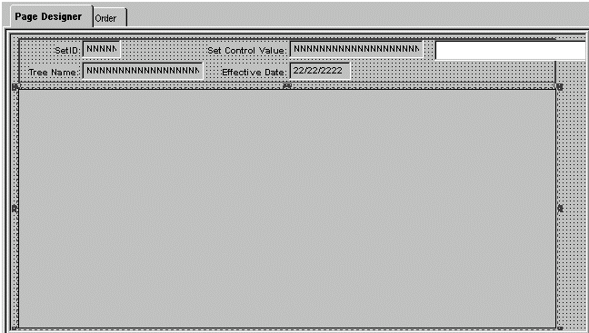

This is an example page for an HTML tree:
This example illustrates the fields and controls on the Example of PeopleSoft Application Designer HTML tree page. You can find definitions for the fields and controls later on this page.
The large area that is selected in the example is the HTML area that displays the HTML tree. The HTML area is attached to the DERIVED_HTML.HTMLAREA field for this example.
The white edit box is the invisible field used to pass events from the HTML tree to the application. It is attached to the DERIVED_HTML.TREECTLEVENT field for this example.
The edit box must have a page field name. In this example, the page field name is TREECTLEVENT.
