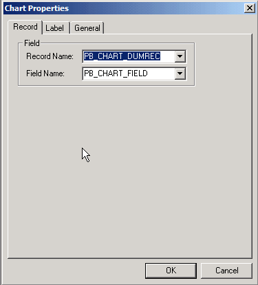

Associating the Chart Control with a Record Field
Each chart on a component must be associated with a unique field. Double-click the chart control to access the Chart Properties dialog box and enter a record name and field name.
The chart field has no special requirements. Its only purpose is to provide a reference to the field in PeopleCode.
This sample chart uses a derived/work record named DOC_CHRT_WRK that is dedicated to this purpose.

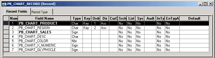

Creating the Chart Data Record
The chart needs either a record or a rowset to serve as the data source. This sample chart uses a record. See the Chart class SetData method for details about using a rowset.
See SetData.
At a minimum, the record must have fields for the x-axis data and the y-axis data. Optionally, the record can have fields for series data, chart color, and glyph size.
The record must be available in the component buffer at runtime. You can use a database record that is already part of your application or you can use a derived/work record or a component rowset that you populate at runtime. For greatest control, you will normally populate your record or rowset at runtime.

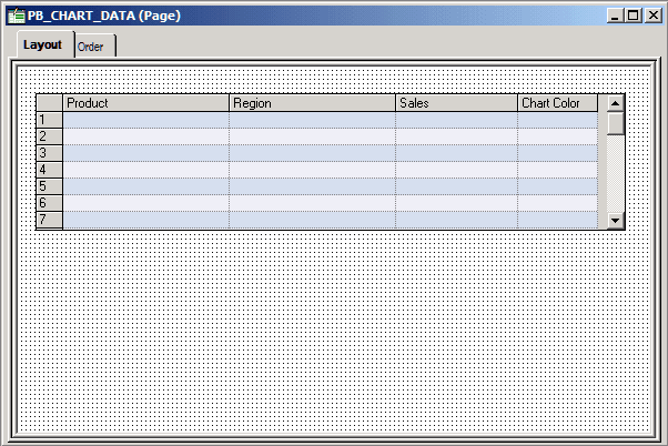

For the sample chart, place the record on a grid on a second page on the sample component. This placement gives you the opportunity to experiment with the data.
Your chart data record must be placed at level 1 on the same component as the chart so that the data is available in the component buffer at runtime. In your application, you can hide the grids or scroll areas that hold the records. For the sample chart, you will keep the grid visible so you can enter sample data.

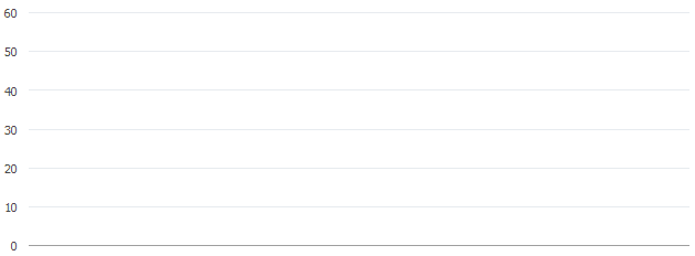

Viewing the Page in the Browser

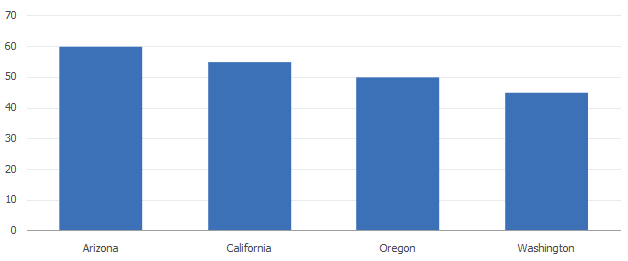

This is the most basic Chart class chart. It has no data and only the default y-axis.

This bar chart is generated by the example code and data:
This chart graphs sales on the y-axis (the vertical axis) and regions on the x-axis (the horizontal axis).

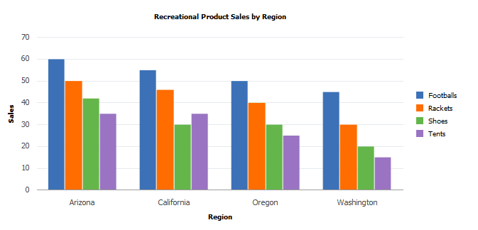

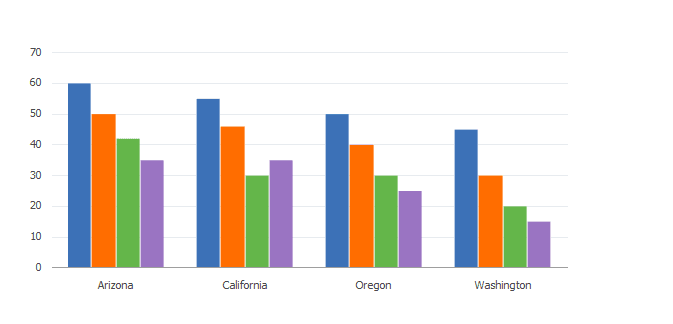

Add this PeopleCode to set the series record field:
&cChart.SetDataSeries(DOC_CHRT_SLSREC.DOC_CHRT_PRDCT);
The resulting chart is a default 2D bar chart with bars for each region grouped by series:
The chart has four series:
Footballs
Rackets
Shoes
Tents
Each series shows four regions along the x-axis:
Arizona
California
Oregon
Washington
Sales values appear against the y-axis as bar height.
The chart uses the default colors.

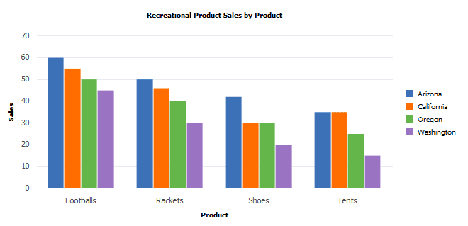

Changing X-Axis and Series Values
&cChart2.SetDataXAxis(DOC_CHRT_SLSREC.DOC_CHRT_PRDCT);
&cChart2.SetDataSeries(DOC_CHRT_SLSREC.DOC_CHRT_RGN);
&cChart2.MainTitle = "Recreational Product Sales by Product";
&cChart2.XAxisTitle = "Product";
To group sales by product instead of by region, switch the series and the x-axis. You will also need to reorder colors to correspond to regions instead of products:

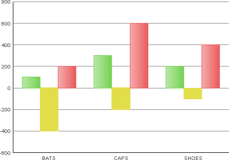

If your chart has negative values, the bars automatically extend below the x-axis:

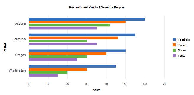

Horizontal Bar Chart
Use this line of code to specify a horizontal bar chart:
&cChart.Type = %ChartType_2DHorizBar;
This example illustrates a horizontal bar chart:

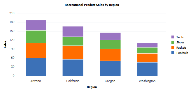

Stacked Bar Chart
With a the stacked bar chart, you can place a different emphasis on the same data. The stacked column shows total sales per region as well as the product segments that contribute to the total.
Use this line of code to specify a stacked bar chart:
&cChart.Type = %ChartType_2DStackedBar;
This example illustrates a stacked bar chart:

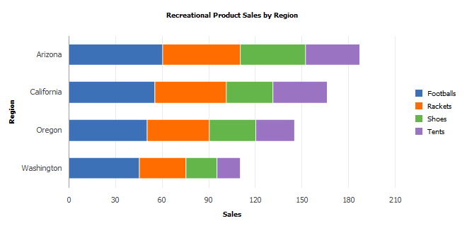

Horizontal Stacked Bar Chart
Use this line of code to specify a horizontal stacked bar chart:
&cChart.Type = %ChartType_2DHorizStackedBar;
This example illustrates a horizontal stacked bar chart:

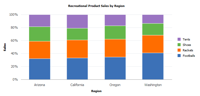

Percent Bar Chart
A percent bar is similar to a stacked bar, but the segments of each bar add up to 100. The segments show the proportional contribution of each product to total sales.
Note: Negative values cannot be displayed in any type of percent bar chart.
Use this line of code to specify a stacked percent bar chart:
&cChart.Type = %ChartType_2DPercentBar;
This example illustrates a percent bar chart:

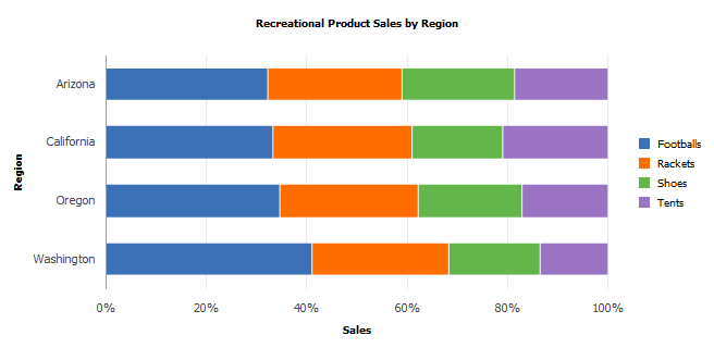

Horizontal Percent Bar Chart
Use this line of code to specify a horizontal percent bar chart:
&cChart.Type = %ChartType_2DHorizPercentBar;
This example illustrates the fields and controls on a horizontal percent bar chart:

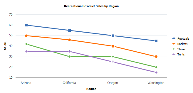

Line Chart
A line chart is useful for showing changes and trends over time or across categories.
Use this line of code to specify a line chart:
&cChart.Type = %ChartType_2DLine;
This example illustrates a line chart:

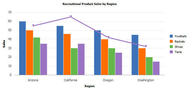

Overlay Chart
You can overlay one chart on top of another to compare two different but related sets of data. The following chart uses a second set of data, showing average temperature for each region.
Use the OLType property to specify whether the overlay is a line chart or a histogram.
Add this PeopleCode to the PeopleCode for your bar chart to create 2D line chart overlay:
/* Create Overlay */
&cChart3.SetOLData(Record.DOC_CHRT_OLREC);
rem &cChart.SetOLDataSeries(DOC_CHRT_OLREC.SC_CHART_SERIES);
&cChart3.SetOLDataXAxis(DOC_CHRT_OLREC.DOC_CHRT_RGN);
&cChart3.SetOLDataYAxis(DOC_CHRT_OLREC.DOC_CHRT_SALES);
&cChart3.OLType = %ChartType_2DLine;
This example illustrates a 2D line chart overlay on a vertical bar chart:

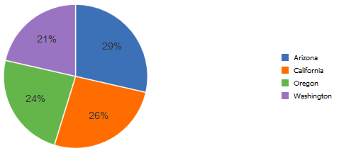

Pie Chart
A pie chart shows comparisons within a single set of values, and it shows how parts contribute to a whole. It is an ideal chart type to display the contribution of each region to an annual sales total.
A pie chart ignores the series and only plots x-axis data against y-axis values. Our original bar chart has four regions times four products, resulting in 16 XY pairs. A pie chart with all of those slices would be confusing and not helpful. Instead, suppose you want to show just the data for tents, which are in rows 13–16. You can use a combination of the DataWidth and DataStartRow properties to select which rows to display.
You can make a pie chart showing only rows 13–16 by adding this snippet of code:
&cChart.DataWidth = 4;
&cChart.DataStartRow = 13;
&cChart.Type = %ChartType_2DPie;
This example illustrates a 2D pie chart generated from a portion of the rowset:

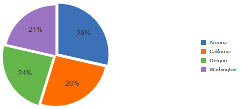

Exploded Pie Chart
Use the SetExplodedSectorsArray Chart class method to specify the sectors to explode. Sectors correspond to rows of data used by the pie chart. Sector 1 is the first row of data, or the row specified with the DataStartRow chart class property, if it is used, and so on.
The following snippet of code explodes sectors 1 and 3:
Local array of number &ExplodedArray;
&ExplodedArray = CreateArray(1,3);
&cChart.SetExplodedSectorsArray(&ExplodedArray);
This example illustrates an exploded pie chart:

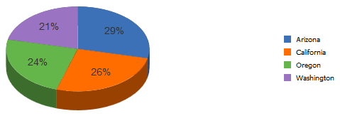

3D Pie Chart
Use this line of code to specify a 3D pie chart:
&cChart.Type = %ChartType_3DPie;
This example illustrates a 3D pie chart.

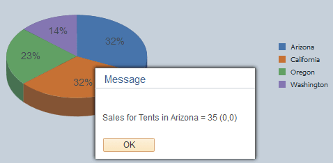

Adding Drilldown
If you set the property IsDrillable to True and add FieldChange PeopleCode to your chart, your user can get more information by clicking a chart data element—a bar, line segment, data point, or pie slice.
For a simple example, add this PeopleCode to the FieldChange event on the y-axis field:
MessageBox(0, "", 0, 0, "Sales for " | DOC_CHRT_SLSREC.DOC_CHRT_PRDCT | " in " | DOC_CHRT_SLSREC.DOC_CHRT_RGN | " = " | DOC_CHRT_SLSREC.DOC_CHRT_SALES | "");
And add this code to the page Activate event for your pie chart:
&cChart.IsDrillable = True;
When the user clicks the Arizona slice of the pie chart, this message appears:
Current context provides the values for fields in the current row in the component buffer. You can use drilldown with your chart data fields along with any other data in the component buffer to accomplish anything FieldChange PeopleCode is capable of.

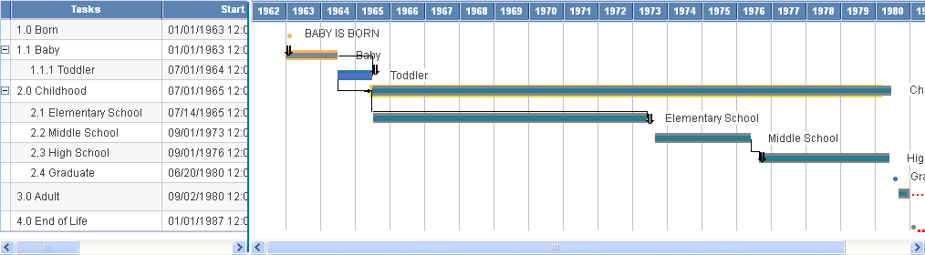

The PeopleCode and data used in this example create the following Gantt chart:

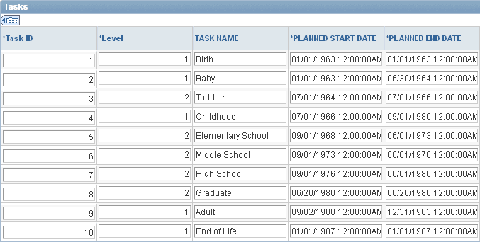

This example uses the following data in the record QE_GANTT_TASK:
This example illustrates Gantt task data:
The chart also uses the following dependency data in the record QE_GANTT_TASKD:
This example illustrates Gantt dependency data:

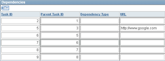

You do not need to specify dependency data. However, if you do, you must also specify the parent ID and the child ID (where the dependency data starts and ends). You can also specify the type of line used between dependencies and a URL that the browser will open to if the user clicks a dependency line.
&gGantt.SetTaskDepenencyData(Record.QE_GANTT_TASKD); &gGantt.SetTaskDependencyParentID(QE_GANTT_TASKD.QE_PARENT_TASK_ID); &gGantt.SetTaskDependencyChildID(QE_GANTT_TASKD.QE_TASK_ID); &gGantt.TaskDependencyLineType = %ChartLine_Solid; &gGantt.SetTaskDependencyURL(QE_GANTT_TASKD.URL);Specify the actual dates for the project.

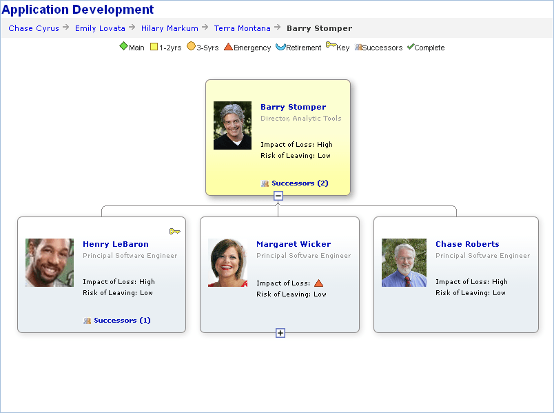

The PeopleCode used in this example creates the following organization chart:
To create an organization chart:
Add a chart control to a page in Application Designer.
Associate the chart control with a record name and field name.
Add the organization node record and the pop-up node record to the component.
These records are derived/work records that contain clones of the subrecords PTORGNODE_SBR and PTPOPUPNODE_SBR. These records must be in the component buffer. You can add them to a hidden grid on the page, or you can place them on another page in the same component.
If the chart will have breadcrumbs, add the breadcrumb node record to the component.
This derived/work record contains a clone of the subrecord PTORGCRMB_SBR. The record must be in the component buffer.
Prepare the organization chart data.
In an event such as PreBuild, instantiate two rowset objects and populate them with the organization node data and the pop-up node data.
This example shows one possible way. How you do it depends on how your data is stored and how you intend to present it.
Component Rowset &rs, &rsP, &rsBC, &rsOrgNode, &rsOrgPopupND, &rsBreadCrumbs; Component OrgChart &ocOrgChart; Local Rowset &RSGridDR; Local Rowset &RSAGRID; /* The record QE_ORG_NODEDATA has the data for the org chart ** ** You will probably fill the rowset with some subset of the data** ** in the database. This example uses all the rows. */ &rs = CreateRowset(Record.QE_ORG_NODEDATA); &rs.Fill(); /* Get the grid on the page for the node data and initalize to nulls */ & rsOrgNode = GetLevel0()(1).GetRowset(Scroll.QE_ORG_NODE); & rsOrgNode.Flush(); /* Copy data from database table, QE_ORG_NODEDATA to the derived/work ** record QE_ORG_NODE_DR */ &rs.CopyTo(&rsOrgNode, Record.QE_ORG_NODEDATA, Record.QE_ORG_NODE_DR); /* The record QE_ORG_POPDATA has the data for the popup chart */ &rsP = CreateRowset(Record.QE_ORG_POPDATA); &rsP.Fill(); /* Get the grid on the page for the popup data and initalize to nulls */ & rsOrgPopupND = GetLevel0()(1).GetRowset(Scroll.QE_ORG_POPUP); & rsOrgPopupND.Flush(); /* Copy data from database table, QE_ORG_POPDATA to the derived/work ** record QE_ORG_POP_DR */ &rsP.CopyTo(&rsOrgPopupND, Record.QE_ORG_POPDATA, Record.QE_ORG_POP_DR); /* Fill in the breadcrumb information for this chart if the chart ** ** uses breadcrumbs. */ &rsBC = CreateRowset(Record.QE_ORG_CRMB); &rsBC.Fill(); /* Get the grid on the page for the pop data and initalize to nulls */ &rsBreadCrumbs = GetLevel0()(1).GetRowset(Scroll.QE_ORG_BCRMB); &rsBreadCrumbs.Flush(); /* Copy data from database table, QE_ORG_CRMB to the derived/work ** record QE_ORG_CRMB_DR */ &rsBC.CopyTo(&rsBreadCrumbs, Record.QE_ORG_CRMB, Record.QE_ORG_CRMB_DR);Instantiate an OrgChart object.
In an event such as Activate, add PeopleCode to instantiate and define your organization chart.
Get the chart using the GetOrgChart function. The argument for this function is the record name and field name specified on the Records tab of the Chart Properties dialog box in Application Designer.
Component Rowset & rsOrgNode, & rsOrgPopupND, &rsBreadCrumbs; Component OrgChart &ocOrgChart; &ocOrgChart= GetOrgChart(QE_CHART_DUMREC.QE_CHART_FIELD);Specify the organization node record and the pop-up node record.
These records contain the clones of the subrecords PTORGNODE_SBR and PTORGPOPUP_SBR, respectively.
&ocOrgChart.SetNodeRecord(Record.QE_ORG_NODE_DR); &ocOrgChart.SetPopUpNodeRecord(Record.QE_ORG_POP_DR);Specify the node data and pop-up node data rowset objects.
/*&RSORGND and &RSORGPOPUPND are level 1 component rowsets that contain the ** organization node data and pop-up node data respectively.*/ &ocOrgChart.SetNodeData(&rsOrgNode); &ocOrgChart.SetPopUpNodeData(&RSORGPOPUPND);(Optional) Specify values for the chart display properties.
&ocOrgChart.MainTitle = "Application Development"; &ocOrgChart.MainTitleStyle = "PT_ORGCHART_TITLE"; &ocOrgChart.Direction = 2; &ocOrgChart.Height = 380; &ocOrgChart.Width = 700; &ocOrgChart.VerticalSpace = 15; &ocOrgChart.ImageLocation = 1; &ocOrgChart.Style= "PTORGCHART"; &ocOrgChart.HasLegend = True; &ocOrgChart.NodeMaxDisplayDescLength =30; &ocOrgChart.CollapsedImage ="PT_COLLAPSED_NODE"; &ocOrgChart.ExpandedImage ="PT_EXPANDED_NODE"; &Expanded_Msg=MsgGetText(110, 100); &Collapsed_Msg=MsgGetText(110, 101); &ocOrgChart.Expanded_Msg =&Expanded_Msg &ocOrgChart.Collapsed_Msg =&Collapsed_MsgSpecify values for the legend. This is required only if the chart has a legend.
&ocOrgChart.LegendStyle = PT_ORGCHART_LEGEND; &LegendArray = CreateArray("Main", "1-2yrs", "3-5yrs", "Emergency", "Retirement", "Key", "Successors"); &LegendImgArray = CreateArray("QE_NOWORGCHART", "QE_12ORGCHART", "QE_34ORGCHART", "QE_EMRORGCHART", "QE_RETIRORG", "QE_KPERSON", "QE_SUCCSORGCHART"); &ocOrgChart.SetLegend(&LegendArray); &ocOrgChart.SetLegendImg(&LegendImgArray); &ocOrgChart.LegendPosition = %ChartLegend_Top; &ocOrgChart.LegendStyle = "PT_ORGCHART_LEGEND";(Optional) Specify image values.
&ocOrgChart.ImageLocation =1; &ocOrgChart.ImageHeight =150; &ocOrgChart.ImageMouseoverMagnificationFactor =150; &ocOrgChart.DefaultImage=PT_CHART_DEFAULTIMG;Specify the breadcrumb data and the rowset and display properties. These are required only if your chart uses breadcrumbs.
&ocOrgChart.SetCrumbRecord(Record.QE_ORG_CRMB_DR); &ocOrgChart.SetCrumbData(&rsBreadCrumbs); &ocOrgChart.CrumbMaxDisplayLength = 24; &ocOrgChart.CrumbSeparatorImage = "PT_ORG_BRCRM_SEP"; &ocOrgChart.CrumbDescrStyle = "PT_ORGCHART_BRDCRM";(Optional) Specify the maximum number of nodes that will appear in the pop-up without a vertical scroll bar.
&ocOrgChart.MaxPopUpDisplayNode = 2;(Optional) Assign style class names to control the styles of each node descriptor.
If you do not specify a style class name, then the PeopleTools default style class is used.
This example uses the default style class names, so this segment of code could be omitted. It is shown for demonstration purposes only.
&ocOrgChart.NodeDescr1Style = "PT_ORGNODE_DESC1"; &ocOrgChart.NodeDescr2Style = "PT_ORGNODE_DESC2"; &ocOrgChart.NodeDescr3Style = "PT_ORGNODE_DESC3"; &ocOrgChart.NodeDescr4Style = "PT_ORGNODE_DESC4"; &ocOrgChart.NodeDescr5Style = "PT_ORGNODE_DESC5"; &ocOrgChart.NodeDescr6Style = "PT_ORGNODE_DESC6"; &ocOrgChart.NodeDescr7Style = "PT_ORGNODE_DESC7";(Optional) Assign style class names to control the styles of each pop-up node descriptor.
If you do not specify a style class name, then the PeopleTools default style sheet is used.

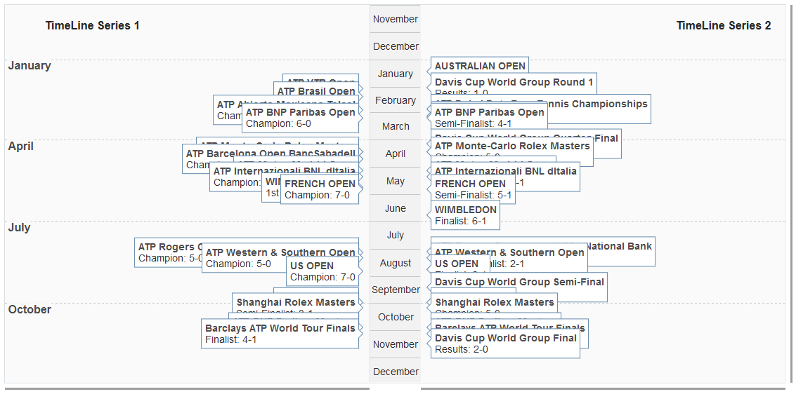

Complete the following steps to create a timeline chart with two series:
Place a chart control on a page in Application Designer.
Create an instance of the Timeline class in PeopleCode.
&oTChart = GetTimeline(QE_CDEMO_WRK.QE_CHART_TIMELINE);Specify labels for the series.
&oTChart.SetSeriesLabels(CreateArray("TimeLine Series 1", "TimeLine Series 2"));Set the scale of the major axis.
&oTChart.MajorAxisScale = "quarters";Set the scale of the minor axis.
&oTChart.MinorAxisScale = "months";Set zoom order of the timeline.
&oTChart.MinorAxisZoomOrder = CreateArray("months", "weeks");Specify start time of the timeline.
&oTChart.Start = DateTimeValue("2012-11-01 00:30:40.12-0600");Specify end time of the timeline.
&oTChart.End = DateTimeValue("2013-12-30 00:30:40.12-0600");Set the record for chart data.
&oTChart.SetData(Record.QE_TLINE_DATA);Specify the field representing the identifier for the time line series.
&oTChart.SetDataSeries(QE_TLINE_DATA.QE_TIMELINE_SERIES);Specify the field for the start time of the timeline item.
&oTChart.SetDataItemStart(QE_TLINE_DATA.QE_TIMELINE_START);Specify the field for the description to display on the timeline item.
&oTChart.SetDataItemDescription(QE_TLINE_DATA.QE_DESCR50);Specify the field for the title to display on the timeline item.
&oTChart.SetDataItemTitle(QE_TLINE_DATA.QE_CHARTTITLE);Specify the timeline orientation.
&oTChart.Orientation = %Chart_Vertical;
The preceding lines of PeopleCode generate the following timeline chart assuming that sample data is provided for the chart.
A resulting timeline chart.
