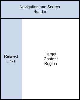

The portal template in the following example is comprised of four separate template components: one for the navigation and search header, one for related links, one for the target content region, and one for the overall template which specifies where the other components should be placed. At runtime, the target content region would be filled by the HTML returned by the target page, as would the other template component regions.
