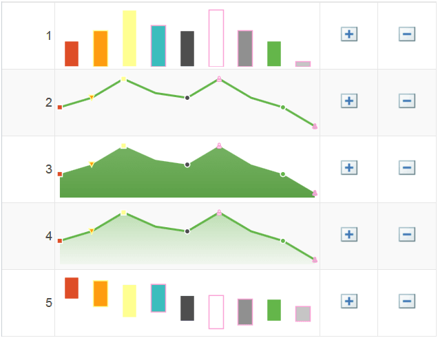

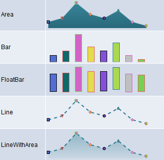

The following example illustrates five spark chart types: an area chart, a bar chart, a floating bar chart, a line chart, and a line with area chart.

The following example displays the five spark chart types: bar chart, line chart, area chart, line with area chart, and floating bar chart.
The following PeopleCode example was used to generate the preceding spark charts. The properties for each spark chart item determine its value, color, marker type, and so on.
