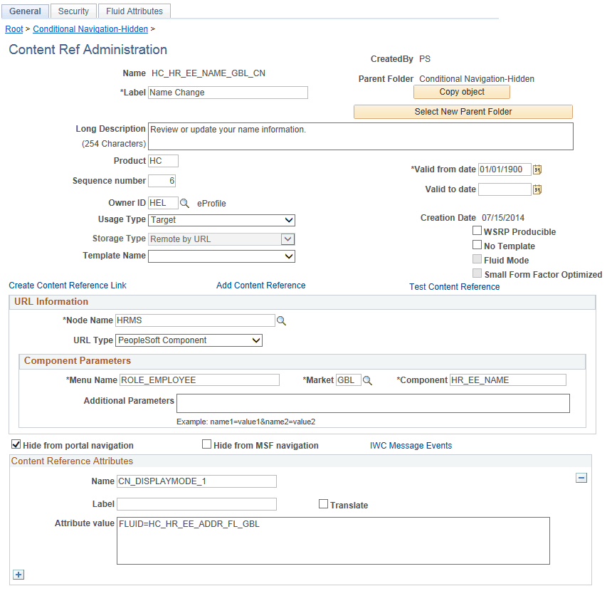

Use the Content Ref Administration page ( and click the Edit link of a content reference) to configure an alternate content reference by adding the required attributes in the Content Reference Attributes section.
This example illustrates the fields and controls on the Content Ref Administration - Content Reference Attributes section. You can find definitions for the fields and controls later on this page.
This table describes the fields that are associated with conditional navigation. For information on all the fields on the Content Ref Administration page, see Defining Content References.

Enter an attribute, for example, CN_DISPLAYMODE_1. |
Translate |
Do not select the Translate check box. Conditional navigation does not support the Translate check box. |
Attribute value |
Enter the alternate content reference. For example, FLUID=HC_HR_EE_ADDR_FL_GBL. |
To configure an alternate content reference, do the following:
Open the content reference definition that you want to configure.
In the Content Reference Attributes section, enter CN_DISPLAYMODE_1 in the Name field.
Optionally, enter a label for the attribute in the Label field.
Enter an alternate content reference in the Attribute value field.
For example: FLUID=HC_HR_EE_ADDR_FL_GBL.
