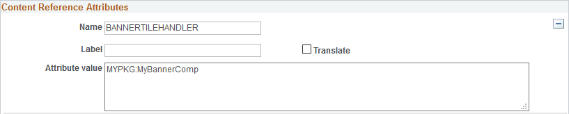

  5. In the portal registry, edit the content reference definition for this fluid dashboard.
    Note: The content reference definition can be found in Fluid Structure Content > Fluid Homepages.
  6. Add a content reference attribute:
    • Name: BANNERTILEHANDLER
    • Translate: deselected
    • Attribute value: The name of your custom application class. For example: MYPKG:MyBannerComp
    BANNERTILEHANDLER content reference attribute
    The following example illustrates the definition of the BANNERTILEHANDLER content reference attribute.
