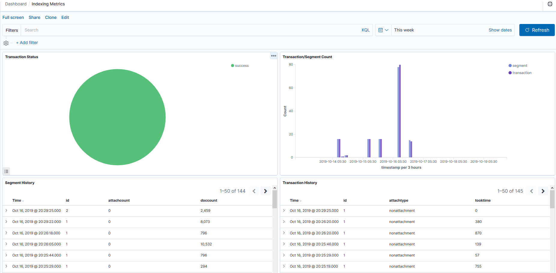

Access the Indexing Metrics dashboard by selecting Dashboard, and then selecting Indexing Metrics from the list of dashboards.
The Indexing Metrics dashboard provides statistics on the transactions and segments during indexing.
This example illustrates the visualizations on the Indexing Metrics dashboard. You can find definitions for the visualizations later on this page.
Field or Control |
Description |
Transaction Status |
Displays the status of transactions as a pie-chart. The transaction statuses are:
Selecting any of the slices from the pie-chart enables you to view only the transactions in the selected status in the Transaction Status visualization and the Transaction History visualization displays only the transactions of the selected status, thus enabling you to drill down to each transaction and view details of the transaction, such as process instance, index name, etc. For example, to drill down to the transactions that are in Error status and to understand why the transaction is in Error status, you can perform the following steps:
Transaction/Segment Count |
Displays the count of transactions and segment at a specific time period in the form of a vertical bar chart. |
Segment History |
Displays the segment history and includes the attachment count and document count in each segment. |
Transaction History |
Displays the transaction history and includes the attachment type (attachment or non attachment) in each transaction and the time taken for each transaction. |

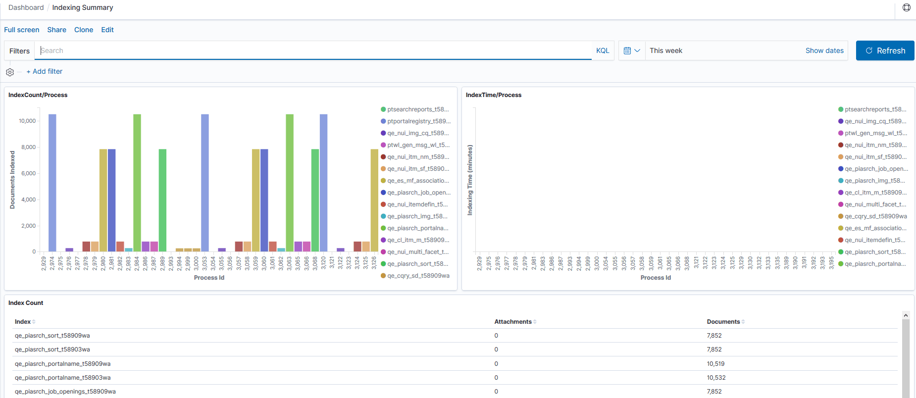

Access the Indexing Summary dashboard by selecting Dashboard, and then selecting Indexing Summary from the list of dashboards.
The Indexing Summary provides data on the indexing count and time taken for indexing.
This example illustrates the visualizations on the Indexing Summary dashboard. You can find definitions for these visualizations later on this page.
Field or Control |
Description |
IndexCount/Process |
Displays the documents indexed for an index and the process instance ID as a vertical bar chart. If you want to view a particular index, you can use the Search area (at the top of the page) to enter the index name. For example, if you want to obtain information on the ep_ap_payments index, you enter indexname:ep_ap_payments*. |
IndexTime/Process |
Displays the time taken for indexing documents for each index and the process instance ID as a vertical bar chart. If the document count is low, but the time taken is considerably high, then you should correlate with the System Metrics dashboard to observe whether the system was unstable. |
Index Count |
Displays the count of attachments and documents for each index in a tabular format. |

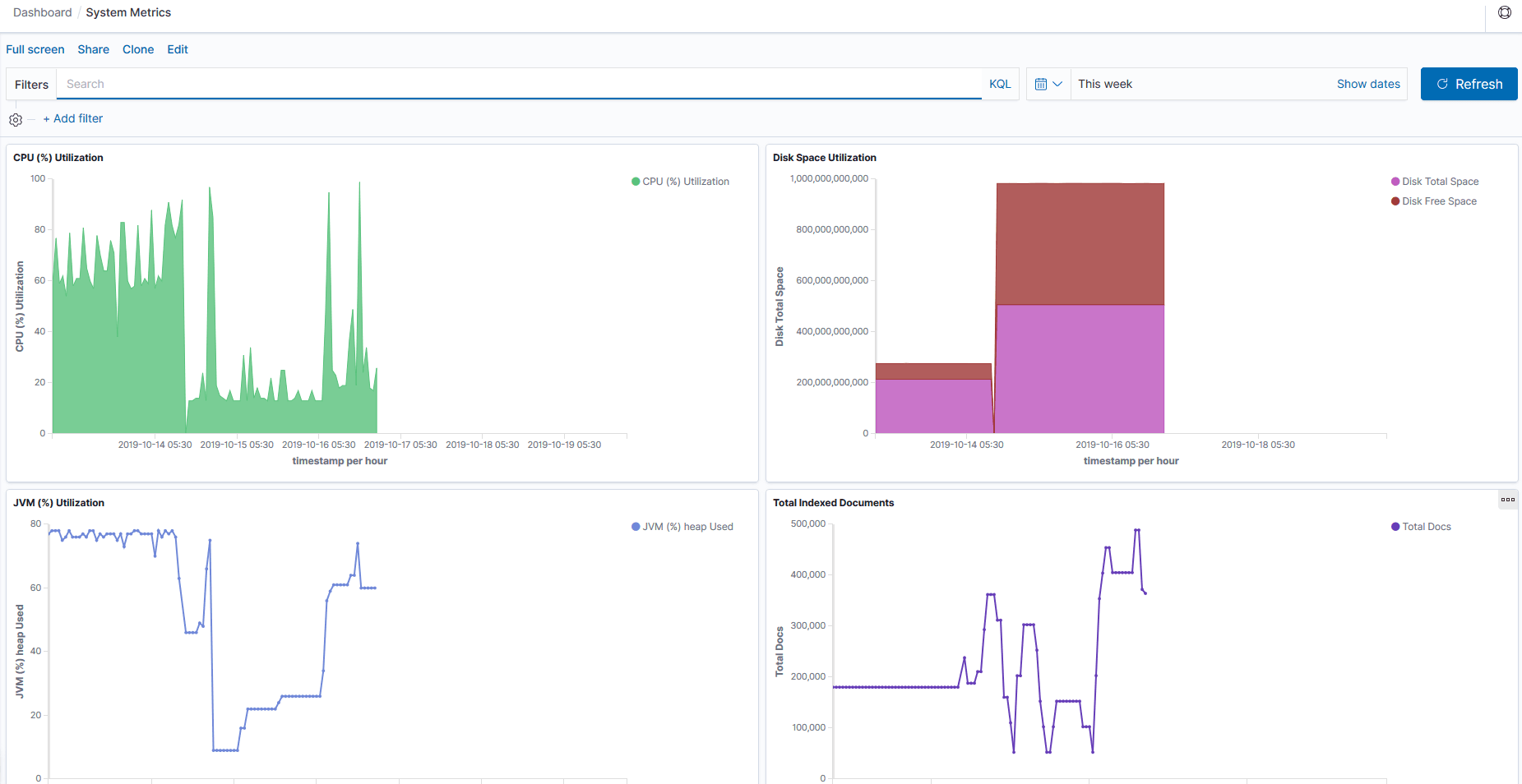

Access the System Metrics dashboard by selecting Dashboard, and then selecting System Metrics from the list of dashboards.
The System Metrics dashboard provides an overview of the system health, that is, you can view the real-time health of the system and also view the health of the system over a specific period of time in the past.
This example illustrates the visualizations on the System Metrics dashboard. You can find definitions for the visualizations later on this page.
Field or Control |
Description |
CPU (%) Utilization |
Displays the CPU utilization over a specific period of time by the OpenSearch server in the form of an area chart. |
Disk Space Utilization |
Displays the total disk space and the free space available for use in the form of an area chart. The total memory is displayed in bytes. |
JVM (%) Utilization |
Displays the total JVM percent used by the OpenSearch server in the form of a vertical bar chart. |
Total Indexed Documents |
Displays the total number of indexed documents over a specific period of time in the form of a line chart. |
