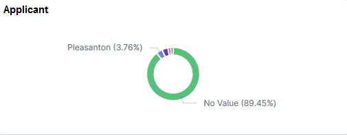

This example illustrates the Applicant dashboard configured as a tile on a homepage.

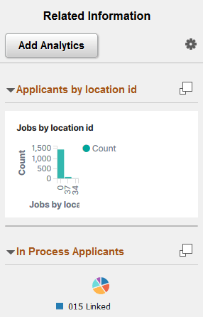

The dashboards that are configured as related information of a component display on the right panel of the component.
This example illustrates a dashboard configured as related information. You can find definitions for the fields and controls later on this page.

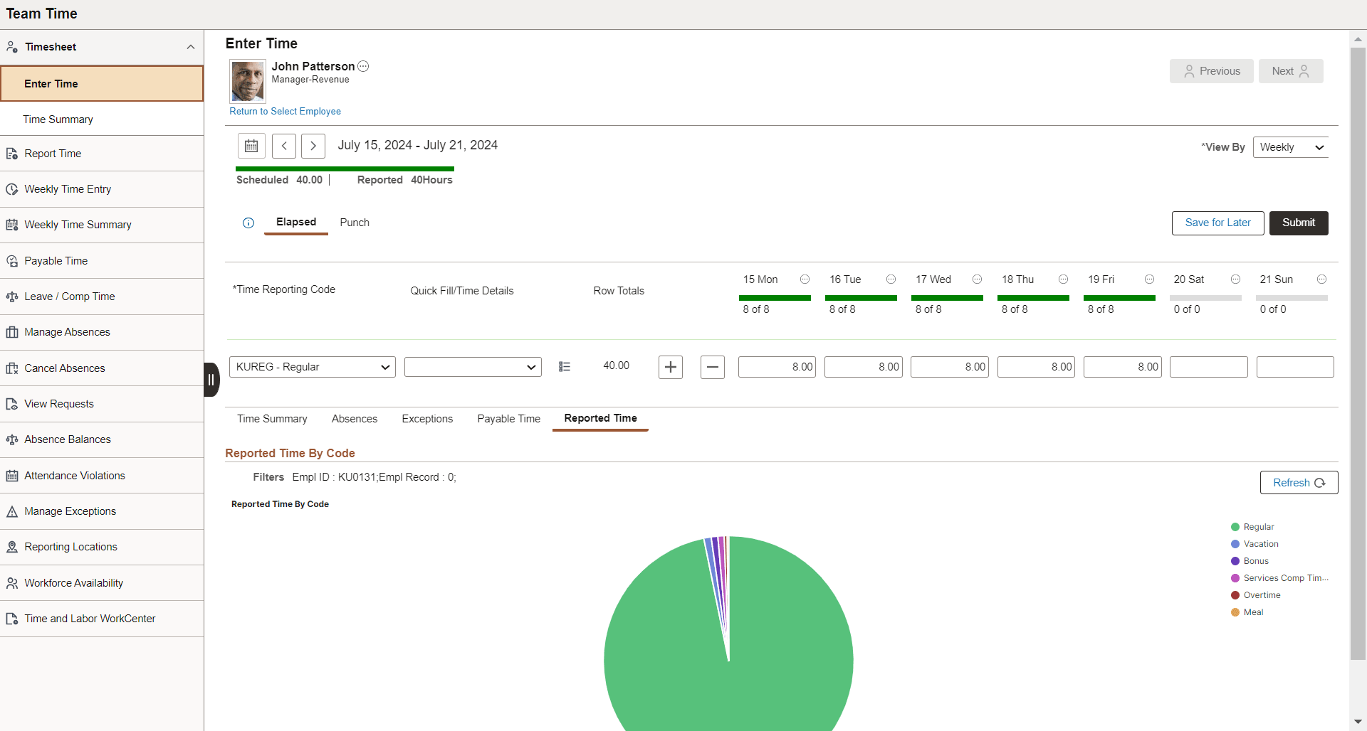

After you embed the dashboard, you can easily access and view the embedded dashboard in the transaction area of the application page.
This example illustrates the Applications Page after you integrate a dashboard.
Once you embed the dashboard, you can view the applied filters in your visualization. This allows you to refresh the visualization based on the filter values applied at runtime using the Refresh button. You can also change the dashboard at runtime based on your requirements using the delivered PeopleCode methods. For more information, see FilterValues Class Methods.

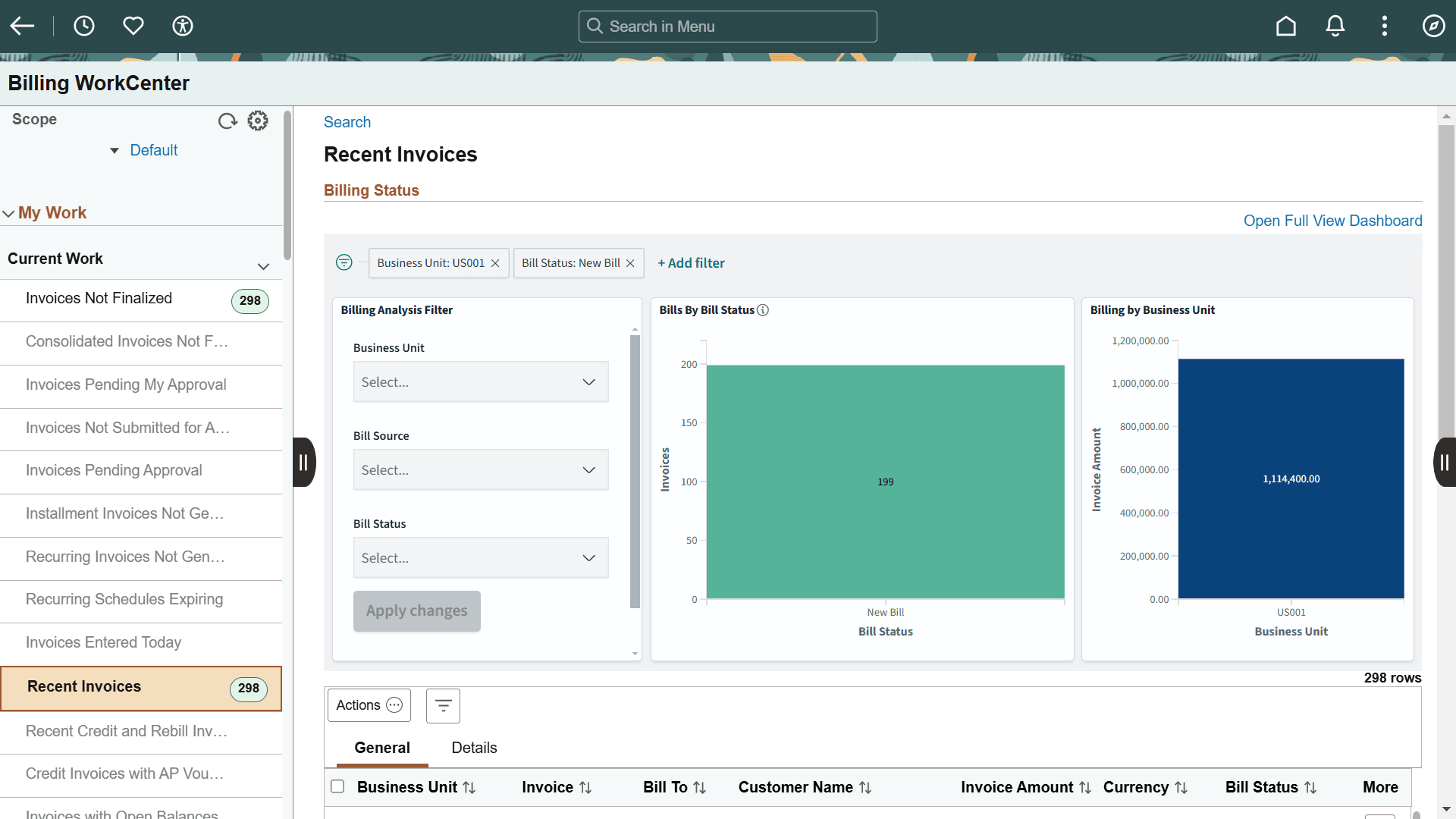

After you embed an interactive dashboard, you can easily access and view the embedded dashboard in the transaction area of the application page.
This example illustrates the Applications Page after you embed an interactive dashboard.
Once you embed an interactive dashboard, you can view the applied filters in your visualization. Additionally, the chart visualization, control visualization panel, and Add Filter link allow you to interact with the insights and apply filters.
Any change in the Insights triggers the PeopleCode associated with the control field, which then makes the necessary UI changes. The control field code allows you to fully control the interactive behavior.
Note: Each filter change in the dashboard triggers a server request, which subsequently refreshes the dashboard to retrieve the latest available data securely. For real-time indexing-enabled search definitions, the data update is real-time after every refresh. For best page performance, it is recommended to use only one interactive dashboard per page.
In certain scenarios, the dashboard refreshes after a filter change. This is due to a full refresh issued by the component processor instead of a partial page refresh.
Example of control field code.

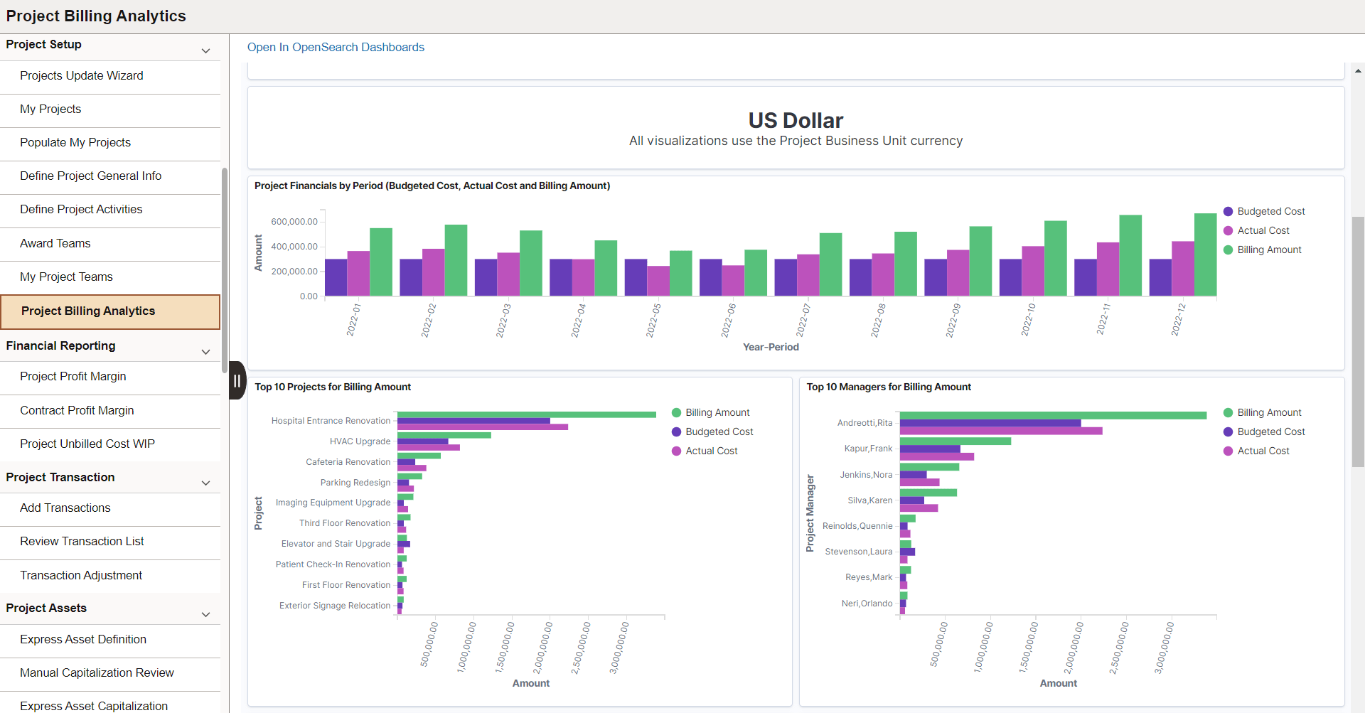

After you embed a dashboard in Fluid WorkCenter page, you can associate the newly created Insights CREF with your Fluid WorkCenter. Use the Configure Pagelets page to create links and activate the links for the CREF.
For more information, see PeopleSoft HCM 9.2: Application Fundamentals, “Understanding PeopleSoft Fluid WorkCenters”.
Use the following steps to associate a new CREF to Fluid WorkCenter using the Configure Pagelets page:
Select .
Choose the Fluid WorkCenter to which you want to associate the new CREF.
Associate the new CREF to Fluid WorkCenter.
After you add the new CREF, activate the link.
Save the page.
For more information, see PeopleSoft HCM 9.2: Enterprise Components, “Configuring Pagelets”.
This example illustrates the Fluid WorkCenter after you integrate a dashboard.
