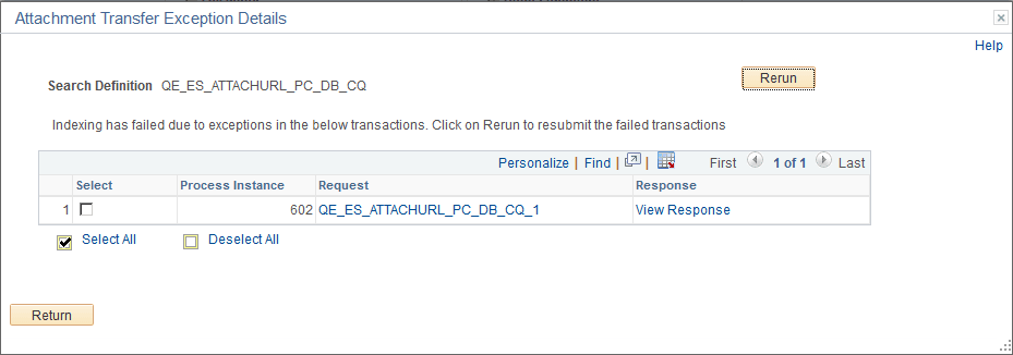

Click the Error link to display the Attachment Transfer Exception Details page.
This example illustrates the fields and controls on the Attachment Transfer Exception Details page. You can find definitions for the fields and controls later on this page.
Field or Control
Description
Process Instance
The process instance ID of the PTSF_GENFEED Application Engine program that is causing the exception.
Request
The request sent by the PTSF_GENFEED Application Engine program to the search engine.
Response
The response received by the PTSF_GENFEED Application Engine program from the search engine.
Rerun
Use the Rerun button to resubmit the selected error transactions to the search engine. The progress of the transaction can be monitored using the Process Monitor page on PIA. When a transaction is successful, it is deleted from the error pages.
In the case where the maximum exceptions limit is not reached, when you select the Rerun button:
  • The transaction is directly submitted to the search engine through the PTSF_GENFEED Application Engine program, but without executing the Connected Query program.
  • The request messages stored in error tables will be sent directly to the search engine.
In the case where the maximum exceptions limit is reached, the Rerun button acts as a re-submit of the PTSF_GENFEED Application Engine program.
After re-running the PTSF_GENFEED Application Engine program, if the transaction is not successful, the error tables are updated with the latest error message.

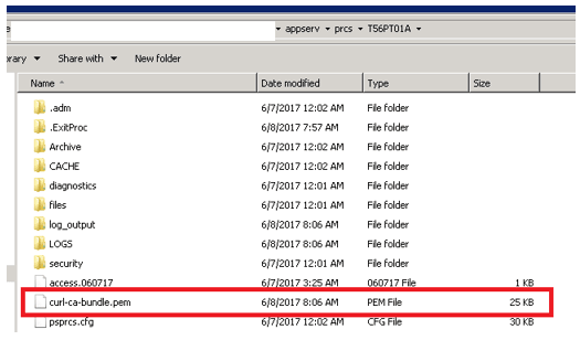

When the process starts, the certificate bundle in PEM format is available in the Process Scheduler server folder.
This example illustrates the certificate bundle in PEM format.
Certificate bundle in PEM format
