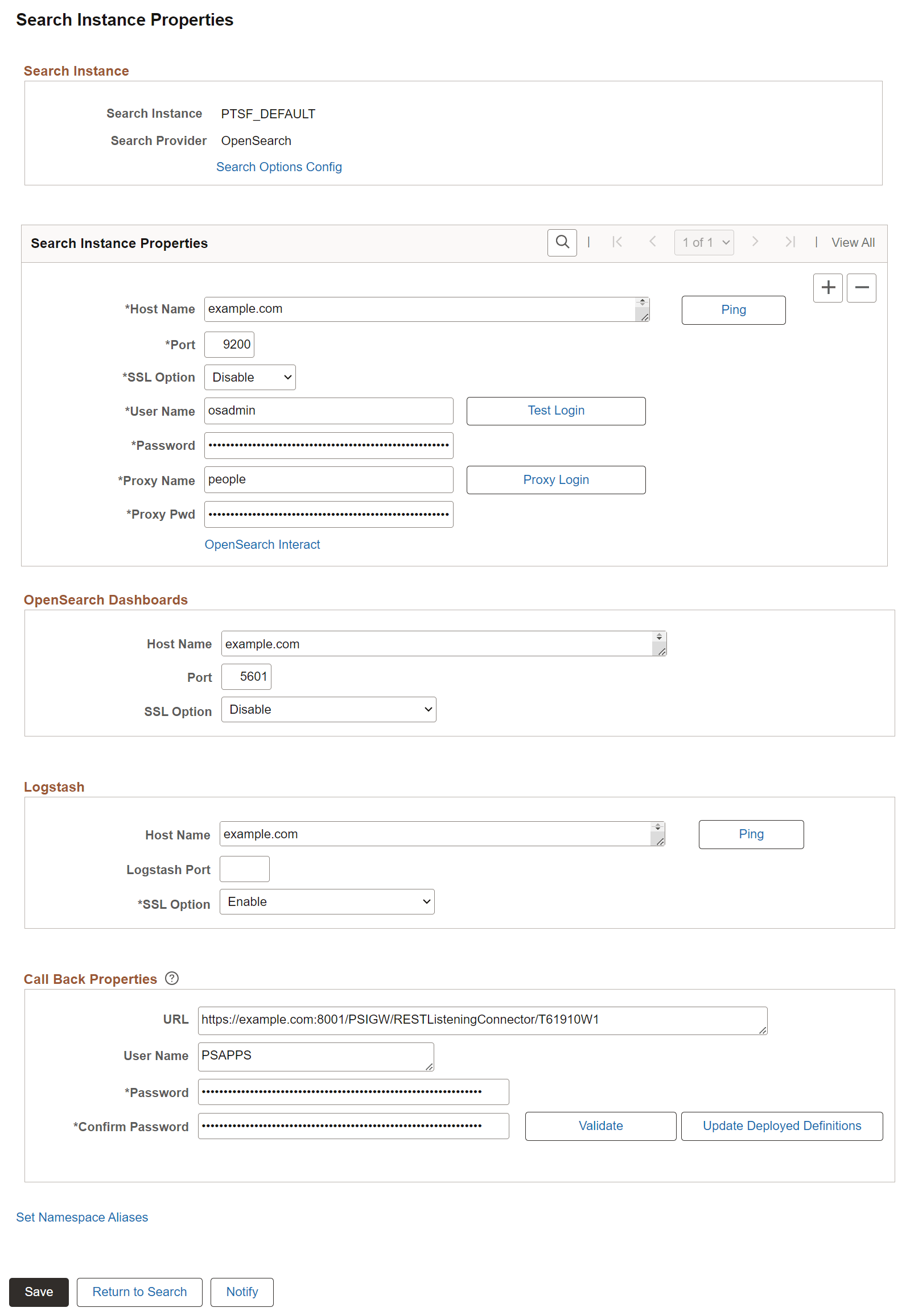

To define a search instance, access the Search Instance Properties page by selecting .
You can also define a search instance by using the SEARCH_TEMPLATE configuration template in Automated Configuration Manager (ACM). The steps to run the template are described later in this topic, see Creating a Search Instance in Automated Configuration Manager.
This example illustrates the fields and controls on the Search Instance Properties page. You can find definitions for the fields and controls later on this page.
Search Instance
To enable connectivity between your PeopleSoft system and the search engine, you need to provide these search instance values.
Field or Control |
Description |
Search Instance |
Enter a name for the search instance. Note: PeopleSoft Search Framework enables you to create multiple search instances for the purpose of fail-over mechanism. See Understanding High Availability Feature in PeopleSoft Search Framework and Implementing Fail-over Mechanism for more information. When you create multiple search instances, you can use the Search Instance Administration page to specify priority for each search instance. See Administering Search Instances. |
Search Provider |
OpenSearch is the default search provider. |
Search Options Config |
This section contains details for the user name and password used to connect to the search engine. These credentials are part of the authentication mechanism from PeopleSoft to the search engine. During an incoming search request, the search engine matches these credentials with values stored in the configuration file to authenticate the incoming search request.
Note: Use this section to add multiple nodes for an OpenSearch search instance by clicking the scroll bar plus button. Configuring multiple nodes enables you to use the fail-over mechanism when one of the nodes may go down for any reason. In a multi-node OpenSearch cluster, always ensure that the replica value is set to at least 1. For more information, see Implementing Fail-over Mechanism and Managing General Search Options.
Oracle PeopleSoft recommends setting up an OpenSearch cluster with three nodes on machines that are not on the same physical server.
For information on creating additional OpenSearch nodes, see Adding a New Node to an Existing Cluster.
Field or Control |
Description |
Host Name |
Enter the server name of the host where the search engine is running, including the domain. The host name value can be a DNS name or an IP address. For example: example.com |
Port |
Enter the port on which the search engine listens for requests. Note: The default port for OpenSearch is 9200. If a load balancer or reverse proxy is used between OpenSearch and PeopleSoft, the OpenSearch port number should be the same across all nodes in the cluster. |
SSL Option |
Select one of the options for SSL:
Note: The setup needs to be either all SSL or all non-SSL. A situation in which one component is in SSL and another is in non-SSL is not permissible. |
Ping |
Click to make sure your host name and port are correct and that the search engine is available. A positive result displays a success message. Ping Test Result: Success. opensearch version 2.11.0 (262,613) |
User Name |
Enter the user name to connect to the search engine. |
Password |
Enter the password associated with the user name. |
Test Login |
Click to test the credentials you have specified against the search engine. A positive result displays a success message. Login Success. (262, 615) |
Proxy User |
Enter a trusted entity. This enables the PeopleSoft system to log into the search engine using a proxy identity to run a query. This proxy account is a Trusted Entity. You may need to contact your administrator to obtain Trusted Entity credentials or to have those credentials created for the Search Framework query service. Important! Even though the Search Framework is authenticated by the search engine as the Trusted Entity, the search engine uses the identity of the currently signed on PeopleSoft user for query authorization. Note: Proxy User acts as an authentication user for every search request. |
Proxy Pwd |
Enter the password associated with the trusted entity. |
Proxy Login |
Click to test the credentials you have specified against the search engine. A positive result displays the success message. Login Success (262,615) |
+ (plus sign) |
Click the + (plus) sign in the grid to enter details of another node if you plan to implement fail-over mechanism. Note: Oracle PeopleSoft recommends a three-node cluster initially. Then, depending on the hardware, memory availability, and search performance, you may add nodes to the existing cluster. |
OpenSearch Interact |
Click this link to open the OpenSearch Interact page that enables you to choose the cluster and index level options on which you want to obtain information from the search engine. See Administering OpenSearch Using the OpenSearch Interact Page. |
OpenSearch Dashboards
This section contains details of the server where OpenSearch Dashboards is installed.
Field or Control |
Description |
Host Name |
Enter the server name of the host where OpenSearch Dashboards is running, including the domain. The host name value can be a DNS name or an IP address. For example, example.com Note: OpenSearch Dashboards can be installed on the same server as OpenSearch or on a separate server. Oracle recommends that you install OpenSearch Dashboards on one of the OpenSearch nodes in the cluster to ensure better connectivity between OpenSearch and OpenSearch Dashboards. |
Port |
Enter the port on which OpenSearch Dashboards listens for requests. Note: The default port for OpenSearch Dashboards is 5601. Note: The application requires an open port to directly access Insights in the PeopleSoft. You can disable the firewall for the OpenSearch Dashboards port in which it is installed. |
SSL Option |
Note: The setup needs to be either all SSL or all non-SSL. A situation in which one component is in SSL and another is in non-SSL is not permissible. For more information, see Configuring SSL for OpenSearch Dashboards. |
Logstash
This section contains details of the server where Logstash is installed.
Field or Control |
Description |
Host Name |
Enter the server name of the host where Logstash is running, including the domain. The host name value can be a DNS name or an IP address. For example, example.com. |
Logstash Port |
Enter the port on which Logstash listens for requests. Note: The default port for Logstash is 9800. |
SSL Option |
Ping |
Click to make sure your host name and port are correct and that the search engine is available. A positive result displays a success message. |
Call Back Properties
The callback properties are used to perform a callback to PeopleSoft to fill in data such as search attribute values, so you need to provide the URL and password for this access.
Note: PeopleSoft Search Framework uses the REST ListeningConnector for callback.
Field or Control |
Description |
URL |
Enter the URL for the PeopleSoft system listening connector, using the following syntax. http://<server>:<port>/PSIGW/RESTListeningConnector/<node> Note: If the callback URL is https and if SSL is not configured on OpenSearch, then the PeopleSoft root CA needs to be installed in the OpenSearch truststore and the truststore path and password should be specified in the opensearch.yml configuration file. If OpenSearch is behind a load balancer and the setting is to terminate SSL at load balancer, the orclssl.callback property should be set to false in the opensearch.yml configuration file. |
User Name |
Enter the PeopleSoft user name granted the permission list PTPT3300. This user must have the Search Server and Search Query Administrator roles. Note: This user name must exist as an active user profile on the PeopleSoft system listed in the URL specified. This is generally a system user as opposed to an interactive user. In addition, if you have attachments on an FTP server that will be accessed by the search engine, this user must also be authorized to access the FTP site. |
Password\Confirm Password |
Enter and confirm the password associated with the PeopleSoft user name. |
Validate |
Click to validate the URL, service operations, and credentials you have entered. A positive result displays the following message on the Validation Report page: All validations are successful. The following service-operation validations are performed to confirm:
Update deployed definitions |
Click this link to invoke a bulk update for all definitions currently deployed to the search engine. If you have changed any of the callback properties (URL, user name, or password), all currently deployed search definitions need to be updated with the new callback values to continue successful interaction with the Search Framework. |
Set Namespace Aliases |
Click this link to set namespace aliases when you clone an environment. See Setting Namespace Aliases for more information. |
Save |
When you save a search instance, OpenSearch creates an orcl_es_auth index that stores the callback service URL for each PeopleSoft database. When a user accesses OpenSearch Dashboards in PeopleSoft, the user is authenticated using the callback service request to the orcl_es_auth index of a specific database. |
You can modify any of the search instance values if the information changes for the specified server. That is, if the server receives a new IP address or a new DNS name, if the port for the search services changes, or if any credentials change, then the values can be updated as needed.

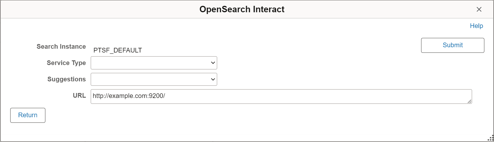

OpenSearch provides several REST APIs that can be used to obtain details of a cluster or index in the PeopleSoft implementation. In the absence of a default user interface to administer OpenSearch, PeopleSoft provides a user interface (called OpenSearch Interact) that enables you to choose the cluster and index level options on which you want to obtain information from the search engine. Based on the selected options, PeopleSoft Search Framework generates a URL, which is submitted to OpenSearch, and the response is displayed on the OpenSearch Interact page. The OpenSearch Interact page is accessible from the Search Instance Properties page, and it provides administration requests only for those cluster and index validations that are exposed by PeopleSoft.
Access the OpenSearch Interact page () by selecting an OpenSearch search instance, and then selecting the OpenSearch Interact link on the Search Instance Properties page.
This example illustrates the fields and controls on the OpenSearch Interact page (initial). You can find definitions for the fields and controls later on this page.

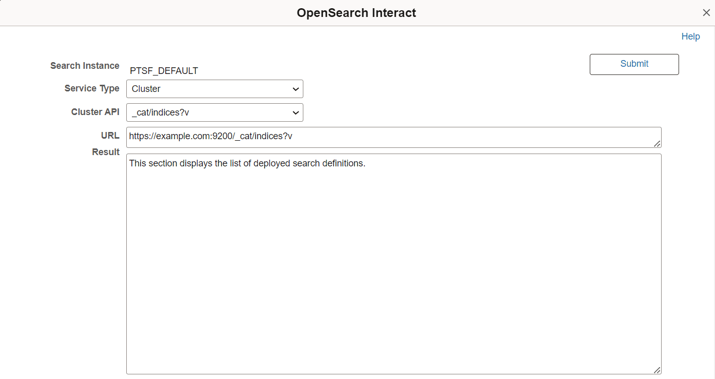

This example illustrates the fields and controls on the OpenSearch Interact page after selecting an option from the Service Type drop-down list. You can find definitions for the fields and controls later on this page.
Field or Control |
Description |
Search Instance |
The search instance name. |
Service Type |
Displays a list of service type groups. The following service type groups are available:
Suggestions |
The Suggestions field displays on the initial OpenSearch Interact page and it changes based on the service type you select. The Suggestions field changes to the following:
Method |
The Method field is displayed when the service type is Search. Choose the type of HTTP request that needs to be issued to the search server. Valid options are:
URL |
The URL is automatically formed based on the selected options. For example, if you select Cluster as service type and select cat/indices as the cluster API, the URL is automatically formed: http://example.com:9200/_cat/indices?v Note: The URL cannot be modified. To modify the URL, you need to change the options you have selected. |
Body |
The Body field appears when you select POST as a method. This field must contain a JSON request. The contents of the Body field are passed along with the request to the search engine. |
Result |
The Result area displays the response from the search engine for each request. PeopleSoft Search Framework displays the response from the search engine as is. |

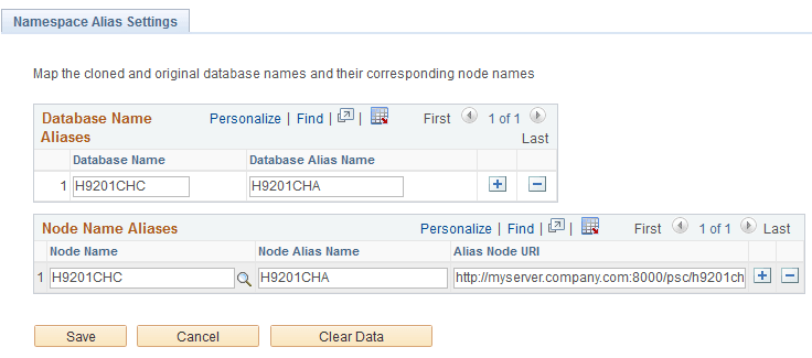

Namespace aliasing enables you to re-use an index or indices built on an environment (original environment) on another environment (which is referred to as “new environment” for purpose of differentiation), thus avoiding the necessity to re-index the same search definitions on the new environment. The namespace aliasing feature is handy when you need to clone environments or when the middle-tier changes.
When you need to clone an environment, for example, you clone a test FSCM environment (FSCMTEST), where all the search definitions in FSCMTEST are already indexed to a search server, as a staging FSCM environment (FSCMSTAGING), you can re-use the index or indices of FSCMTEST from the FSCMSTAGING environment that is connected to the same search server by setting up namespace aliasing.
When the Application server or Web server changes, but is connected to the same database, you can use namespace aliasing to map the new environment to the original environment and thus re-use the index or indices of the original environment.
The namespace aliasing feature enables you to map the database name, node name, and node URI of the new environment to the original environment where the indices are built. The new environment re-uses the indices on the original environment, so users can perform search in the new environment without having to wait for indices to be built. Also, you can perform incremental indexing to update the indices from the new environment.
You can use the Namespace Alias Settings page to set namespace aliasing or you can use the PTSFConfigureSearch plug-in in Automated Configuration Manager to set namespace aliasing.
Access the Namespace Alias Settings page by selecting . Then click the Set Namespace Aliases link.
Alternatively, access the Namespace Alias Settings page by selecting .
This example illustrates the fields and controls on the Namespace Alias Settings page. You can find definitions for the fields and controls later on this page.
Field or Control |
Description |
Database Name |
The name of the database in the new environment. You may enter the same database name as in the original environment. |
Database Alias Name |
The name of the database in the original environment. |
Node Name |
The name of the node in the new environment. You may enter the same node name as in the original environment. |
Node Alias Name |
The name of the node in the original environment. |
Alias Node URI |
The node URI in the original environment. When you enter the URI, follow this syntax: http or https://<hostname>:<port>/psc/<sitename>/ Optionally, you can copy the URI entered for the node in the Content URI Text edit box on the Node Definitions page (Portal tab). |
Clear Data |
Clears the data entered on the page and also removes it from the database. |

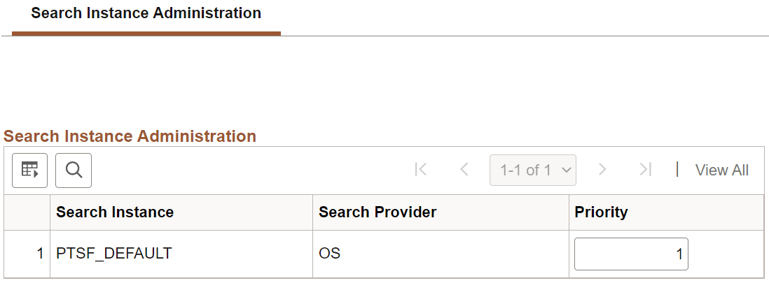

To administer search instances, access the Search Instance Administration page by selecting .
Search administrators can use the Search Instance Administration page to specify the priority for each search instance.
This example illustrates the fields and controls on the Search Instance Administration page. You can find definitions for the fields and controls later on this page.
Field or Control |
Description |
Search Instance |
Lists the search instances created in PeopleSoft Search Framework. |
Search Provider |
Lists the search provider associated with a search instance. |
Priority |
Allows Search administrators to set the sequence in which the available search instances are to be used when any of the search instances fail. The lowest number is 1 and it has the highest priority. The search instance with the priority set at the lowest number has the highest priority, and it will be set as the default search instance. When you create a search instance on the Search Instance Properties page, the new search instance is assigned a sequence number. You can use this page to specify the sequence that you want. |

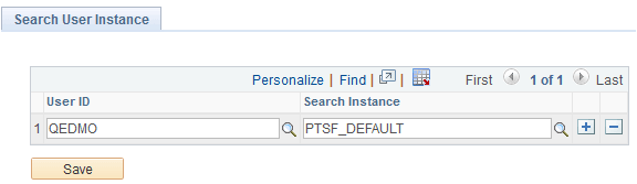

When you deploy an index on a new search instance, you may want to validate or test the index before you roll out the index in a production environment. Search administrators can use the Search User Instance page to assign users to a search instance on which the deployed index needs to be validated or tested.
Note: When you assign a user to a search instance using the Search User Instance page, you override the priority setting specified on the Search Instance Administration page for the particular user.
To assign users to a search instance where a deployed index needs to be validated or tested, access the Search User Instance page by selecting .
This example illustrates the fields and controls on the Search User Instance page. You can find definitions for the fields and controls later on this page.
Field or Control |
Description |
User ID |
Select a user to whom you want to assign the task of validating or testing an index that is deployed. |
Search Instance |
Select a search instance where you have deployed an index, which needs to be validated or tested before deploying the index to a production environment. |
Note: You would use this page to test new search instances as they come online. It does not need to be specified for all users.
