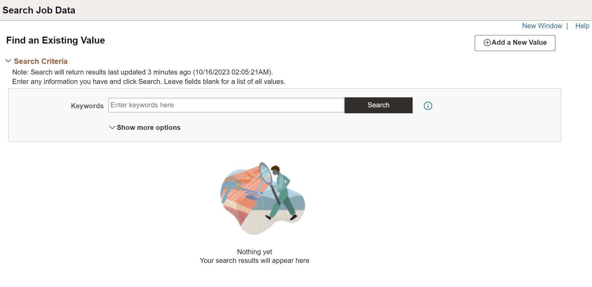

The Keyword search page (real-time indexing is not enabled) displays a message indicating how fresh the search results are. For example:
Note: Search will return results last updated 5 hours ago.

The Keyword search page (real-time indexing is enabled) does not display any message to indicate how fresh the search results are because the search results are near real time.

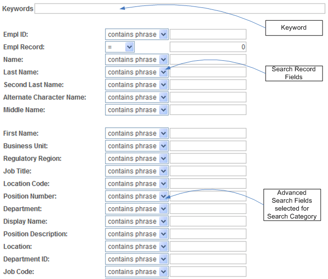

Working with Advanced Mode
The advanced mode displays all search criteria:
Keywords.
Search record fields.
Search fields defined for the Search Framework search category on the Advanced Search Fields tab.
The following illustration depicts the controls on the advanced search page and their association.
Note: The system does not display in the Advanced Search Fields list any search fields that are also displayed in the search record search field list.
