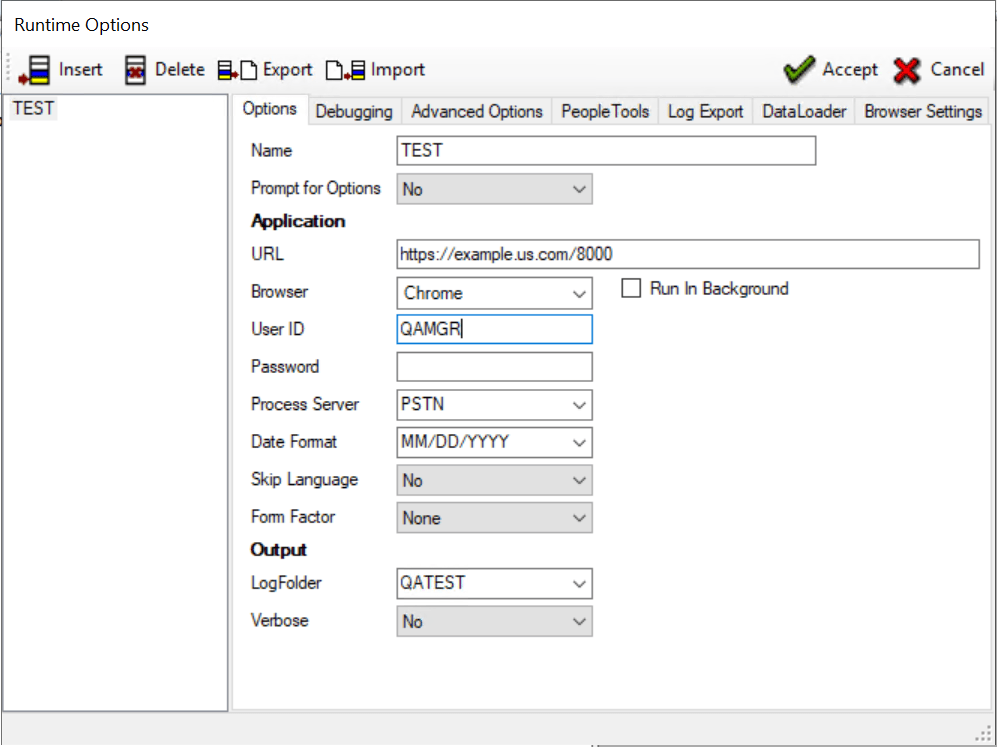

Use the Options tab to define the application settings and log output options to use during PTF test runtime.
This example illustrates the fields and controls on the Runtime Options dialog – Options tab. You can find definitions for the fields and controls later on this page.
The following fields are on the Options tab:
Term |
Definition |
Name |
Enter a name for this runtime option. |
Prompt for Options |
Specify whether the Runtime Options dialog appears when a user runs a test. |
URL |
Enter the URL of the login page for the PeopleSoft application. PeopleSoft Test Framework uses this URL for the Browser.Start_Login step type/action when running tests and when you click the Home icon (to start the web client and go to the default URL) in the test recorder. If the URL that is specified is not a standard PeopleSoft login page, PeopleSoft Test Framework will try to determine the UserID and Password fields, and set their values accordingly. If that fails, PeopleSoft Test Framework will log a fatal error message. In that case you should use Browser.Start and the explicit steps required to log in, instead of using Browser.Start_Login. |
Browser |
Specify a browser to record or playback any test script. The options are Chrome, Microsoft Edge, and Firefox. For test playback, you can use all these options. For recording test script, PTF is designed in such a way that it launches:
Chrome is the default value for browser. If you continue with the default value, the recording and test playback will happen in Chrome. |
Run In Background |
This option is enabled for Chrome and Microsoft Edge browsers to run it in headless mode. Select this option to run the browser window in the background so that the log viewer of PTF client is in the foreground for the user to monitor the test status. You can also set this option through command line. |
User ID |
Enter a valid user ID for the application database. |
Password |
Enter the login password for the user. |
Process Server |
Select a process server from the drop-down list. This list is populated by the Process Server List field in the Configuration Options page. |
Date Format |
Select a date format. |
Skip Language |
Select Yes to bypass the language selection on the PeopleSoft application login page. |
Form Factor |
Select the form factor size to use when launching the application. At test runtime, the form size that you specify is selected on the login page, and a new browser instance will open using that size. The test will continue to execute in the new browser instance. |
LogFolder |
Select or enter the folder name to which test logs will be written. If the folder does not exist it will be created. |
Verbose |
Specify the log format. Select Yes to log a detail line for each step that is executed in the test. Select No to log only the test status (Pass or Fail) at the test level and to log a detail line for failed steps. |

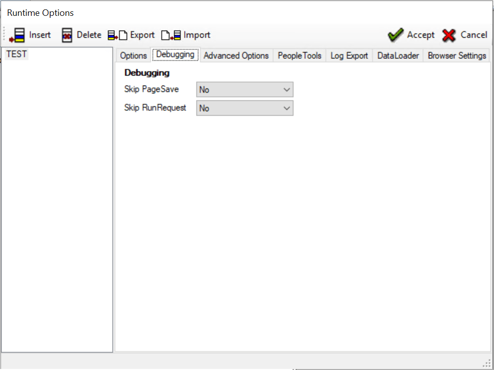

Use the Debugging tab to specify how PTF should manage page saves and run requests during test runtime.
This example illustrates the fields and controls on the Runtime Options dialog - Debugging tab. You can find definitions for the fields and controls later on this page.
The following fields are on the Debugging tab:
Term |
Definition |
Skip PageSave |
Select Yes to prevent a test from running a save. You would, for instance, select this option to avoid duplicate values in the application database if you plan to run a test repeatedly. |
Skip RunRequest |
Select Yes to prevent the test from running process requests. |

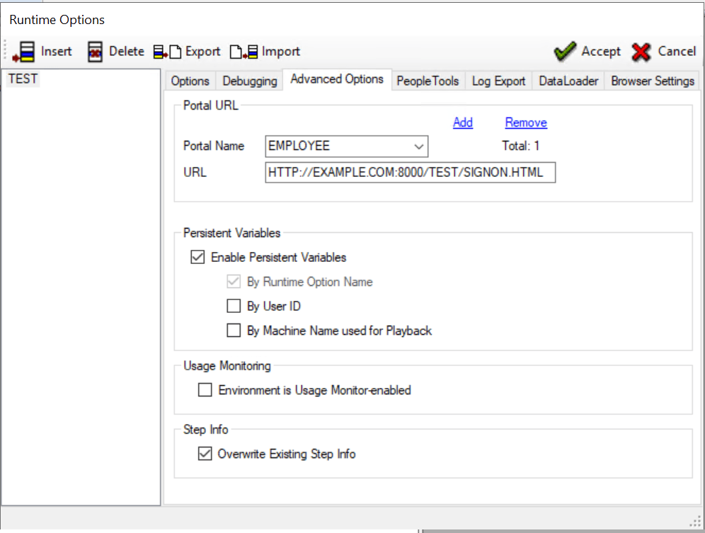

Use the Advanced Options tab to specify the information required to connect to multiple portal URLs and to enable persistent variables.
This example illustrates the fields and controls on the Runtime Options dialog – Advanced Options tab. You can find definitions for the fields and controls later on this page.
The Portal URL is used to access the component when there is a step in the test to set the browser URL (Browser.Set_URL). See Set_URL. To add a portal URL, click the Add link. To remove a portal URL click the Remove link.
The following fields are on the Advanced Options tab:
Term |
Definition |
Add and Remove |
Click to add or remove a Portal definition, then complete the Portal Name and URL fields. |
Portal Name |
Enter a valid portal name or select from a list of previously added portal names. Note: The name is saved in upper case. |
URL |
Enter the portal URL. The portal URL is entered in the following format:
For example: http://myserver.example.com:8010/psp/ps/EMPLOYEE/QE_LOCAL/ Note: The ending backslash / is optional |
Enable Persistent Variables |
Select to enable saving and using persistent variables. Selecting this option enables the other fields in this group. |
By Runtime Option Name |
This option is automatically selected when you select the Enable Persistent Variables check box. Persistent variables are stored in the database keyed by runtime option name. Persistent variables can also be keyed by User ID, machine name or both. |
By User ID |
Select to store and retrieve persistent variables by PTF user ID. |
By Machine Name Used for Playback |
Select to store and retrieve persistent variables by machine name. |
Environment is Usage Monitor-enabled |
Select this option to enable managed object tracking with usage monitor during test runtime. When this option is selected, PTF passes the test and test case values as parameters to the usage monitor during test runtime when it encounters the Usage Monitor step type. When this option is not selected, if a test includes a Usage Monitor step type, then PeopleSoft Test Framework writes a warning to the log and skips the step. This enables you to run a test on environments with and without usage monitor enabled, without having to modify the test between runtime. Note: The PeopleSoft application must be properly configured for Usage Monitor if you select this option. For more information about configuring Usage Monitor, see Enabling Usage Monitor. For more information about the Usage Monitor step type, see UsageMonitor. |
Overwrite Existing Step Info |
Select the option Overwrite Existing Step Info which will allow PeopleSoft Test Framework to update step information according to actual data of completed or ongoing tests from the environment. If the option is not selected, then only the missing step information is filled out. For more information on Step Information, see Using Step Information. |

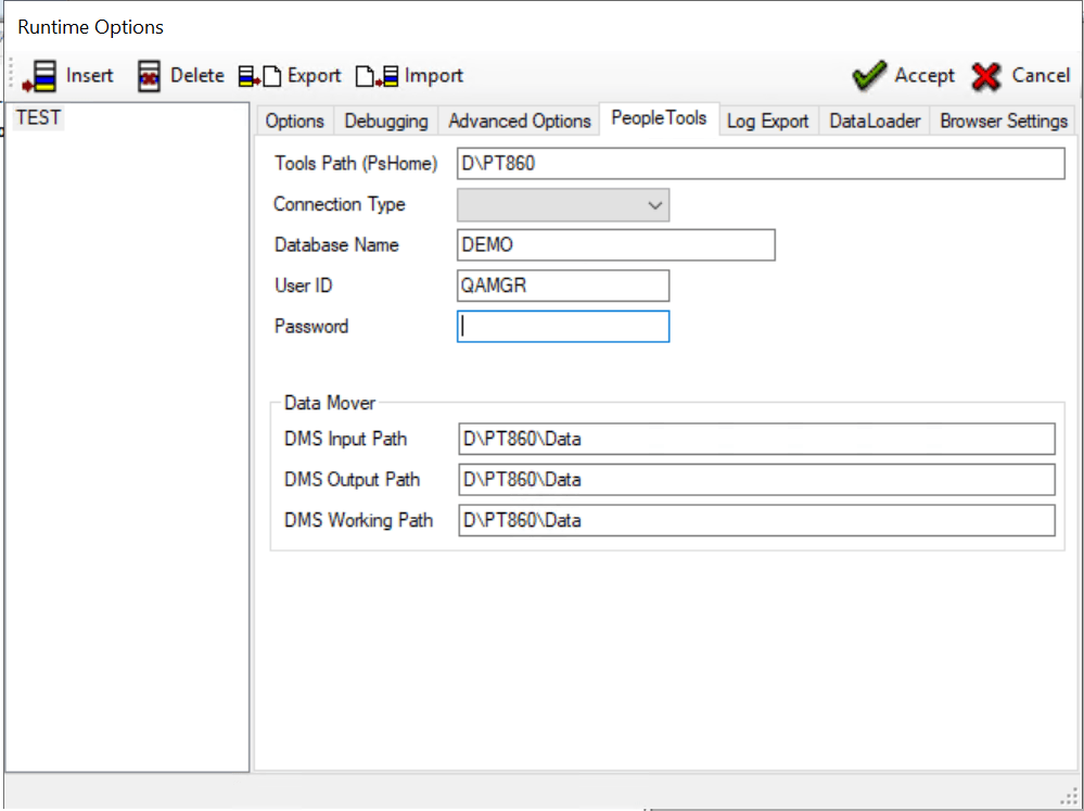

Use the PeopleTools tab to provide the information required to connect to DataMover.
This example illustrates the fields and controls on the Runtime Options dialog – PeopleTools tab. You can find definitions for the fields and controls later on this page.
The following fields are on the PeopleTools tab:
Term |
Definition |
Tools Path (PsHome) |
Enter the path to PS_HOME for this environment. |
Connection Type |
Select the connection type. |
Database Name |
Enter the name of the database for this environment. |
User ID |
Enter a valid database user ID. |
Password |
Enter the password for this user. |
DMS Input Path |
Enter the DataMover input path. |
DMS Output Path |
Enter the DataMover output path. |
DMS Working Path |
Enter the DataMover working path. |

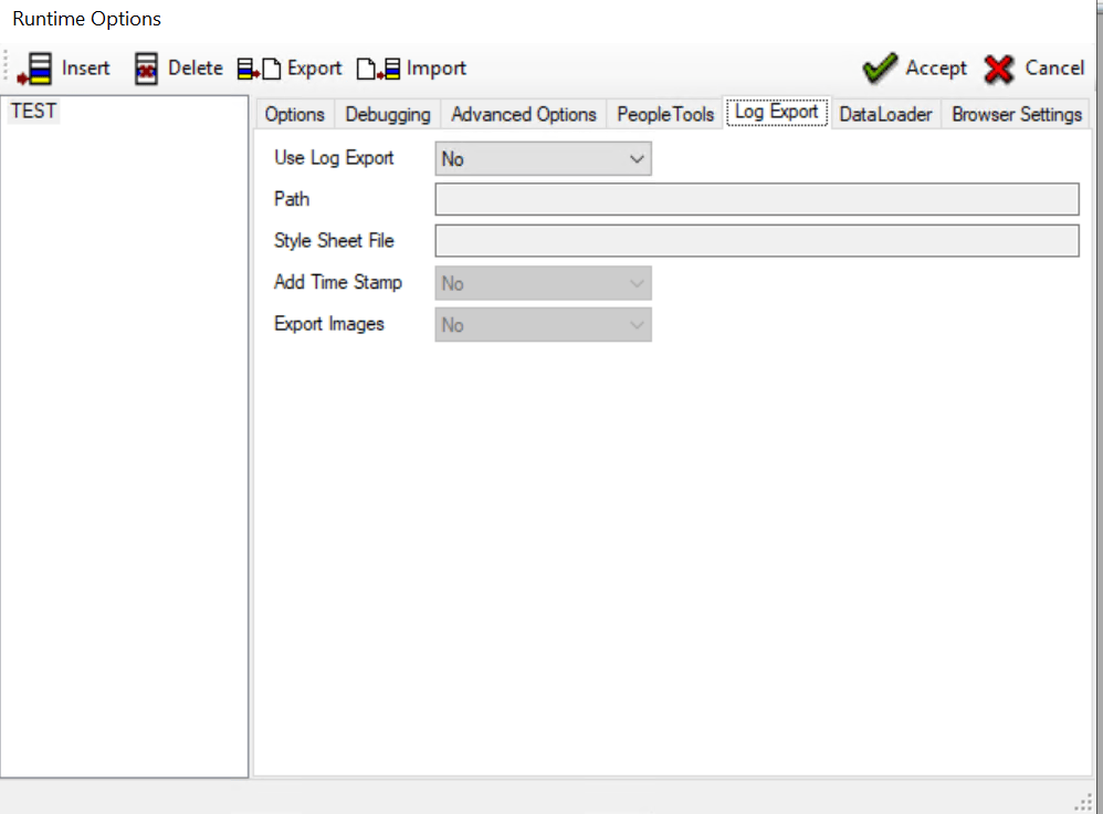

The Log Export tab allows you to archive the result logs to a file system in XML + XSL format at the end of each test runtime, which provides the following benefits:
The logs are accessible from any browser.
The PTF client is not required to verify test results.
The logs are available even after the environment or database is brought down or upgraded.
Since the log is in XML format, you can write customized utilities to parse or interpret the logs as needed.
This example illustrates the fields and controls on the Runtime Options dialog - Log Export tab. You can find definitions for the fields and controls later on this page.
Term |
Definition |
Use Export Log |
Select Yes to activate the export log functionality. |
Path |
Specify the shared drive to store the log files. Note: Ensure that the shared drive path allows users full read/write access. The path can be customized using existing system variables. See System Variables |
Style Sheet File |
(Optional) Specify the path to the stylesheet. If specified, the exported XML log will be saved with the stylesheet. You can create your own stylesheet to format the XML. If this field is left blank, the XML will not be saved with a stylesheet. Note: Ensure that the shared drive path allows users full read/write access. The path can be customized using existing system variables. See System Variables |
Add Time Stamp |
If set to Yes the XML filename will be appended with the Time Stamp in the following format: <TEST_NAME>-<LOG_ID>-T<YYYYMMDD>_<HHMMSS> Example: FSCM_INS_VER-LOG5-T20121128_163649.XML |
Export Images |
If set to Yes the Image will be saved in the same Log folder as the XML Log in the following format: <TEST_NAME>-<LOG_ID>-T<OPTIONAL_TIME_STAMP>-<LINE_NUMBER_AS_SHOWN_IN_LOG> Example: FSCM_INS_VER-LOG5-T20121128_163649-Line30.JPEG |

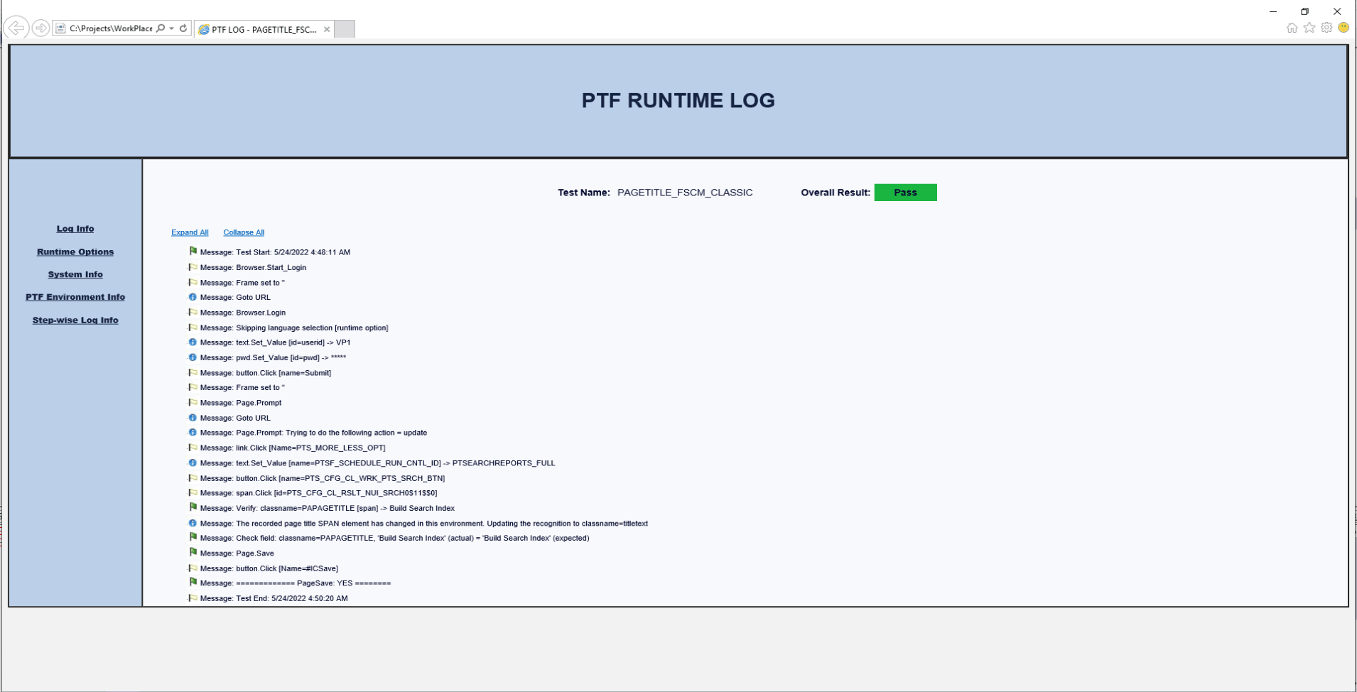

This example illustrates an exported log file using customized stylesheet.

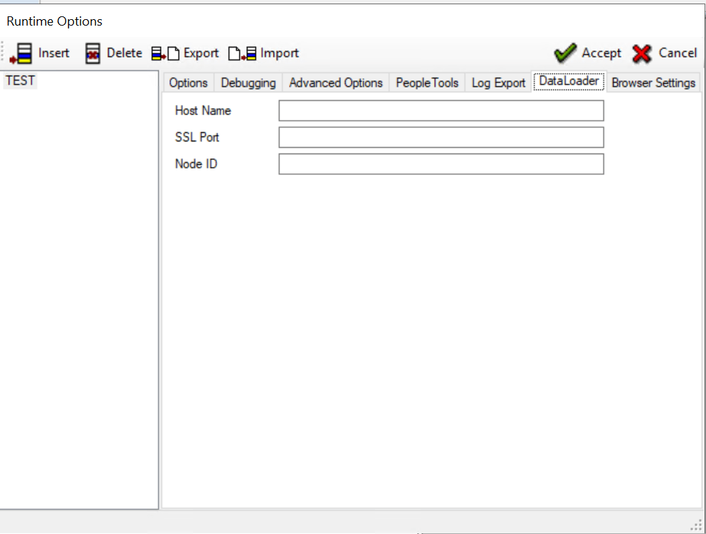

Use the DataLoader tab to enter configurations information similar to PTF login screen.
Term |
Definition |
Host Name |
Enter the deployment host name. |
SSL Port |
Enter the SSL port of the server in the current Runtime Options. |
Node ID |
Enter the node ID added to the current Runtime Options. This field is required if more than one database is connected to the server. Enter the name of the PeopleSoft node with which the integration gateway is to communicate. Contact your Integration Broker administrator or system administrator for the correct values. |
