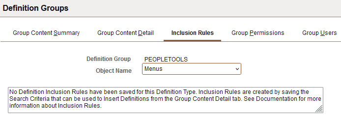

Use the Inclusion Rules page (PTDEFSECINRL) to manage inclusion rules, including viewing, modifying, and deleting them.
To access the page:
Select
The Definition Groups Search page appears.
Search for a definition group or add one to the system.
The Group Content Summary page appears.
Click the Inclusion Rules tab.
This example illustrates the fields and controls on the Inclusion Rules page for a definition object for which no inclusion rules have been defined. You can find definitions for the fields and controls later on this page
The previous example shows the Inclusion Rules page when no inclusion rules have been defined for an object name (definition type).

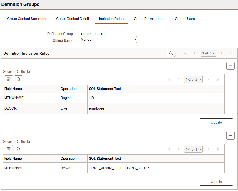

This example illustrates the fields and controls on the Inclusion Rules page when inclusion rules are defined for a definition object. You can find definitions for the fields and controls later on this page.
The previous example shows the Inclusion Rules page when inclusion rules are defined for an object name (definition type).

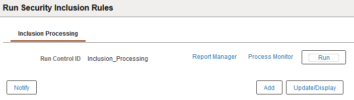

Use the Inclusion Processing page (PTDEFSECINRL_P) to launch inclusion rule processing on the database.
To access the page select
Enter a run control ID or select an existing one.This example illustrates the fields and controls on the Inclusion Processing page. You can find definitions for the fields and controls later on this page.
Field or Control |
Description |
Run Control ID |
This field displays the Run Control ID from the Search Dialog. |
Report Manager |
Click the link to access Report Manager to view report information after you run the process. |
Process Monitor |
Click the link to access Process Monitor to monitor the status of the process. |
Run |
Click the button to access the Process Scheduler Request page to start inclusion processing. |
