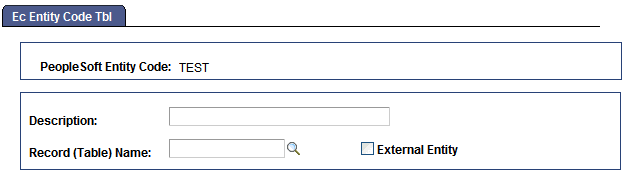

To access the Ec Entity Code Tbl (Entity Code Table) page. select
This example illustrates the fields and controls on the Ec Entity Code Tbl page.
You define entity codes for the types of business entities that serve as trading partners. Internally, the entities are usually business units. Use this page to specify the type of business entity to which the code applies and which table in the PeopleSoft database lists valid entities of this type.
To define a PeopleSoft entity code:
Select the record definition for the table that lists valid entities of this type.
Select the prompt table for this type of entity from the Record (Table) Name field. For example, if you are defining an entity code for business units, specify the table that holds business unit IDs.
Specify whether this entity code applies to external trading partners.
You need to identify entity codes both for your internal business entities and for the external companies that you trade with. For example, you will probably want to create entity codes based on the Vendor table and the Customer table.
If the entity code that you are defining is for external companies, select the External Entity check box.

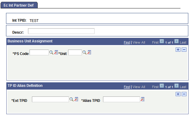

To access the Ec Int Partner Def (Internal Partner Definition) page, select
This example illustrates the fields and controls on the Ec Int Partner Def page.
You assign trading partner IDs to the internal entities (business units) that external trading partners need to be able to submit transactions to. Because of the way each PeopleSoft Financials application tracks its own set of business units, a single trading partner ID can refer to multiple business unit IDs, all of which actually refer to the same physical business unit. Use this page to specify which internal business entities share this partner ID and which external trading partners do business with this partner.
To create an internal partner ID:
Specify to which business entity or entities this trading partner ID applies.
In the PS Code field, select the entity code for the type of business entity, and then select the specific entity in theUnit field.
Because the same business unit can be referred to by different business unit IDs in different PeopleSoft Financials applications, you can add multiple units to the same trading partner ID.
Specify which external trading partners work with this internal trading partner, and what name they use to refer to the internal partner.
In the Ext TPID field, select the name of an external trading partner that does business with the internal partner that you are defining. Then, in theAlias TPID field, enter the name by which the selected external partner refers to the internal partner, that is, the text that will appear in the Internal Trading Partner field in PeopleSoft business documents.
Note: If you haven’t defined your external trading partners yet, you’ll need to return to this page after you add them.
Repeat this procedure for each external trading partner.

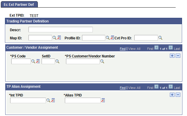

To access the Ec Ext Partner Def (External Partner Definition) page, select .
This example illustrates the fields and controls on the Ec Ext Partner Def page.
You’ll need to find out from the trading partner or from the VAN what trading partner ID to use.
To add an external trading partner:
Select the map profile that includes the mappings that this trading partner uses.
Select the appropriate map ID from the list of valid map profile IDs.
Select the partner profile that identifies the transactions that this partner can perform.
Select the appropriate partner profile ID from the list of valid IDs.
(Optional.) Select the conversion data profile that specifies how to translate this partner’s codes into PeopleSoft codes.
Select the appropriate conversion data profile ID from the Cvt Pro ID field.
Specify the customer ID, vendor ID, or other ID for this trading partner.
Note: If you exchange transactions with multiple business entities inside this trading partner, you’ll need to define the partner’s external business entities. If you define external business entities, each one needs to have its own unique customer ID, vendor ID, or other ID. The ID that you assign here should be the ID for the corporate office.
In the PS Code field, select the entity code for the type of entity this partner is: customer, vendor, and so on. If your system uses table set processing, select the setID for the Customer or Vendor table in theSetID field. In thePS Customer/Vendor Number field, select the specific value from the Customer or Vendor table that corresponds to this trading partner.
If different tables in the system refer to this trading partner by different names, you can list all the IDs as part of the trading partner definition.
Identify the internal trading partners who do business with this external trading partner.
In the Int TPID field, select the name of an internal trading partner that does business with the external partner you are defining. Then, in theAlias TPID field, enter the name by which the new external partner refers to the selected internal partner, that is, the text that will appear in the Internal Trading Partner field in the PeopleSoft business documents.
Repeat this step for each internal trading partner.
