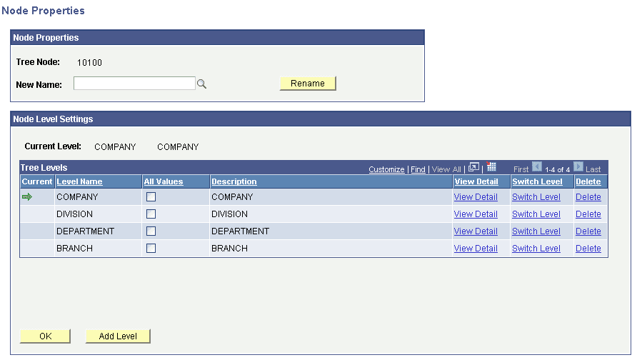

Use the Node Properties page (PSTREENODELEVELS) to change node levels, change node properties, and rename nodes.
Navigation:
Select
Search for an existing tree or create a new one.
Select a node on the Tree Manager page and click the Update Node Properties icon.
This example illustrates the fields and controls on the Node Properties page.
In the Node Properties page, click the Switch Level link associated with the level to which you want to change the node. Then the node level information is updated and changed. The node level is indicated by the green arrow.

Access the Node Properties page by selecting a node in the Tree Manager page, and clicking the Update Node Properties icon.
Enter new name for the node in the New Name text box and click the Rename button.
