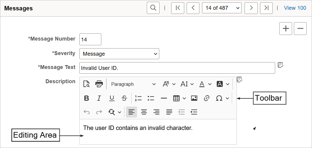

The Messages scroll area contains an example of the rich text editor control showing the toolbar and editing area elements:
This example shows the rich text editor controls.
Toolbar
The toolbar, which is the area at the top of the editor, contains many different buttons that extend and activate a variety of editor functions. The toolbar is highly personalizable and can vary from field to field.
Editing Area
The editing area is directly below the toolbar. You enter text in this area.

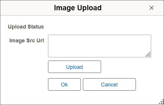

To insert an image into the text, click the Image button. The maximum image size is database dependent. Some database platforms support large image sizes while others limit the size to 32000 bytes. Consult your database documentation for more information. Use the Image Upload dialog box to upload an image file.
Uploading an Image
Access the Image Upload dialog box (click the Image button).
The following image types are supported: JPG, BMP, GIF, PNG, and SVG.
This example illustrates the fields and controls on the Image Upload dialog box.
When you select the Upload button, the File Attachment dialog box appears.
Select the Browse button to locate the file that you want to insert into the text.
Select the Upload button to send the image to the database.
On successful completion of the upload process, the Image Src Url field is automatically populated with the URL ID for the image.
