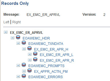

The Integration Broker message created for EMC needs to be a rowset-based message that includes the EMC records listed in this table:

 EOAWEMC_HDR  |
 0  |
 Header record for EMC.  |
 EOAWEMC_TXNDATA  |
 1  |
 Transactional data record for EMC.  |
 EOAWEMC_PROMPTS  |
 1  |
 Prompting record for EMC. Application will add records for the specific prompt action.  |
 EOAWEMC_ERRORS  |
 1  |
 Error record for EMC.  |
The application transaction record structure is added at level 2 under EOAWEMC_TXNDATA.
This example shows the Record Only view for a message created to approve expense reports. In this example, the application records that contain transactional data start with EX_EMC.
This example illustrates the fields and controls on the Records Only view of a message used for EMC. You can find definitions for the fields and controls later on this page.
