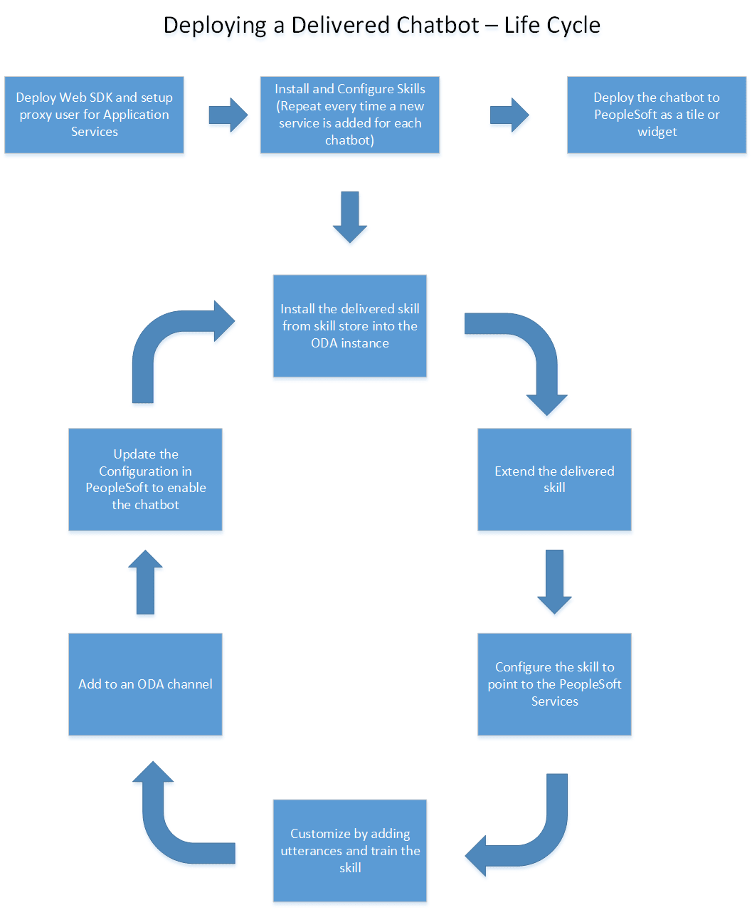

Extend it and configure the integration parameters. Whenever new skills are delivered or new services are introduced, the process of installation and configuring needs to be repeated. Here is the high level illustration of the life cycle of a delivered skill.
Life Cycle management of a Delivered Skill

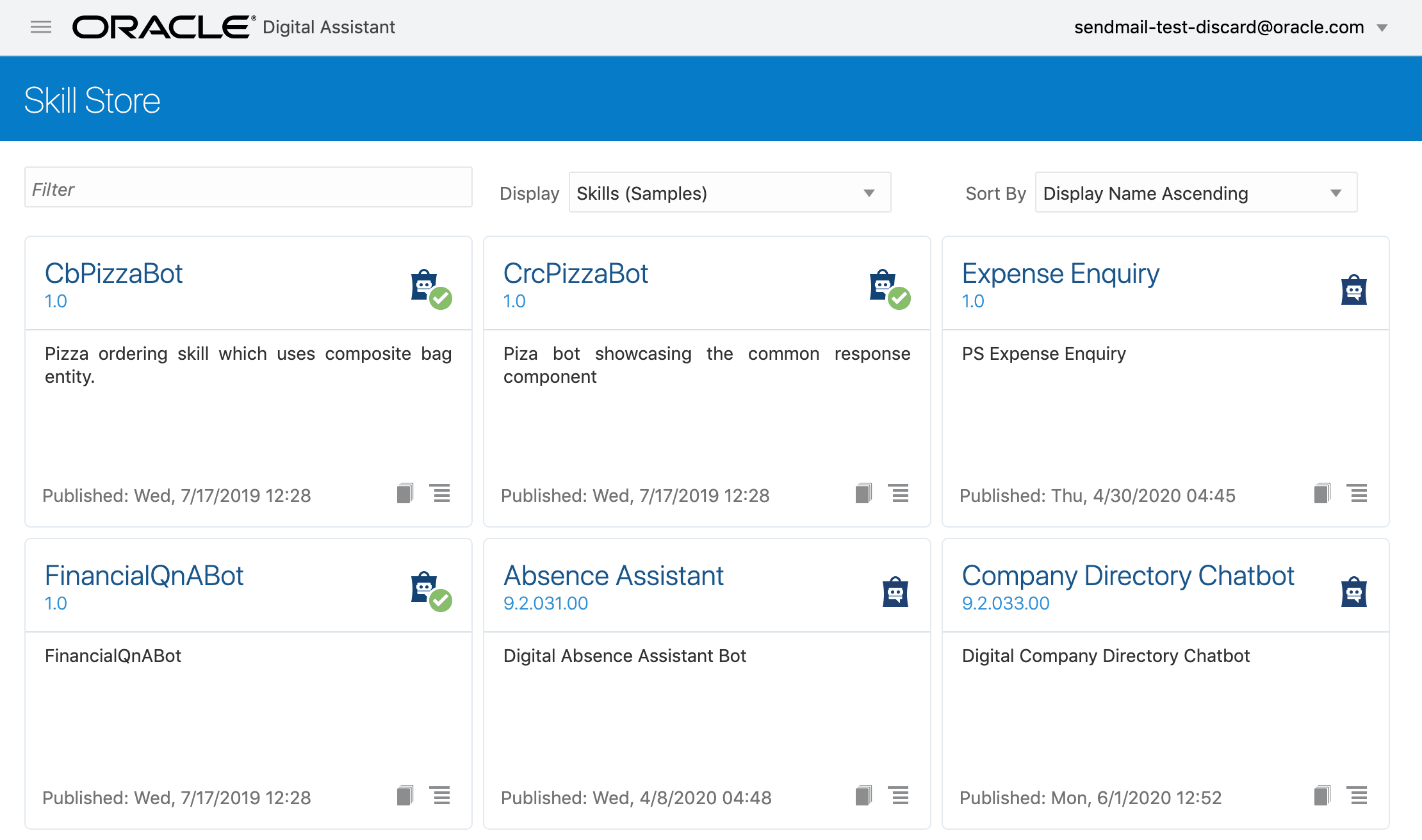

A typical Skill Store page in ODA
Use the Pull/Install option to install the skill in your ODA instance.
