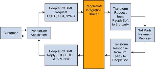

You can use PeopleSoft Integration Broker to process your PeopleSoft credit card transactions with the third-party credit card processing vendor of your choice. Oracle delivers messages and a synchronous service for you to use to set up a synchronous connection with your third-party vendor. Because each third-party vendor requires a different format for communication, PeopleSoft applications do not deliver transformations to your third-party vendor. This is because each third-party vendor has different requirements for inputs and outputs to their services. Therefore, part of setting up an integration involves writing your own transformation programs for the request and response message. The transformation programs are a mapping between the fields in the PeopleSoft system and the fields in your third-party vendor’s service. You also need to set up a node in the PeopleSoft application to process the response from your third-party vendor.
Oracle delivers XML messages for use with XML-based credit card processing vendors. You must build your own XML message transformation into the format that the vendor is expecting.
You can use PeopleSoft Application Engine to perform your transformations. You use the delivered EOEC_CCI_SYNC message for the request transaction and the delivered EOEC_CCI_RESPONSE message for the response transaction. The messages are detailed later in this section.
Note: If you have upgraded from a PeopleTools 8.47 or earlier release, the upgrade program creates service operations for these messages. The service operation names and message names are the same.
The diagram shows the process flow for integration with a third-party credit processing vendor.
