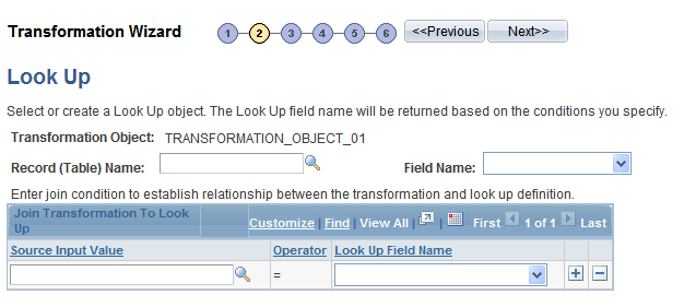

Use the Transformation Wizard - Look Up page (EOEW_TRN_DFN_LU) to enter a join condition to establish a relationship between this transformation and the look up definition.
Navigation:
Click the Next button on the Transformation Wizard - Transformation Definition page.
Click the Transformation Wizard - Look Up page number on the Transformation Wizard navigation tool.
This example illustrates the fields and controls on the Transformation Wizard - Look Up page. You can find definitions for the fields and controls later on this page.
Field or Control |
Description |
Record (Table) Name |
Select a record for the intermediary look up table. Note: This table must exist in the local PeopleSoft database. |
Field Name |
Select the value to be returned from the transformation and inserted into the target field. The available values are based on the record name that you selected. |
Join Transformation to Look Up
Field or Control |
Description |
Source Input Value |
Select the source fields that are required for the join. |
Look Up Field Name |
Associate a look up field name value with a source input value to complete the join condition. |

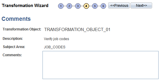

Use the Transformation Wizard - Comments page (EOEW_TRN_DFN_COM) to enter addition information about this transformation.
Navigation:
Click the Next button on the Transformation Wizard - Edit page.
Click the Transformation Wizard - Comments page number on the Transformation Wizard navigation tool.
This example illustrates the fields and controls on the Transformation Wizard - Comments page. You can find definitions for the fields and controls later on this page.
Use the Comments field to enter commentary specific to this transformation. Try to thoroughly describe this edit to help others reuse it.

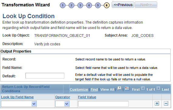

Use the Transformation Wizard - Look Up Condition page (EOEW_TRN_DFN_LUC) to enter look up transformation definition properties..
Navigation:
Click the Next button on the Transformation Wizard - Source Condition page.
Click the Transformation Wizard - Lookup Condition page number on the Transformation Wizard navigation tool.
This example illustrates the fields and controls on the Transformation Wizard - Look Up Condition page. You can find definitions for the fields and controls later on this page.
Field or Control |
Description |
Record and Field |
Displays the record and field to be used to return a value. |
Default |
Enter the value for the target field if the look up fails or returns a null value. |
Return Look Up Record Field Conditions Grid
The look up condition further qualifies the look up table data that is used for this transformation. You can enter additional criteria to restrict the rows of the look up table that are used in the join to the look up table. The target field is populated based on the look up values that are provided.
