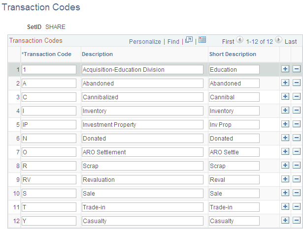

Use the Transaction Codes page (TRANSACTION_CODE) to review or modify the transaction codes.
Navigation:
This example illustrates the fields and controls on the Transaction Codes page. You can find definitions for the fields and controls later on this page.
Field or Control |
Description |
Transaction Code |
Enter a transaction code that identifies special asset transactions and that are used in combination with actions to create accounting entries. You can modify these codes by changing the description and short description. The transaction code associated with revaluation displays revaluation related distribution types for additions. |
When you define accounting entry options for a book, you can choose to distribute by disposal code. If you choose this option, the disposal code appears by default as the transaction code. In this case, you must use the transaction codes from the delivered TableSet defined for the tubbiest that you are using. You must also define corresponding accounting entry templates.
Note: The standard transactions are predefined and delivered with PeopleSoft Asset Management. To modify the transaction types, use the Asset Management (INSTALLATION_AM) page of the Installation Options (INSTALLATION) component.

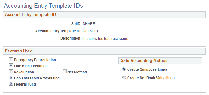

Use the Accounting Entry Template IDs page (AMAE_TMPL_ID_PNL) to create a template ID with options for depreciation features and distribution methods.
Navigation:
This example illustrates the fields and controls on the Accounting Entry Template IDs page. You can find definitions for the fields and controls later on this page.
Field or Control |
Description |
(FRA) Derogatory Depreciation |
Select to accumulate derogatory depreciation. Used in France, derogatory depreciation represents the difference between two methods of depreciation (usually straight-line versus declining balance) applied to the same asset, where one method best reflects the economic depreciation and the other is used for tax reporting purposes. |
(USA) Like Kind Exchange |
Select to accumulate like kind exchange in support of the US 1031 Like-Kind Exchange guidelines issued by the Internal Revenue Service (IRS). Note: Selecting this check box results in unrecognized gain and loss. |
Revaluation |
Select to accumulate differences derived from revaluation of tangible fixed assets and financial assets. This option not available if you have not selected the revaluation option on the Installation Options — Asset Management page. |
(AUS) Net Method |
When processing Australian net method revaluation, select this option to prevent the generation of Provision for Revaluation Contra (RC) accounting lines as a result of revaluation. When selected, the Run Depreciation Close Process (DEPR_CLOSE_RQST) will not create accounting line entries for rows with RC and Reversal of Depreciation (RD) distribution types, and DPR or PDP transaction types. |
Book Code |
Select this check box to apply book code to this accounting entry template ID. If it is not applicable, all generated entries will be created with no Book Code and all entries will post to General Ledger. If it is applicable, the book code functionality will be applied either for every book or none of them in the same ledger group by default. This field appears only if the Book Code feature is enabled at the system level within overall Installation Options. |
Cap Threshold Processing (capitalization threshold processing) |
Select to enable capitalization threshold processing at the accounting entry template ID level. This option appears only when the Capitalization Threshold feature is enabled at the system level within Installation Options. See Defining Capitalization Threshold Processing |
Federal Fund |
Select this check box to enable Federal funds transfer distribution types on the Accounting Entry Templates page. |
Create Gain/Loss Lines |
Select this distribution method to distribute the accounting entries created by the template to gain and loss totals. There are two general methods of registering a fixed asset's sales. Create Gain/Loss Lines is used to reflect in only one account the gain or loss that the sale transaction represents for the company. |
Create Net Book Value lines |
Select this distribution method to distribute the accounting entries created by the template to net book value totals. There are two general methods of registering a fixed asset's sales. Create Net Book Value lines is used to reflect the proceeds of the sale in one account and the cost of sold asset in the other account. The PeopleSoft system provides the flexibility to generate entries for the wanted method. |
Note: When setting up a new template or changing a template ID on a template that previously used either Gain/Loss or Net Book Value distribution, you may see a warning that the previous templates will be deleted. You have the option to go back and update the template instead.

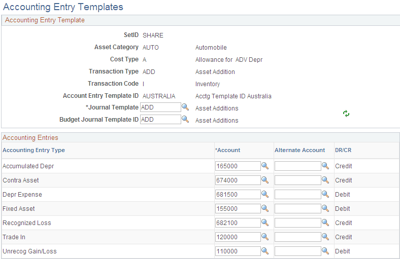

Use the Accounting Entry Templates page (DIST_TEMPLATE_DEFN) to add or modify accounting entry templates.
Navigation:
This example illustrates the fields and controls on the Accounting Entry Templates page. You can find definitions for the fields and controls later on this page.
Set up an accounting entry template for each possible combination of:
Asset category.
Cost type.
Transaction type.
Transaction code.
Accounting entry template ID.
Note: If you enter an asset into your system by using a combination of these values for which no accounting entry template exists, your accounting entry process fails when you next attempt to run it.
For each accounting entry type, select:
Field or Control |
Description |
Journal Template |
For recording actual transactions. |
Budget Journal Template |
For recording budget transactions. |
Accounting Entries |
Select the appropriate accounts and alternative accounts to be associated with each accounting entry type. If Book Code functionality is set up at Accounting Entry Template IDs level, the Accounting Entry Templates page displays the Book Code related to that account. |
Click the refresh button to update the display after you enter changes. |
Accounting Entry Types
Accounting entry types are set by the system. Each asset event has an associated set of accounting entry types.
For each possible combination of category, cost type, and transaction code, you must set up an accounting entry template for each of the following transaction types:
ACR: Accretion Expense.
ADD: Additions.
ADJ: Adjustments.
TRF: Transfers.
RCT: Recategorizations.
DPR: Depreciation expenses.
PDP: Prior period depreciation.
Note: The DPR and PDP transaction types are used only on an accounting entry template with a blank transaction code.
PLP: Prior Lease Payment.
RET: Retirements (also used for processing reinstatements).
LPY: Lease payments.
INF: Inflation adjustment.
LEX: Lease Expense.
Book Code
Specify a book code for each account value.
The Allow Book Code Override option that is set on the Account (ACCOUNT) page determines whether this book code can be overridden on the transaction line. The Effective Date and Status fields on the Account page must match the settings for the account values to which the book code is attached. Assets take the most recent and active date to populate its templates. To avoid any situation where Book Code might generate unbalanced entries in General Ledger, a warning message is generated when the template is saved when there are paired distribution types with different Book Codes. Paired distribution types are those distribution types that play against other in order to balance the entry.

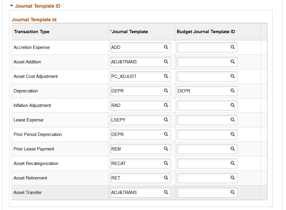

Journal Template ID |
(AM_JRNL_TMPL_SBP, RUN_AMAEMASS_02) Select journal and budget journal templates for each type of transaction (add, adjust, and so forth). |

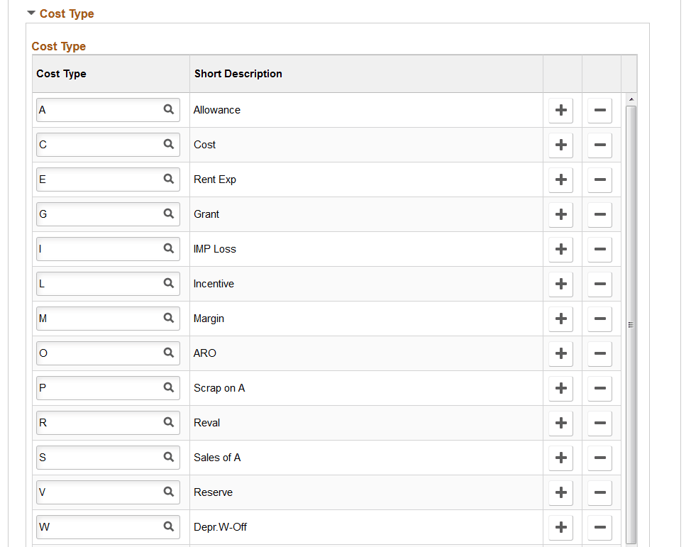

Cost Type |
(AM_COST_TYPE_SBP, RUN_AMAEMASS_03) Select cost types for which templates should be generated (cost, margin, revaluation, and so forth). If cost types are not used, leave this field blank. |

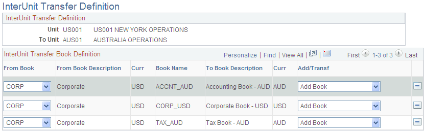

Use the InterUnit Transfer Definition page (IU_TRF_DEFN_TBL) to set up an InterUnit transfer definition.
Navigation:
This example illustrates the fields and controls on the InterUnit Transfer Definition page. You can find definitions for the fields and controls later on this page.
To begin, from the search dialog page, select the books used by the To Business Unit business unit.
Field or Control |
Description |
From Book |
Enter the book whose information you want to enter into the To Book. Then select the action that you want to use: Transfer or Add book. Usually you use the transfer action. |
InterUnit transfer definitions act as templates to simplify performing InterUnit transfers.
InterUnit transfer definitions tell the system which books exist for the transfer from and transfer to business units, and what type of transactions the InterUnit transfer should generate for each book. If you are planning to perform many InterUnit transfers, it helps to first define all the possible InterUnit transfers.
For example, if you have three business units, US001, US002, and US003, and you expect to perform all possible InterUnit transfers, you would set up these six InterUnit transfer definitions:

Using a From Book for Two or More Transfers
When a From Book is used for two or more transfer book actions, only one transfer out transaction is generated. Because this takes care of the cost on the From Book, no additional transfer outs are generated for that book.
Assets that are transferred between books by using the transfer book action receive a status of Transferred:
From Book |
From Trans |
To Book |
To Trans |
Action |
CORPORATE |
Transfer Out |
CORPORATE |
Transfer In |
Transfer Book |
CORPORATE |
LOCAL |
Transfer In |
Transfer Book |
Using a From Book for Both Transfer and Add
When a From Book is used for both a transfer and an add action, a transfer out is generated for the Transfer Book. Because this takes care of the cost on the From Book, the add action does not generate a retirement for that book.
From Book |
From Trans |
To Book |
To Trans |
Action |
CORPORATE |
Transfer Out |
CORPORATE |
Transfer In |
Transfer Book |
CORPORATE |
LOCAL |
Add |
Add Book |
Using a From Book for Two or More Adds
When a From Book is used for two or more add actions, a retirement is generated for the first add action. Because this takes care of the cost on the From Book, no further retirements are generated for it.
The asset that was retired receives a status of Disposed:
From Book |
From Trans |
To Book |
To Trans |
Action |
CORPORATE |
Retire |
CORPORATE |
Add |
Add Book |
CORPORATE |
LOCAL |
Add |
Add Book |
Note: When you transfer from a business unit with three books to a business unit with two books, the cost information on the extra From Book is automatically retired. You do not need to enter an action.
See Understanding Adjusting, Transferring, Reversing, and Evaluating Assets.
Retiring a Book
Assets that are retired receive a status of Disposed:
From Book |
From Trans |
To Book |
To Trans |
Action |
CORPORATE |
Transfer Out |
CORPORATE |
Transfer In |
Transfer Book |
LOCAL |
Transfer Out |
LOCAL |
Transfer In |
Transfer Book |
FEDERAL |
Retire |
