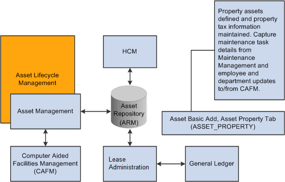

The following diagram displays the process flow for Lease Administration integration:
Process flow for Lease Administration integration.
Asset Management shares the asset repository with Lease Administration. The asset repository integrates with a third-party computer aided facilities management (CAFM), sending space allocation information for defined property assets as well as employee and department information. In turn, the CAFM application passes updated space allocation information for existing assets as well as new "sub" assets, such as floor, space, and area, with the measurements from the CAFM application, and the employee assignments to the "sub" assets, back to the PeopleSoft application.
The asset repository supports integration with Lease Administration by enabling asset property records (ASSET_PROPERTY) to have asset components. A one-to-one relationship exists between an asset and the asset property. During asset creation, when the asset type Property is selected, the Property Information tab is enabled. Information relating to the property asset as well as property tax information is stored here.
Note: Defining an asset as property is available only from the Asset Basic Add component.
The integration has the following impacts on the asset repository:
Nonstructural assets are assigned to properties as a component of the property asset, and the property asset includes a defined location.
The assignment of nonstructural assets to structural assets is done through the Component Of ID field in the asset table. A nonstructural asset will have its component of ID set to the asset ID of a structural asset. In this way, the nonstructural asset is located at that property. The component of ID has only one key, the ASSET_ID. The system assumes that nonstructural assets belong to the same business unit that owns the property. When you are integrating with CAFM solutions, only structural assets are supported.
The asset repository requires that the property asset definition also include an associated employee or asset custodian.
The asset custodian (ASSET_CUSTODIAN) is a child table of the asset table and allows an N-1 relationship between employees (custodians) and the assets. When you are exchanging information with CAFM, new employee information linked to a property updates the asset custodian table.
To support these functions, the following rules apply:
You can view the allocation basis from the (RE_ALLC_BASIS_VW) page in Lease Administration.
Use the allocation feature in General Ledger to set up your own allocation process using this view as the basis. The allocation basis record is populated in the following way:
The statistics code and statistical account comes from the fields defined for the asset property business unit.
The statistics amount comes from the sum of the total area of all properties using the same statistical account.
If an employee is the custodian of the property, the employee ID, business unit, and department ID are derived from the employee tables defined in HCM. If a property does not have an employee associated as a custodian, then the department ID of the asset custodian is used.
When an employee moves out of a space, the employee ID that is defined in the asset custodian table is cleared, and the department ID of the first parent property that has a department ID assigned to it is used for the current property.
If none of the parent properties have a department ID, it is left blank.
When you are viewing the general ledger allocations, the view itself is the current value of the department space usages.
You can use the Space Allocation report to search over this view.

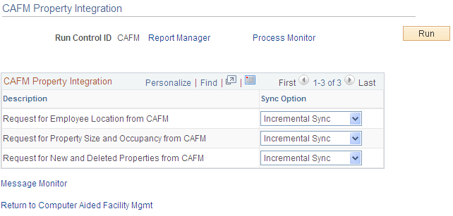

Use the CAFM Property Integration page (RE_REQ_SYNC_RUN) to .
Navigation:
This example illustrates the fields and controls on the CAFM Property Integration page. You can find definitions for the fields and controls later on this page.
Each process name to be run and its description is displayed.
Field or Control |
Description |
Sync Option |
Select the integration broker message type to use. The options are:
When you run the process, the requested CAFM data updates the following PeopleSoft tables:
ASSET
ASSET_CUSTODIAN
ASSET_LOCATION
ASSET_PROPERTY
ASSET_ACQ_DET

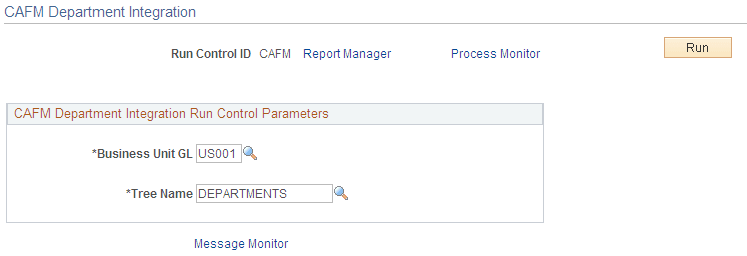

Use the CAFM Department Integration page (RE_PUB_DEPT_RUN) to exchange department information with the CAFM application using the RE_PUB_DEPT process: This application engine process is a Full Sync of Department Tree that transfers the department tree specified for the selected business unit to CAFM so that their system understands the general departmental breakdown.
With that information, the CAFM system can properly assign custodians to property assets and employees to spaces. CAFM cannot modify department data, because the FSCM tables are considered the master data.
Navigation:
This example illustrates the fields and controls on the CAFM Department Integration page. You can find definitions for the fields and controls later on this page.
Field or Control |
Description |
Business Unit GL |
Select the associated GL business unit from which employees are selected to exchange information. |
Tree Name |
Select the appropriate Department tree from which employees selected are to exchange information. Note: If you select a tree other than Department, the process will fail. |
