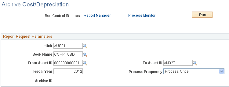

Use the Archive Cost/Depreciation page (RUN_ARCHIVE) to run the Asset Archive process (AMDPARCH) to archive inactive cost and depreciation data.
Navigation:
Asset Management, Asset Transactions, History, Archive Cost/Depreciation, Archive Cost/Depreciation
This example illustrates the fields and controls on the Archive Cost/Depreciation page. You can find definitions for the fields and controls later on this page.
Field or Control |
Description |
Unit |
Select the business unit from which records will be archived. |
Book Name |
You must archive an asset using each book it is associated with. |
From Asset ID and To Asset ID |
Use these fields to archive a range of asset IDs. To archive one asset, enter the asset ID in the From Asset field. |
Fiscal Year |
By default, the process will archive data up to the last period of the fiscal year you enter here. The fiscal year must be closed before an asset can be archived. |
Archive ID |
When you run the process, the system populates this field with the run control ID and stores the archive ID in the ARCHIVE_NO field on the depreciation table. You must keep a record of this archive ID if you want to restore archived data. |
