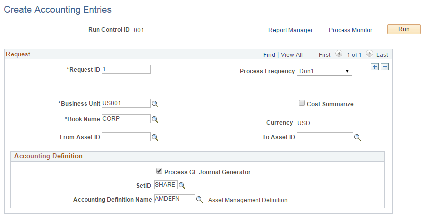

Use the Create Accounting Entries page (AM_AMAEDIST_RQST) to set up and initiate a request or set of requests for accounting entry creation.
Navigation:
This example illustrates the fields and controls on the Create Accounting Entries page. You can find definitions for the fields and controls later on this page.
Field or Control |
Description |
Cost Summarize |
Select to create cost summary while creating accounting entries. |
From Asset ID and To Asset ID |
Enter the transaction range to process. |
Process GL Journal Generator |
Select this option to enable the Journal Generator process (FS_JGEN) to run automatically once the Create Accounting Entries process (AM_AMAEDIST) completes. |
SetID |
Enter a setID for the Journal Generator process. |
Accounting Definition Name |
Enter an accounting definition name for the Journal Generator process. |
Note: The system calls the Inter/IntraUnit central processor to create balanced accounting entries.

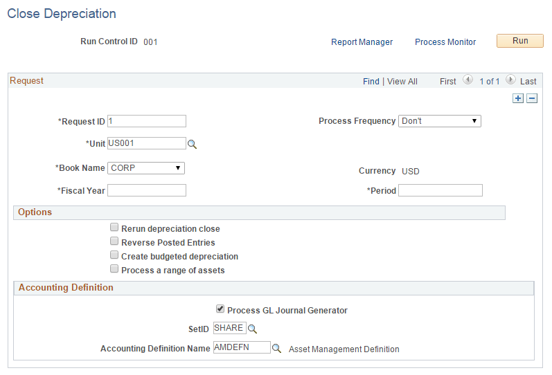

Use the Close Depreciation page (DEPR_CLOSE_RQST) to enter and initiate a depreciation close request or requests.
Navigation:
This example illustrates the fields and controls on the Close Depreciation page. You can find definitions for the fields and controls later on this page.
Field or Control |
Description |
Fiscal Year and Period |
Enter the appropriate fiscal year and open periods to be closed. |
Rerun Depreciation Close |
Select to delete all existing accounting entries that haven't been generated as journal entries for depreciation expense and lease obligations for the specified business unit, book, fiscal year, and period. The system generates new entries. To generate new journal entries and to reverse a journal entry, run a request with both Rerun Depreciation Close and Reverse Posted Entries options selected. To rerun depreciation close for budgeted depreciation, run a request with both Rerun Depreciation Close and Create Budgeted Depreciation options selected. |
Reverse Posted Entries |
Select to reverse only those accounting entries that have been created and posted to the general ledger, including all existing accounting entries for depreciation expense and lease payments for the specified business unit, book, fiscal year, and period. The process creates reversal entries and marks the old entries with a status of Reversed. If journal entries have not been created, the entries marked Reversed are not used by the Journal Generator process. To reverse entries that are created and post them again, use Reverse Posted Entries in tandem with Rerun Depreciation Close. When you do this, the original journal entry is reversed and a new entry is created. When an entry has not been posted to the general ledger, use the rerun option. Reverse Posted Entries does not reverse unposted entries. |
Create budgeted Depreciation |
Displays the resulting accounting entries as budgeted depreciation and lease payments. These entries are posted to the budget ledger that is specified in the Business Unit Book options page when you run the Journal Generator process. |
Process a range of assets |
Select to process a specific range of assets for a business unit, book, fiscal year, and period. Use this option to split up a large volume of assets for a particular business unit and book. Because the program AM_DPCLOSE commits its work after each request, selecting this option accelerates the process. You can also use this selection with the parallel option to take advantage of servers that have parallel processors. This speeds up processing for large volumes of data. For example, to increase throughput when creating depreciation accounting entries for 1,000,000 assets, you can enter 10 requests to process 100,000 assets each. Select Process in Parallel, and assign a processing sequence number to each process request. Processing sequence numbers must be unique. Use care when specifying From asset ID and To asset ID processing parameters, as these parameters are inclusive. Overlapping can occur, and no edit is available to verify that you have set up inclusive asset ranges. For example, suppose that request 1 is processed from asset ID 0001 and to asset ID 0005. If request 2 is processed from asset ID 0005 and to asset ID 9999, asset 0005 is processed twice. You can use Query to verify ranges by counting the number of assets in total and number of assets per range. |
Select this option to enable the Journal Generator process (FS_JGEN) to run automatically once the Close Depreciation process (AM_DPCLOSE) completes. |
SetID |
Note: If you use the interface between PeopleSoft Asset Management and PeopleSoft Billing, accounting entries are created by these integrated transactions. How the entries are created is described in more detail in the PeopleSoft Billing documentation.
See Understanding How PeopleSoft Asset Management Integrates with Other Applications.
See Understanding Asset Management Business and Cash Generating Units.
See Understanding General Ledger Journal Entries.
See Understanding PeopleSoft Billing and Asset Management Integration.

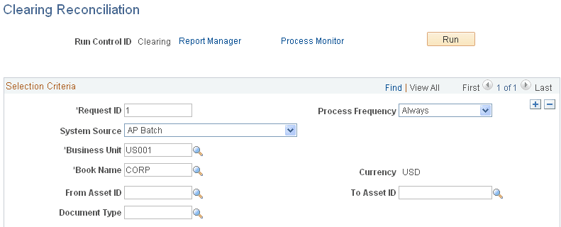

Use the Clearing Reconciliation page (AM_CLEREC_RQST) to run the process to reconcile the clearing account that is created by trackable assets from feeder systems against the expense account.
Navigation:
This example illustrates the fields and controls on the Clearing Reconciliation page. You can find definitions for the fields and controls later on this page.
PeopleSoft Asset Management provides an optional Capitalization Threshold feature that, once enabled, can automatically determine capitalization status of an asset, by profile, based on its cost or quantity according to limits that you define. The system classifies assets as capital, non capital, or expense. The Clearing Reconciliation process (AM_CLEREC) provides a way to reconcile accounting entries for expensed assets.
See Capitalization Thresholds Page.
When assets came from other sources, a debit is usually recorded to a fixed asset account and a clearing account is credited that was previously debited in the source system. When an asset is deemed trackable because of the specified threshold, the asset ID is generated but no accounting activities take place. This reconciliation process provides a way to balance out the clearing account that was debited in the source system and debit the expense account instead. This is not applicable to expensed (trackable) assets that are entered directly in Asset Management with no clearing account.
Enter the parameters and run the process. The system searches non capital assets for the specified parameters in the acquisition detail. For each non capital row that matches the system source, the following entry is generated in the DIST_LN table:
Debit |
Credit |
Distribution Type |
Expense Account |
EX |
Clearing Account |
AP |
