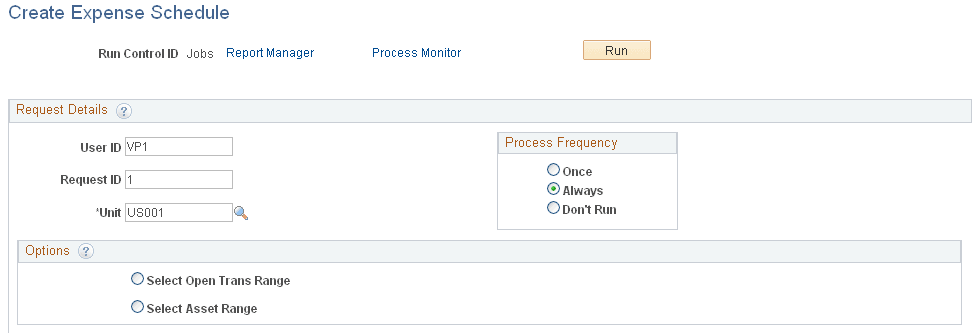

Use the Lease Expense Schedule page (LEASE_SCHED2_RQST) to run the lease expense schedule process.
Navigation:
This example illustrates the fields and controls on the Create Expense Schedule page. You can find definitions for the fields and controls later on this page.
Field or Control |
Description |
Select Open Trans Range (select open transaction range) |
If you select this option, use the From Open Trans and To Open Trans fields to select a range of transaction values. |
Select Asset Range |
If you select this option, use the From Asset and To Asset fields to select the asset range. |
