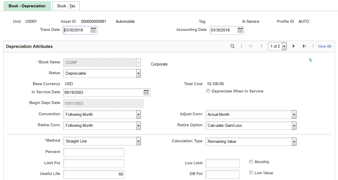

Use the Book - Depreciation page (ASSET_BOOK_01) to identify the asset's books and some of the information needed for calculating depreciation.
An asset can be linked to any number of books. Typically, separate books are required for financial and tax purposes.
Navigation:
This example illustrates the fields and controls on the Book - Depreciation page. You can find definitions for the fields and controls later on this page.

In Service Date |
Enter the date that the asset was made available for use from a financial standpoint. This date and the depreciation convention determine when depreciation starts for this book. This date is reflected in the Begin Depr Date field. |
Depreciate When In Service |
Select to allocate annual depreciation as of the date that you placed the asset in service. If you do not select this option, PeopleSoft Asset Management allocates annual distribution as of the date determined by the depreciation convention. This option is valid only in the year that the asset was acquired. |
Convention |
Enter the convention that the system uses to prorate depreciation for the asset. Asset Management is delivered with most standard depreciation conventions set up in the Depreciation Conventions table. The system derives the beginning depreciation date from the convention and the placed-in-service date. For example, if you began using an asset on May 3, 2006, and selected Actual Month as the depreciation convention, PeopleSoft Asset Management would begin depreciating this asset on May 1, 2006. If you selected Following Month as the convention, depreciation would begin on June 1, 2006. |
Adjust Convention |
Enter the adjustment convention that the system uses to prorate cost adjustments for the asset. |
Retirement Convention |
Enter the retirement convention that the system uses to prorate retirement for the asset. |
Retire Option |
Select the retirement calculation option to be processed for assets within a given book. These retirement options are available at the profile, book and asset levels. See Retire Assets Page. |
Select a depreciation method in the Depreciation Method field. Some depreciation methods require you to enter additional information. Depending on the method that you select, additional fields will display as needed, and as described in the following table:

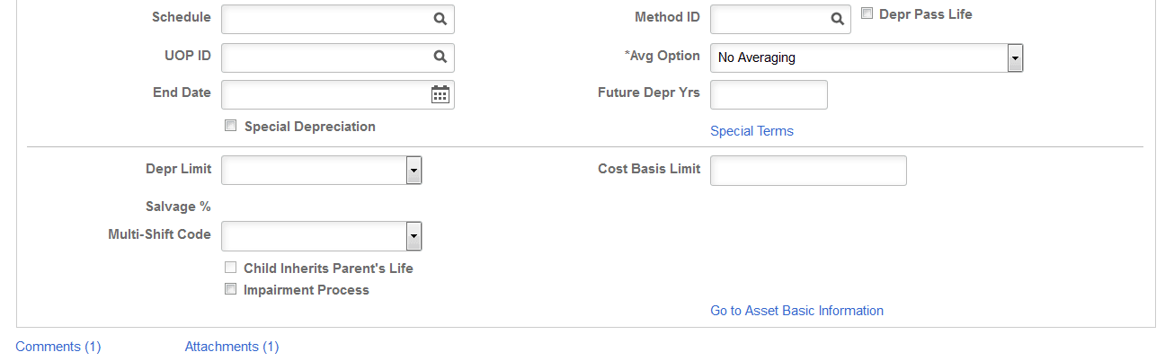

Useful Life |
Enter the number of periods. This is used to perform the depreciation calculations for the financial books. |
End Depr Date (end depreciation date) |
Enter a value to have depreciation end at a particular time. At the ending depreciation date, the remaining asset basis is taken in depreciation and the asset is fully reserved. |
Future Depr Yrs (future depreciation years) |
Asset Management calculates and stores depreciation until the end of the asset's life. However, for optimal processing performance and greater table efficiency, you can specify a fixed number of years for which depreciation is calculated and stored. Note: It is strongly recommended that you use the Future Depreciation Years option for group assets and for a large number of assets. |
Special Depreciation or Special Terms |
If you are working in a global environment and want to use special depreciation terms to meet specific country requirements, select the Special Depreciationcheck box and click Special Terms to open the Depreciation Method Information page, where you can select global attributes for depreciation. |
Depr Limit (depreciation limit code) |
Depreciation limits generally apply to tax books, but they can also be used for financial books. The tableset delivered with Asset Management contains depreciation limits currently dictated by the U.S. Internal Revenue Service for luxury automobiles. |
Cost Basis Limit |
Enter the limit on the depreciable basis of this asset. If the actual cost of an asset is greater than its depreciable basis, the difference produces a gain when the asset is retired. |
Salvage % (salvage percentage) and Salvage Value |
Enter the residual value of the asset subtracted from the cost to determine the depreciable basis used in depreciation calculations. You can enter it either as a flat rate or as a salvage percentage (a percentage of the asset's total cost). If you use a salvage percentage, the system recalculates the salvage value as you add additional costs for the asset. |
(DEU) Multi-Shift Code |
Enter rates by which depreciation should be increased based on the number of production shifts an asset is used. |
Threshold ID |
If you want to modify an existing asset to use the capitalization threshold by book method, select the Threshold ID to use as the default value for assets within the selected book. This field is available for editing only when:
Child Inherits Parent's Life |
Select if the child asset inherits the parents remaining life. When you use parent-child component assets, all child assets have their own cost basis and depreciation attributes that are independent of the parent asset. Because the child's asset life may differ from the life of the parent asset, you may need to specify that a new child asset of a parent asset inherit the remaining life of the parent asset. |
Impairment Process |
Select to make an asset available for impairment processing. |
Comments |
Click the Comments link to access the Book Depreciation - Comments page and view or add relevant supporting comments to an asset transaction. |
Attachments |
Click the Attachments link to access the Book Depreciation - Attachments page and view or add relevant supporting documents to an asset transaction. |

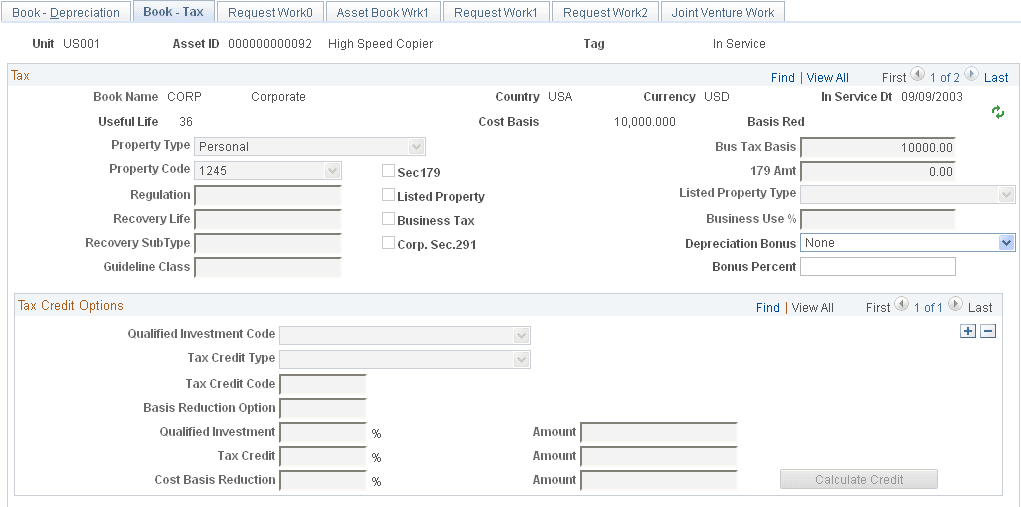

Use the Book - Tax page (ASSET_BOOK_02) to specify property type, tax depreciation criteria, and tax credit options.
If the fields on this page are not available, the book was not set up as a tax book on the Business Unit/Book Definition page.
Navigation:
This example illustrates the fields and controls on the Book - Tax page. You can find definitions for the fields and controls later on this page.
Tax
Field or Control |
Description |
Property Type and Property Code |
These fields determine the amount of gain treated as ordinary income upon the disposition of the asset. |
Regulation |
Regulation is an indication of the tax system that you elect. Each tax system has an effective date that is validated against the asset's placed-in-service date. Select a regulation to identify the depreciation system elected for this asset. Options are:
Recovery Life and Recovery SubType |
For reporting purposes, you can further classify the asset by specifying the recovery life (expressed in years) and the recovery subtype. For example, the code for a 15-year life might be 15 and the code for low-income housing might be LI. |
Guideline Class |
All current U.S. classifications are set up in the Tax Class table in the delivered tableset |
Section 179 |
You can elect to recover all or part of the cost of certain qualifying property, up to a limit, by deducting it in the year you place the property in service. You can elect the section 179 deduction instead of recovering the cost by taking depreciation deductions. |
Listed Property |
Select the Listed Property check box to define the asset as listed property and select its Listed Property Type. Listed properties are certain kinds of assets that are conducive to mixed business and personal use, such as:
(FRA) Business Tax |
Select to indicate that the business tax is applicable. This option enables you to calculate and report a business tax assessed on the gross value of fixed assets. This is a requirement in some countries. |
Corp. Sec. 291 (corporation section 291) |
Select if the organization is a corporation. This check box must be selected if the company is a corporation in order for the Tax Retirement Capital Gains report (AMTX3210) to accurately reflect the correct Sec. 1231/Ordinary gains. |
(USA) Depreciation Bonus |
Select to indicate the specific depreciation bonus definition if the asset qualifies for depreciation bonus treatment. For descriptions of the PeopleSoft delivered field options: See PeopleSoft Asset Lifecycle Management Fundamentals, Establishing Asset Processing, Specifying Tax Attributes in a Profile. You can also define your own depreciation bonus options for selection in this field using the Depreciation Bonus Info page. See PeopleSoft Asset Lifecycle Management Fundamentals, Setting Up Depreciation Processing, Setting Up Depreciation Bonus Information |
(USA) Bonus Percent |
Enter the percent amount of the depreciation bonus to be applied to the books for this profile. The amount depends on the legislation provisions for bonus amount, acquisition date and in-service date of the asset as well as state or local application of the depreciation allowance. |
Tax Credits Options
The rate and amount of the tax credit are based on federal tax law and determined by the qualified investment code, tax credit type, tax credit code, and the basis reduction option in Asset Management.
Field or Control |
Description |
Basis Red (basis reduction) |
Displays the total reduction of the cost basis, if any. The total reduction amount is updated each time that you change tax credit information. |
Qualified Investment Code |
Corresponds to the option you enter in the Tax field. |
Tax Credit Type |
Although the investment tax credit was essentially repealed on December 31, 1985, certain business incentive credits can still be taken. Currently, you can specify the following credits:
Tax Credit Code |
Enter a value in this field to further define the tax credit—for example, a 20 percent rehabilitation tax credit is available for certified historic buildings. |
Basis Reduction Option |
Some credits require a corresponding reduction in the asset's cost basis. In this field, specify whether the basis needs to be reduced. Options are:
Asset Management calculates the percentage and computation amount based on the following calculations:
