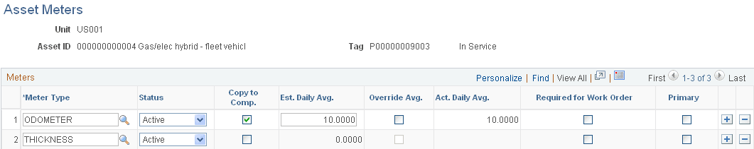

Use the Asset Meters page (ASSET_METER) to define asset meter by assigning meter types and associate the meter to assets.
Navigation:
This example illustrates the fields and controls on the Asset Meters. You can find definitions for the fields and controls later on this page.
Field or Control |
Description |
Meter Type |
Select the meter type to be associated to this asset. |
Copy to Comp. (copy to component) |
Select if this meter should also be associated with any asset components associated with this asset (optional). This enables the component asset to use the same meter reading variations entered for its higher-level component assets. The meter reading inheritance rules are as follows:
Est. Daily Avg. (estimated daily average) |
Displays the estimated average based on the actual readings taken when the number of readings specified to calculate the daily average has not been reached. The field is available when the meter type is enabled to maintain daily average. Estimated daily average is always a positive value. |
Override Avg. (override average) |
Select to override the actual daily average. The field is available when the meter type is enabled to override the actual daily average. |
Act. Daily Avg. (actual daily average) |
Displays the system-calculated actual daily average. It can be zero or greater than zero. You can edit the value if the Override Avg. option is selected, but a new average is calculated when a new meter reading is entered. The field is available when the Maintain Average option is enabled for the meter type. |
Required for Work Order |
Select to override a meter as required for any kind of work order as a condition to change its status to complete. This option defaults from the Meter Type Definition page and can be overridden here on the Asset Meters page. This field displays only if PeopleSoft Maintenance Management is installed. |
Primary |
Designate the primary meter type for the asset. This is used in the Asset Maintenance Cost Analysis online component in PeopleSoft Maintenance Management. |

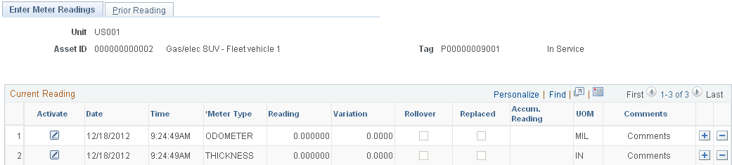

Use the Enter Meter Readings page (AM_METER_READ1) to enter meter readings for an asset.
Navigation:
This example illustrates the fields and controls on the Enter Meter Readings page. You can find definitions for the fields and controls later on this page.
Enter current reading information in the work area.
Field or Control |
Description |
Activate |
Select this check box to activate entries for the row. |
Date and Time |
Enter the date and time of the meter reading. The system current date and time displays by default. |
Meter Type |
(Required) Select a valid meter type for this asset ID. Valid meter types are those that are associated with the asset and active. |
Reading and Variation |
(Required) Record the current meter reading. Enter either the actual reading or variation from the last reading. If you had a reading of 12,000 km for an odometer and now you have 12,450 km, you can enter 450 in the variation field or 12,450 km in the Reading field above. The system automatically calculates the value for one field based on the entry made to the other field. The variation is used for the Copy to Components function. Variation is validated so that the reading does not fall outside the low and high limits established for the meter when the Reading field is automatically calculated. The Variation and Reading fields are both required when you have selected the Replaced option. |
Rollover |
Check this option if rollover is enabled and should only be selected when the meter surpasses the upper limit. When selected, the meter resets to zero on the Assets Meters page once this reading is saved. When the meter passes its established upper limit and begins a new cycle, the system keeps track of the accumulated usage. This applies only to increasing and decreasing meter types that also have enabled the Allow Rollover option. |
Replaced |
Select this option when the meter tool has been replaced. Both the Reading and Variation fields must be completed in this instance. This enables the system to calculate the total accumulated reading for the selected meter type. In the Reading field, enter the actual reading measured in terms of the new meter. In the Variation field, enter the difference between the last reading and the new one. These entries will be the basis to recalculate the accumulated meter reading when the page is saved. |
Accum. Reading (accumulated reading) |
The last accumulated reading displays. If the Replaced option is selected, or if this is the first reading of the asset, this field is enabled for edit. Enter the new accumulated reading or complete the Reading and Variations fields to recalculate accumulated reading. |
UOM (units of measure) |
Displays the units of measure for this type of meter. |
The following validations occur when the page is saved:
The meter type entered cannot be duplicated for the same date and time or the system generates an error message.
The reading/variation field must be completed or the system generates an error message.
The accumulated reading or variation and the reading fields must be completed when the replaced option is selected or the system generates an error message.
Readings must fall into the lower and upper limit range established at the meter type definition level or the system generates an error message.
If the meter type is increasing or decreasing and the user enters a lower or greater reading than the prior reading, the system will generate an error message.
If the meter type is increasing or decreasing and defined to allow rollover, the message warns that the rollover option must be selected before saving.
When you save the page, the meter readings entered become part of the meter history.
Using the Prior Reading tab, you can view the last entry made for the meter type. It also displays rollover or replacement activity from the prior meter reading.
You can enter comments related to a meter reading by using the Comments link.

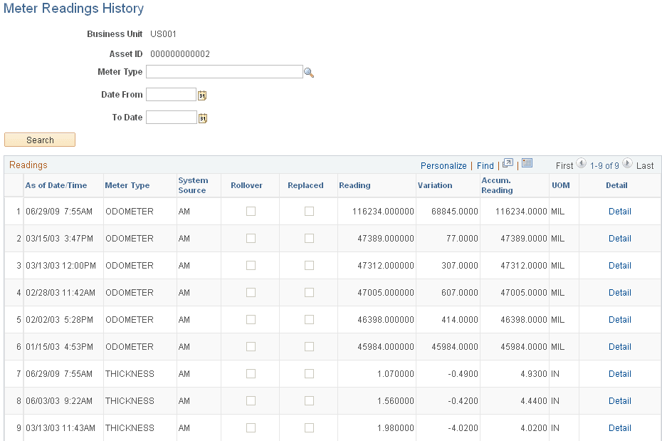

Use the Meter Readings History page (AM_MTR_RD_HIS) to view meter reading history for an asset.
Navigation:
This example illustrates the fields and controls on the Meter Readings History page. You can find definitions for the fields and controls later on this page.
Search for and review meter readings history by business unit and asset ID. You can further refine the results by entering a meter type and date range. The results display the following information.
Field or Control |
Description |
As of Date/Time |
Displays the date and time of the meter reading listed. |
Meter Type |
Displays the type of meter associated to the asset and reading. |
Rollover |
If selected, indicates that a meter rollover occurred. |
Replaced |
If selected, indicates that a replaced reading was entered, usually due to a rollover. |
Reading |
Displays the meter reading entered for the meter reading listed. |
Variation |
Displays the calculated change from the prior meter reading. |
Displays the accumulated readings. |
Displays the units of measure for the meter type. |
