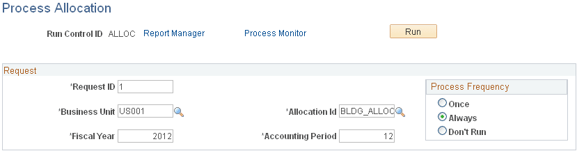

Use the Process Allocation page (AMALLOC_RQST) to create allocation entries in the DIST_LN table.
If necessary, the allocations process calls the IU Processor to create balanced entries.
Navigation:
This example illustrates the fields and controls on the Process Allocation page. You can find definitions for the fields and controls later on this page.
Enter a Business Unit, Allocation Id, and Accounting Period to process allocations. Select a Process Frequency.
When processing for budget and fund accounting allocations, first run the accounting entry generation process (AM_AMAEDIST) and the depreciation close (AM_DPCLOSE) process. Then run the Depreciation Allocation (AMALLOC) process with the appropriate budget Allocation ID for the applicable fiscal year and period. These steps will change the entries to reflect the correct budget reference in the accounting entries for assets that were created in prior fiscal year and period.
